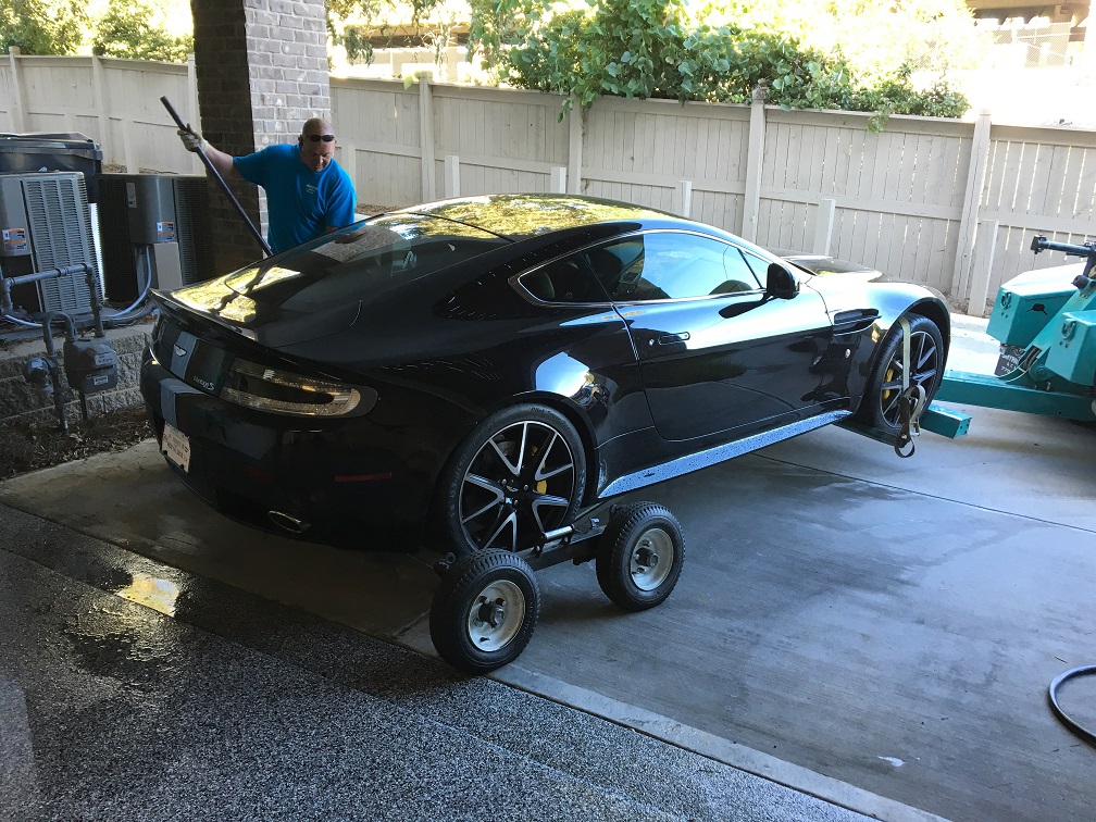

Well, that was fun. The tow truck driver was super cool and careful - he coached me through every step and came up with a solution that would not ruin my garage floors since the car was stuck in gear. It was a 2-hour process to extract the car from my garage! Basically we hosed down the floors and slid it out with a winch very carefully. Would have preferred a flatbed but that wasn't possible with the car stuck in first gear and the tight space in my driveway (I live in the city).
