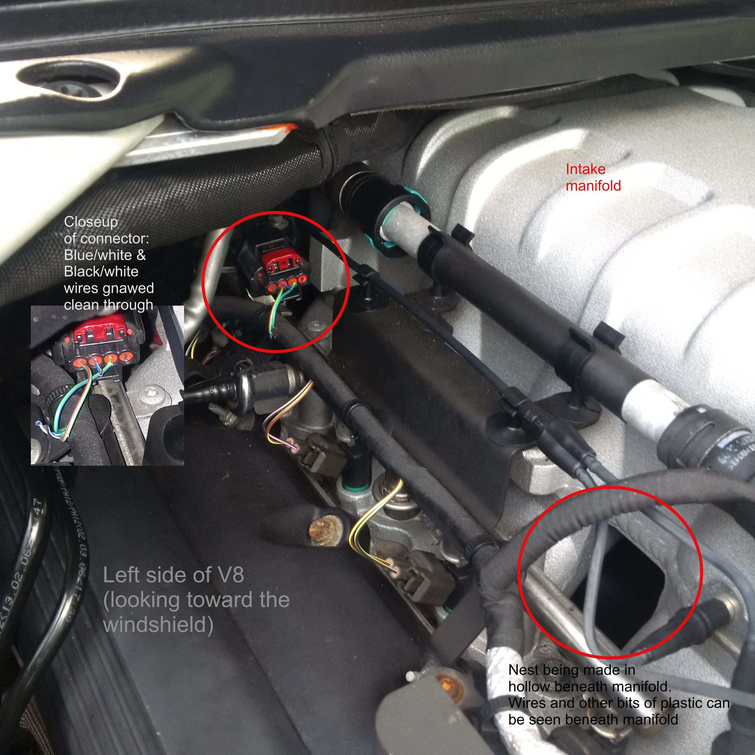

Hi Yah AM owners!!
Well I took the punge recentlyand obtained a 2006 V8V and shipped it to Jamaica. It was starting fine, but it seems on the way over, the rats to a liking to the engine bay and went dining on wires, insulation etc . Got the car, it will crank over, come to life for a brief moment, then die and just keep turning over . So after some sleuthing found a few things:
1) The dined on the wires leading to the fuel rail oressure sensor multiplug connector. Ate clean through two and one really close to the head of the connector. Now I don't fancy coughling up U$4k for an new engine loom. So does ANYONE have a used connector that I can purchase?
Name:	Damaged Connector_annotated.jpg
2) The buggers where trying to make a nest it seems under the intake manifold (lap of luxury and all that I presume) and a few wires beneath there are gnawed on. So I have to remove the intake manifoldand correct any ills and then replace. Now I didnt say there are NO AM dealers in Jamaica, so I am pretty much on my own with this repair. So my secondask: Has ANYONE done this before that can just guide me with tips and tricks while I use the workshop manual to remove. I know I will need to replace the EGR gasket, the intake gasket and o-rings for injectors (cant find these parts anywhere), but are there any other "need to knows" that only experience can bring that I need to be aware of?
3) Does anyone know a better way to remove the 96mm Herbie Clamp that keeps the air intake tube attached to the throttle body?

The Kingston Wharf is notorious!!! Been there, done that....
For starters, you should see https://www.astonmartintechinfo.com/ The manuals for the car are all available there. There's also a part's manual that you should get.
Secondly, try astonmartinbits.com They are currently showing a used engine loom for £1314.97. (I know you're not trying to purchase a loom, but I just wanted to put that out there).
Also, check scuderia parts for the connector itself. I am sure you can buy just the connector.
Anyhoo, you should be able to get this solved with the wealth of knowledge here, but you have to COME BACK and engage on an interactive basis to gather your info.

Connector pin part #418-411-11. Find a 100mm hose clamp oem style Norma brand for your intake.

This list will help you with removing the intake manifold. just a suggestion, while waiting for a loom, try cutting into the plug and soldering onto the wire stubs. That should get the car running in the interim.
Good luck

And I bought a new engine wiring loom from AMBits for my glass key conversion project. I can't post prices here, but I can say it was a mere fraction of $4K. Email John @ Astonmartinbits . com
Good stuff!!! He can simply replace the wire/pin inside the connector.

Terminal_ac: Great to know there is another Jamdowner here!! I got everything from AMtechinfo.com and its the workshop manual I will be using to guide me through the intake manifold removal and install. I was reaching out for those experience tips that dont get recorded too well in manuals. So what your poison: AM or Porsche Terminal_ac?
J doubleU: Perfect!! Thanks for the part number for the connector!! Will also looking into the hose clamps!
embdenb: Brilliant suggestion!! Will look into doing that this weekend and see if she starts up! That would certainly make my month to hear her purr!!
