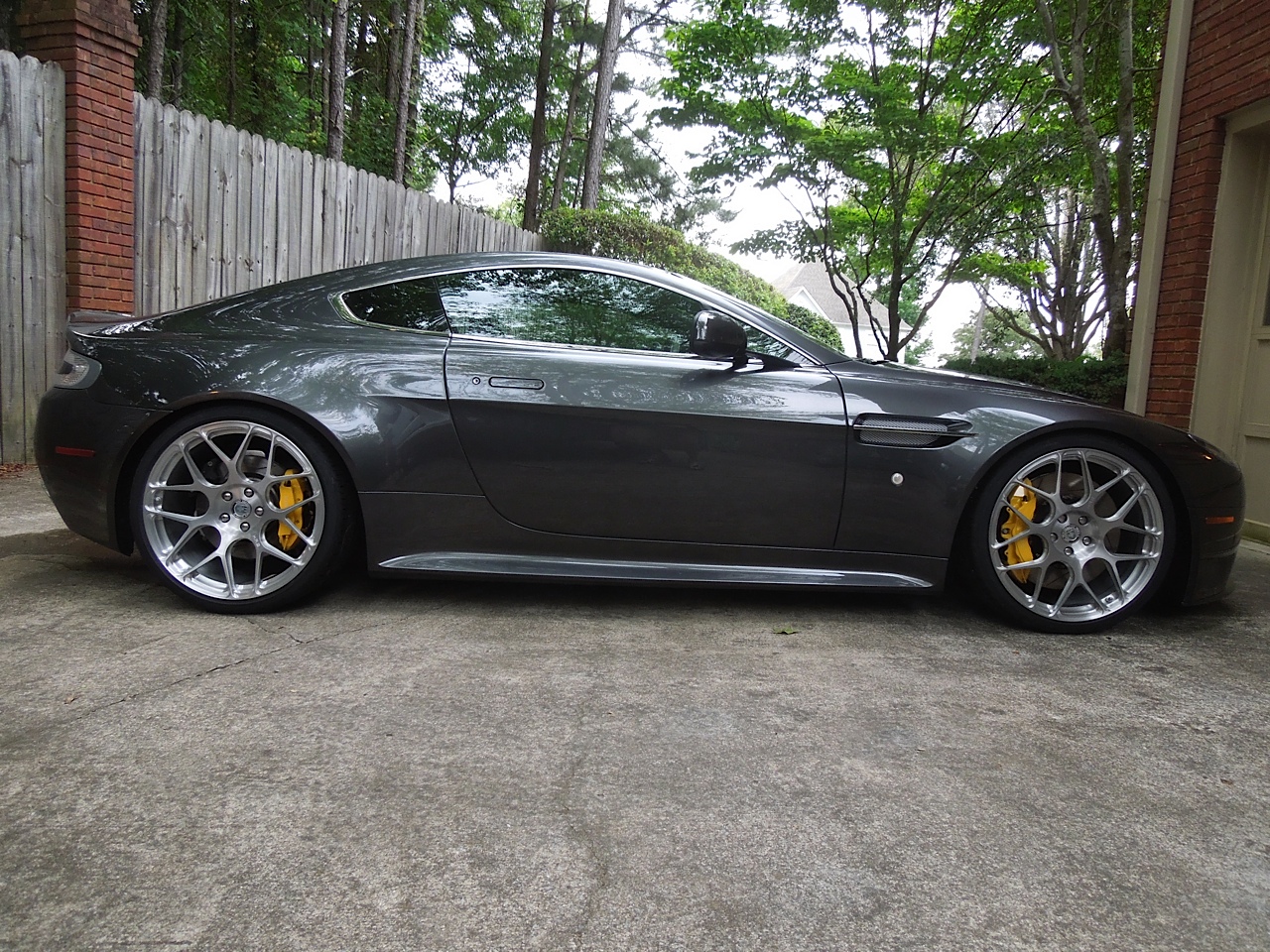

Old Feb 19, 2017 | 06:23 AM
Montana107's Avatar
Joined: Mar 2015
Posts: 233
Montana107 is infamous around these parts
Offset view

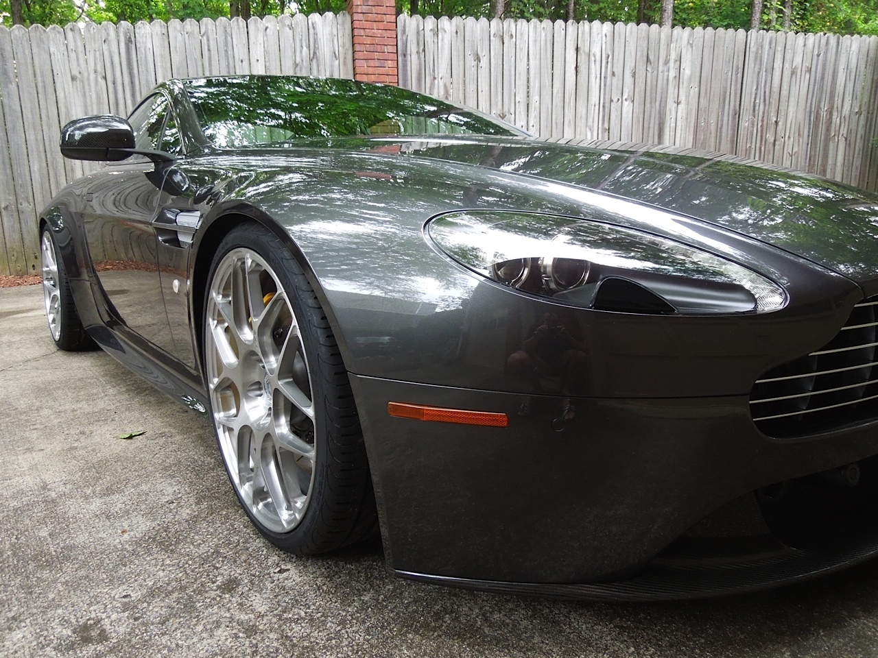

Old Feb 19, 2017 | 06:31 AM
Montana107's Avatar
Joined: Mar 2015
Posts: 233
Side
Old Feb 19, 2017 | 06:44 AM
Gene G's Avatar
Joined: Sep 2012
Posts: 1,489
Rep Power: 105
Gene G has a reputation beyond reputeGene G has a reputation beyond reputeGene G has a reputation beyond reputeGene G has a reputation beyond reputeGene G has a reputation beyond reputeGene G has a reputation beyond reputeGene G has a reputation beyond reputeGene G has a reputation beyond reputeGene G has a reputation beyond reputeGene G has a reputation beyond reputeGene G has a reputation beyond repute
Absolutely beautiful. Very nice looking car. Perfect wheels with the correct offset.
These cars should have come with these offsets.
What size tires do have on those wheels?
