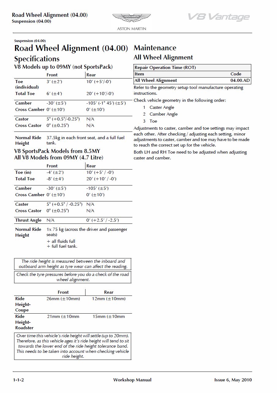

Gents.
Any suggestion for wheel alignment in So Cal area, Dealer wants $480 for alignment which I think is ridiculous. I've replaced coil springs, (velocity AP) looks like it's got negative camber just by looking at wheels. I want to get 4 wheel alignment done. Does anyone have Specs from Aston Martin publications. I have local alignment shop that most likely can do it for me for $100, but want to compare the specs before we do it.
Thanks in advance

Most of the alignment machines have AM factory specs available in the system and the tech will adjust camber, caster, toe and thrust angle accordingly to them within the acceptable range (green zone). Normal alignment is about an hour and they usually stop at "good enough". It takes skills and time to match sides.

Here are the alignment specs from the workshop manual.

Jeff 335i, Would you also have the specs for 09MY SportsPack? Thanks
That's the only page about alignment in the 1,000+ page manual I have.
It does have a chart that says it's for 2008.5 Sport Pack cars and All 2009+ V8's. Looks like all the 2009 and newer cars use the same alignment settings?
