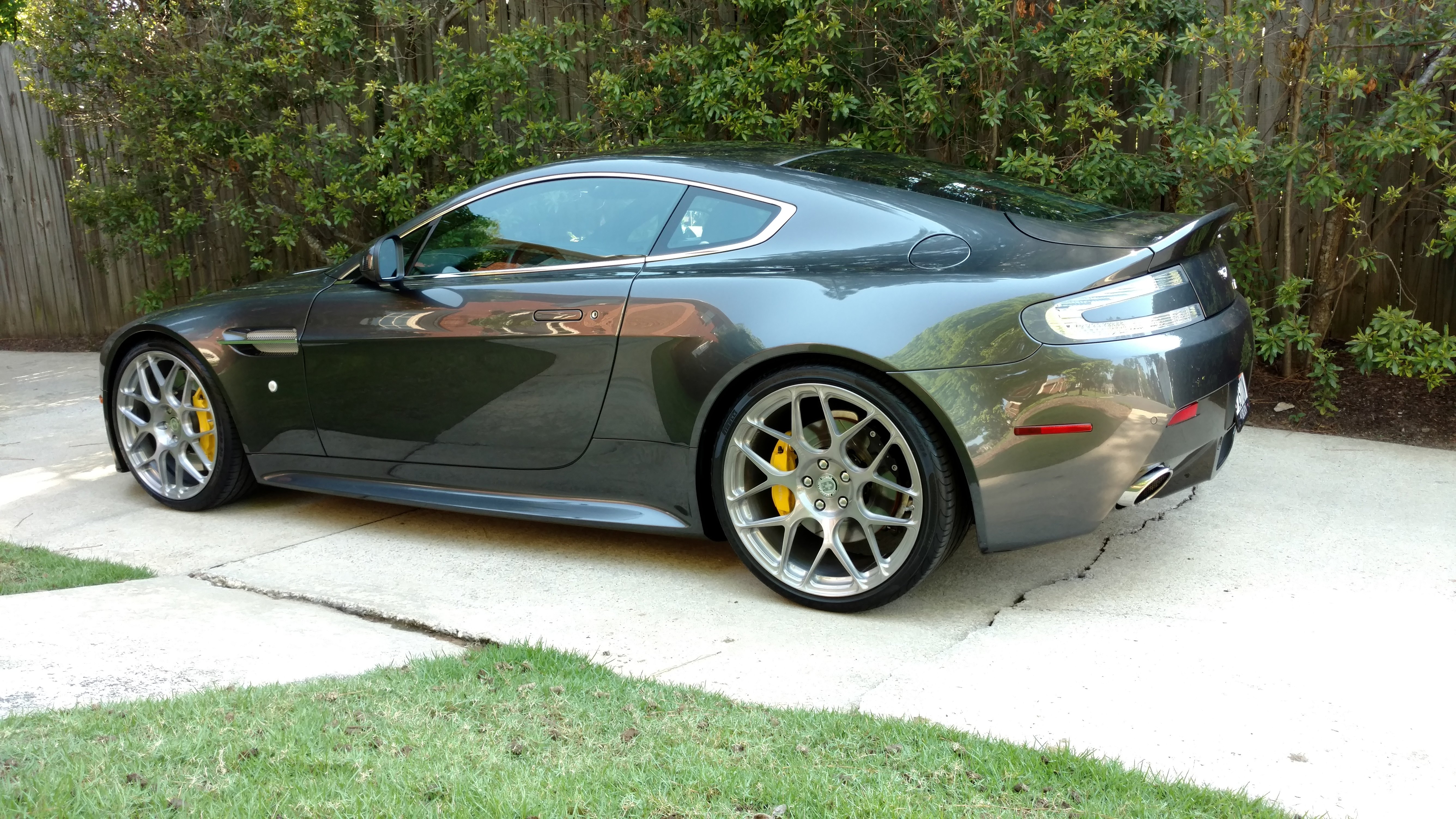

I have the same size
Mine are 20x9 et42 and 20x11 et52 / Lowered with no issues
