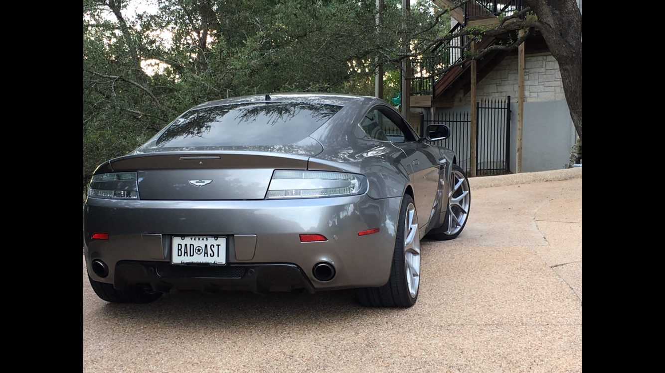

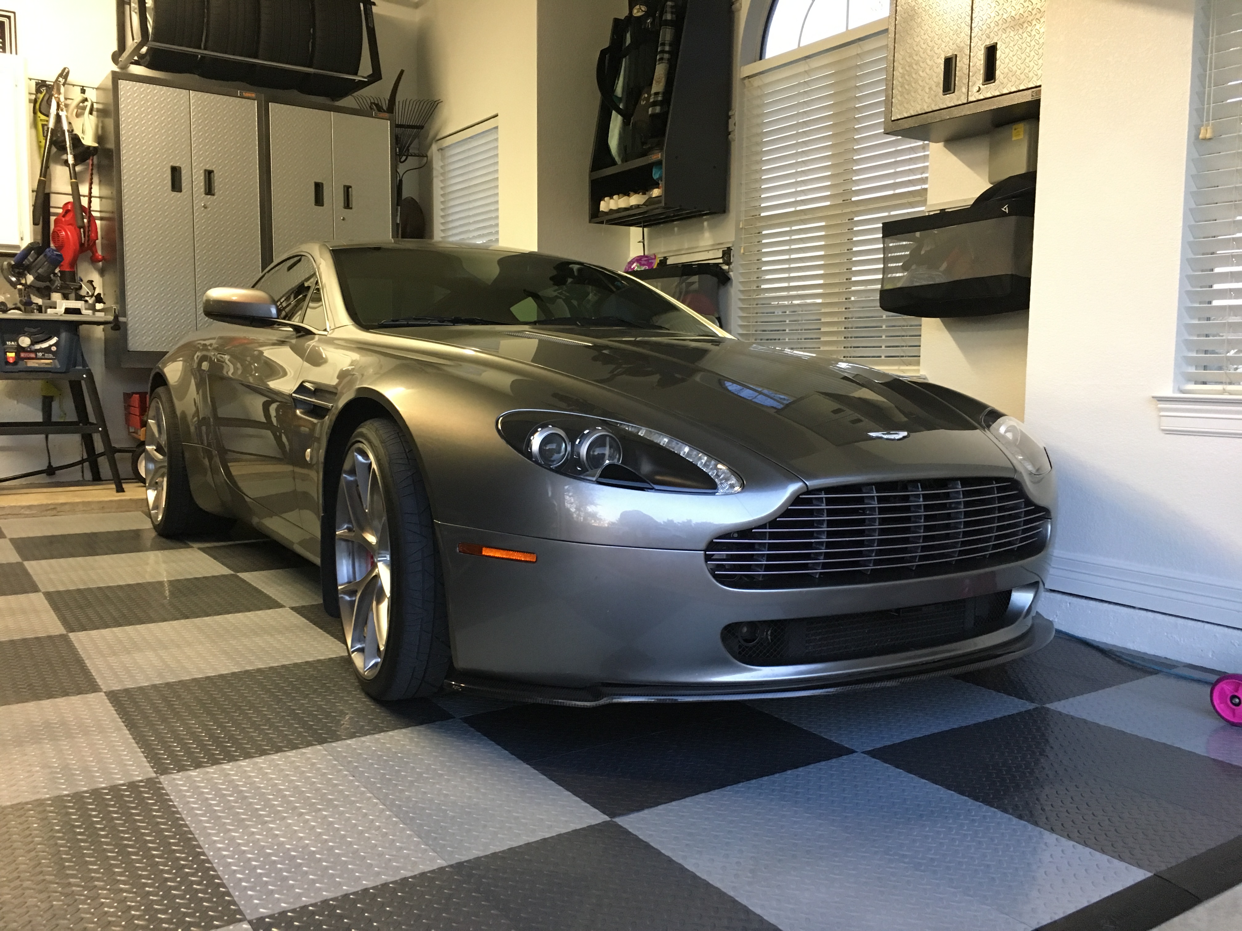

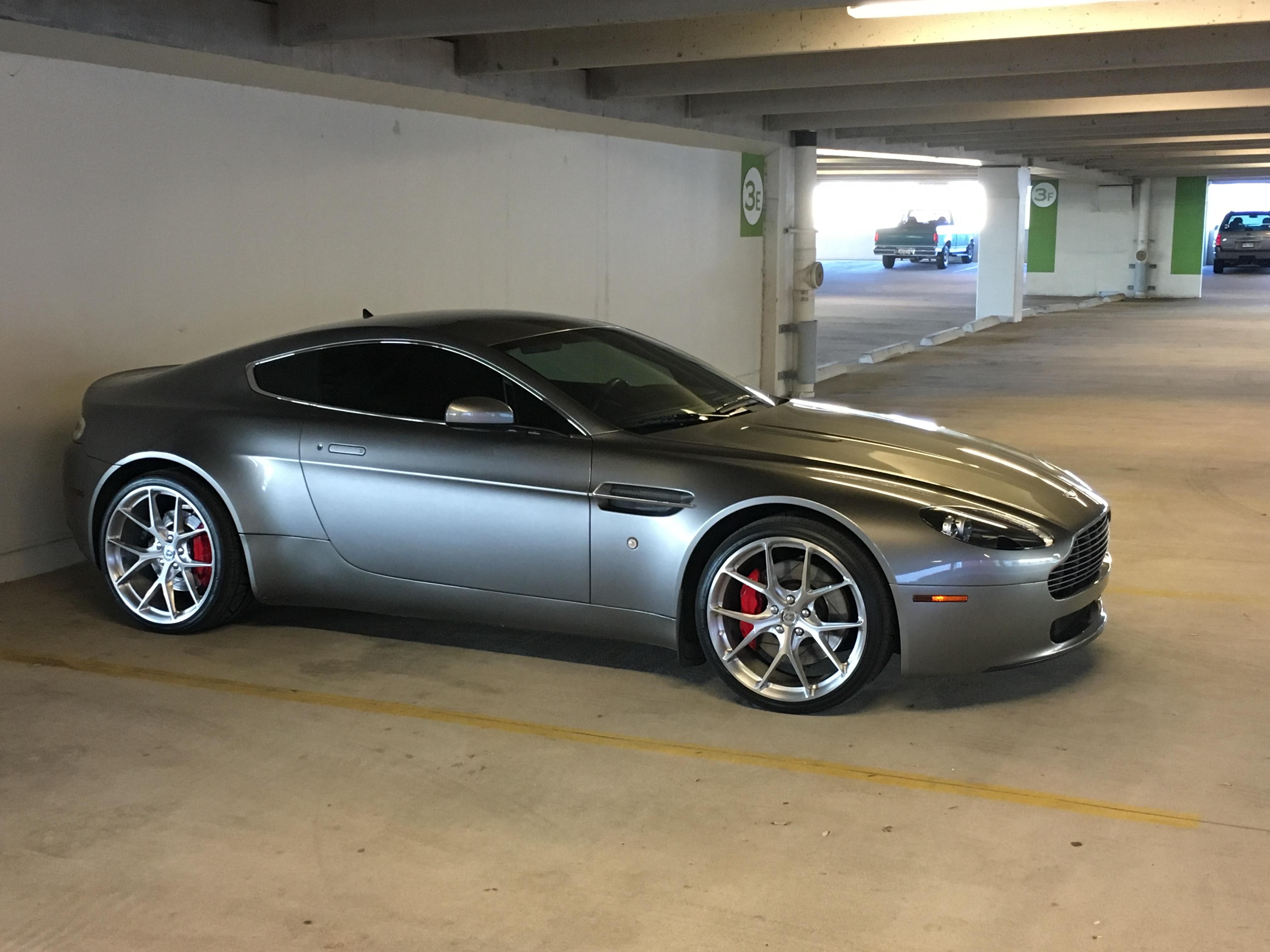

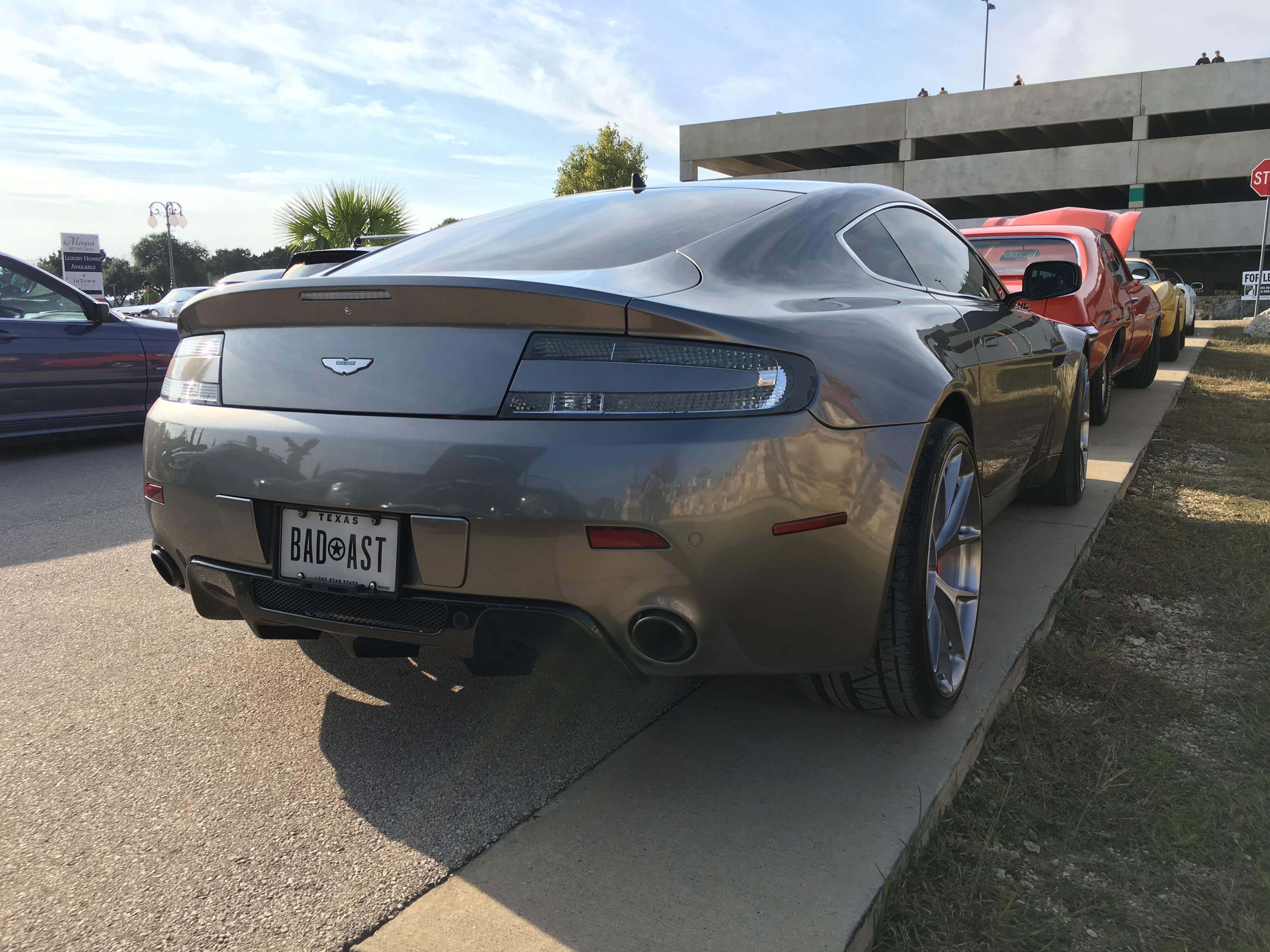

I run 20X9.5 ET35 front. In HRE P101 they are 20lbs. Tire is 255/30/20
I run 20X11. ET47 real. In HRE P101 they are 22lbs. Tire is 305/25/20

Here are a few pictures:

I need to look at his offset number just to see the calculations. He posted the best kind of pictures for showing wheel offsets that you could get.
