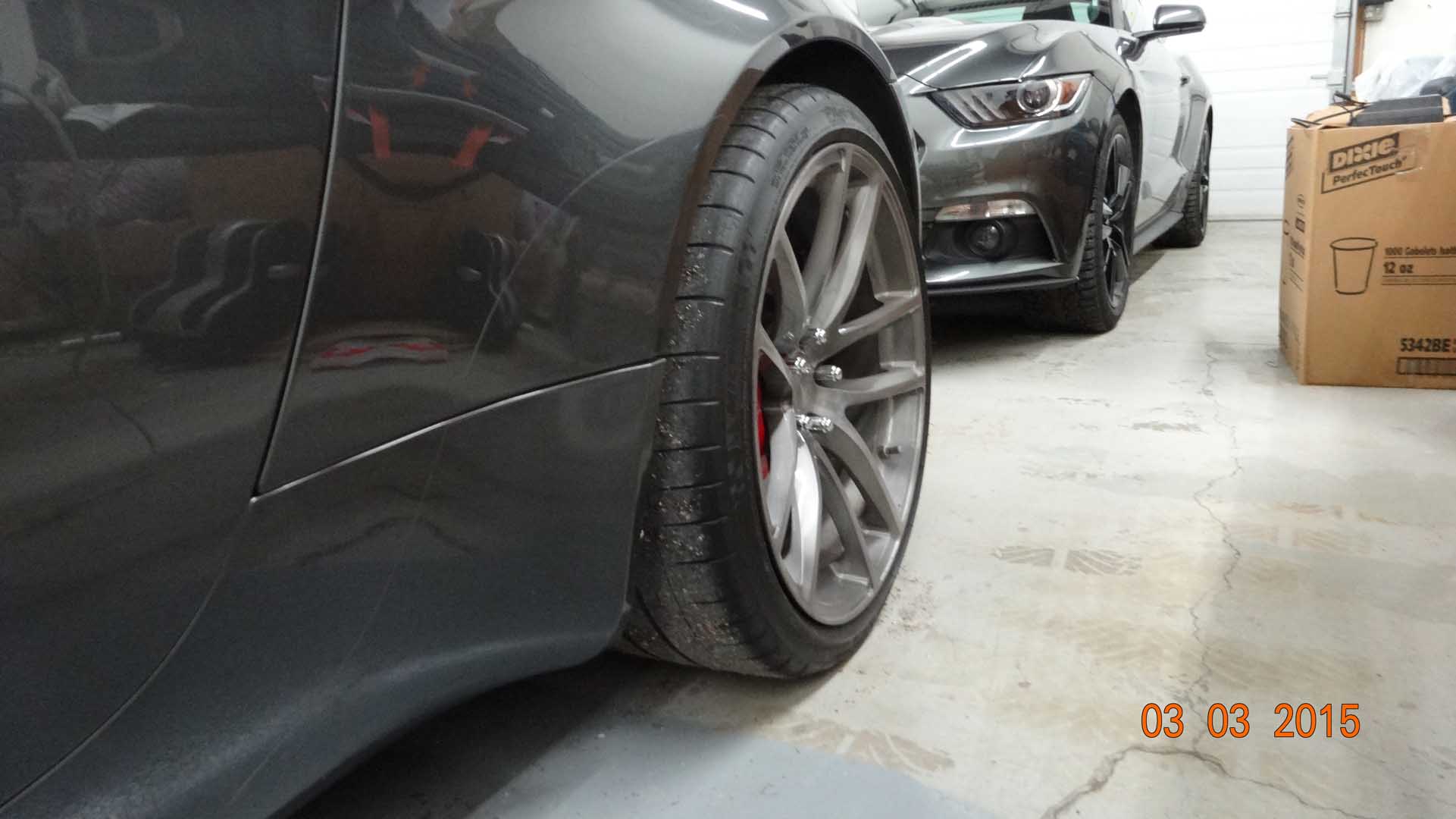

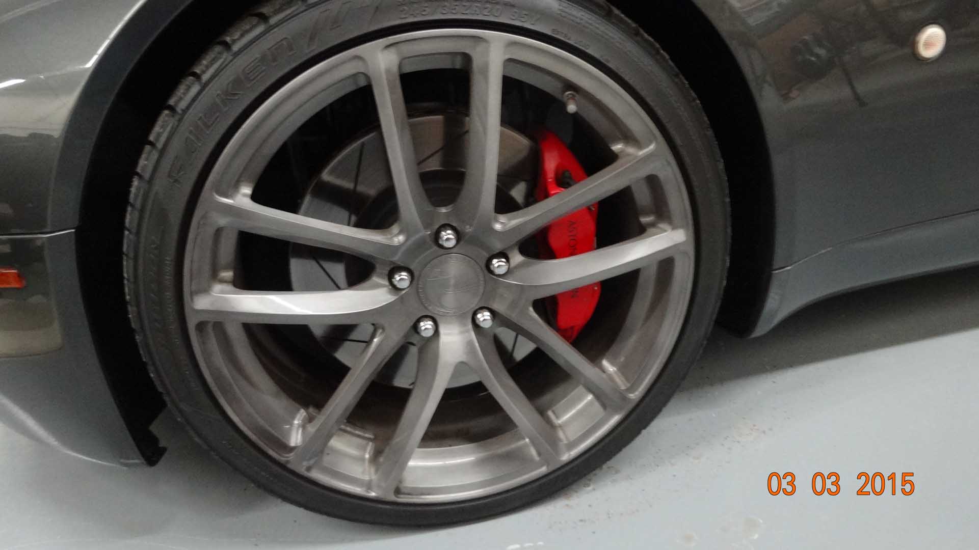

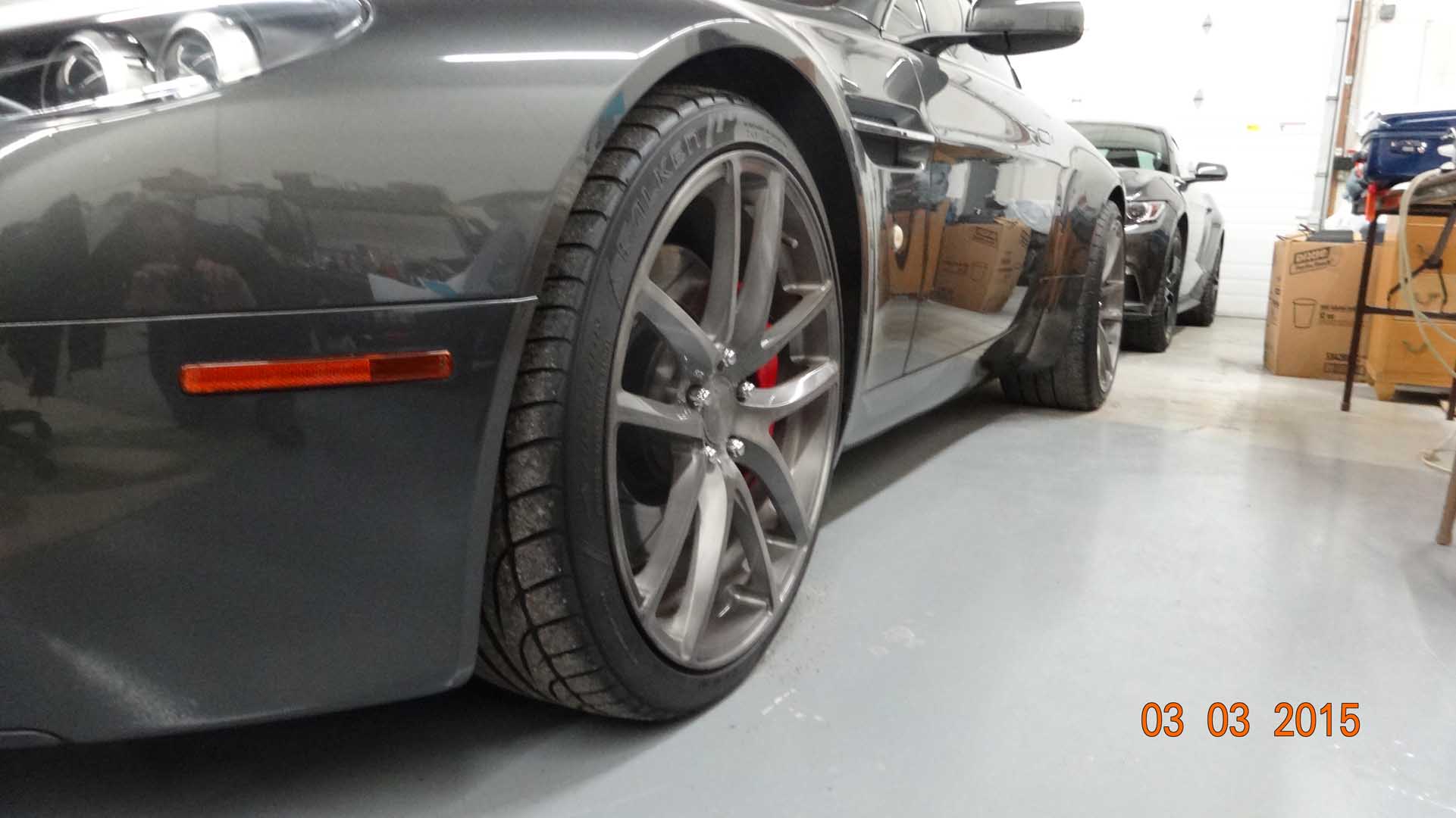

20" Modulare
I really like the 20" Modulare's I have on my 09 Vantage... did not negatively effect the ride quality from stock... same as on the blue example on the Modulare web site:
http://www.modularewheels.com/galler...Aston%20Martin
I bought mine used from the same Vantage as in the photo, so Modulare would have the specs. The tire size is 245/35zr20 front and 295/30zr20 rear
ID:	415434   Click image for larger version
ID:	415435   Click image for larger version

WOW those look great!!!

I see a new Mustang parked behind the Vantage. Could you tell us about it and how it compares to the Vantage?
