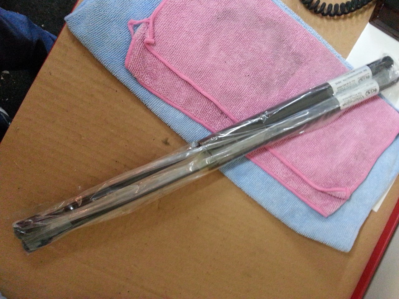

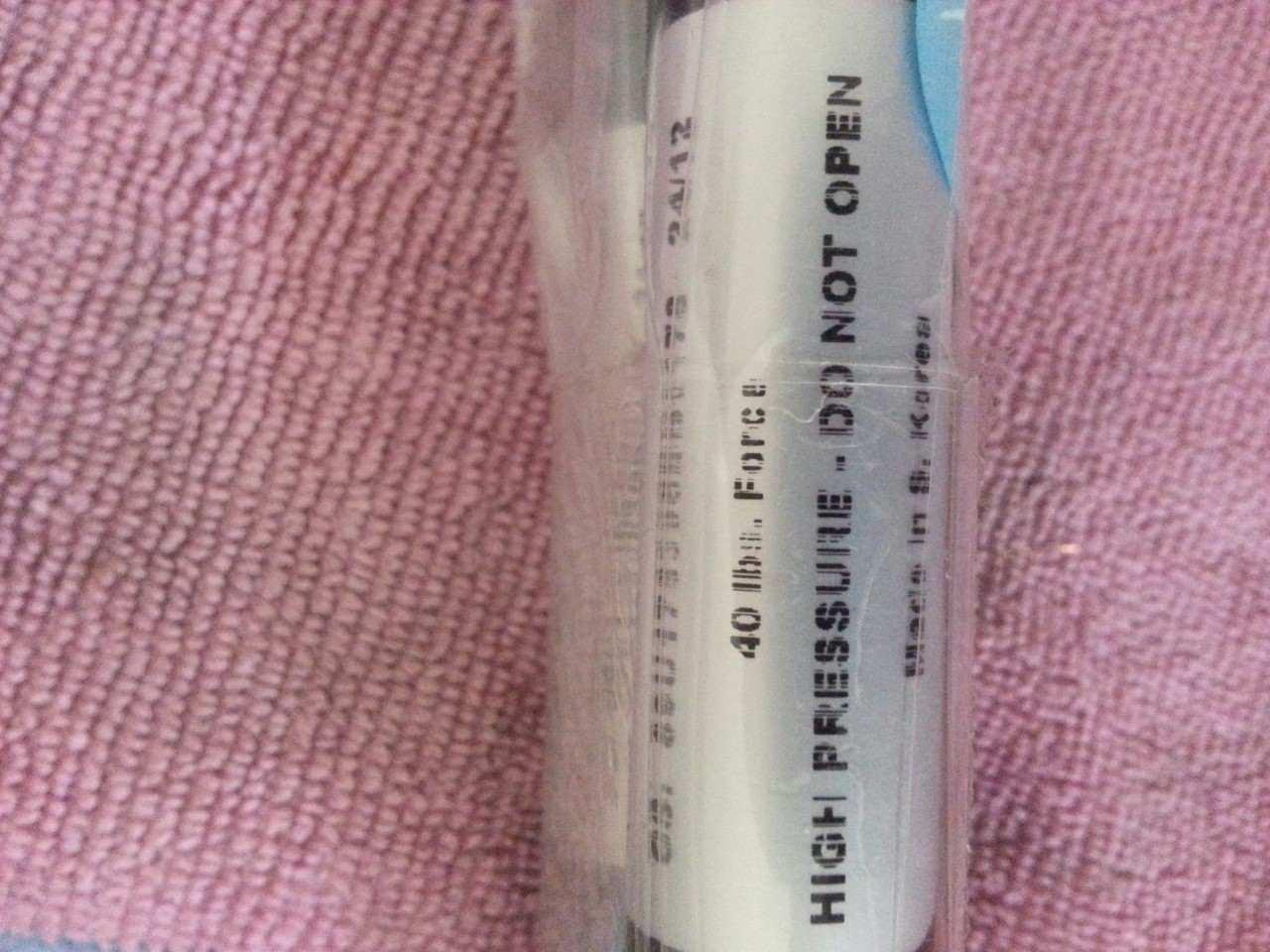

Old Apr 8, 2017 | 06:02 PM
W126C's Avatar
Joined: Feb 2016
Posts: 249
From: Kansas
W126C is infamous around these parts
I checked the struts in the boot and under the bonnet, no info about pressure. In the pictures, those are struts for a Porsche 928 rear hatch and clearly state 40 lbs. force. They are the same size/length as the hood struts, just different force. So how do we tell the force of the different struts on the Aston? That is if your going with aftermarket.
