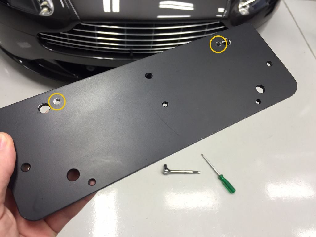

Hi Gang,
Since I'm in a state that requires a front plate, and I don't need anymore excuses to get pulled over, I decided to fiddle with mounting my front plate. I purchased the NA front plate kit from AstonMartinCarParts.com; all said and done, it was like $200 shipped for the all front plate mounting parts. After getting the parts, I decided the plastic OEM mount is WAY too bulky and obtrusive. Having a front plate on the car obtrusive enough--the last thing the front-end needs is a bunch of BEEFY plastic.

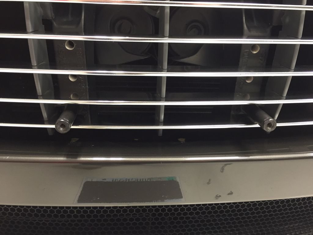

So here's what I ended up doing. I used two of the 4 mounting posts I ordered from Scuderia (part number included @$5.30 each):
I etch primed the posts, painted them flat black and mounted them into the bottom set of grill holes. I used some nylon spacers to get the front of the posts to overhang the bumper by about 1/8":
I then took the 1/8" aluminum backing plate I ordered as part of the OEM mounting parts (part#6G33-16E146-BD @$15.31), rounded the corners, drilled and tapped two holes (circled in yellow) for 1/4-20 screws, etch primed and painted flat black:
(You could go to the local hardware store and buy a piece of stock 1/8" aluminum and make this part from scratch--would be super easy and CHEAP. But I decided to simply modify what I had in hand)
With a couple M6 flathead screws, here's the backing plate mounted up to the posts:
As you can see in this pic, there's about a 1/8" gap between the backing plate and front bumper. The backing plate is VERY rigid and will not budge--even at Aston capable speeds. ;-)

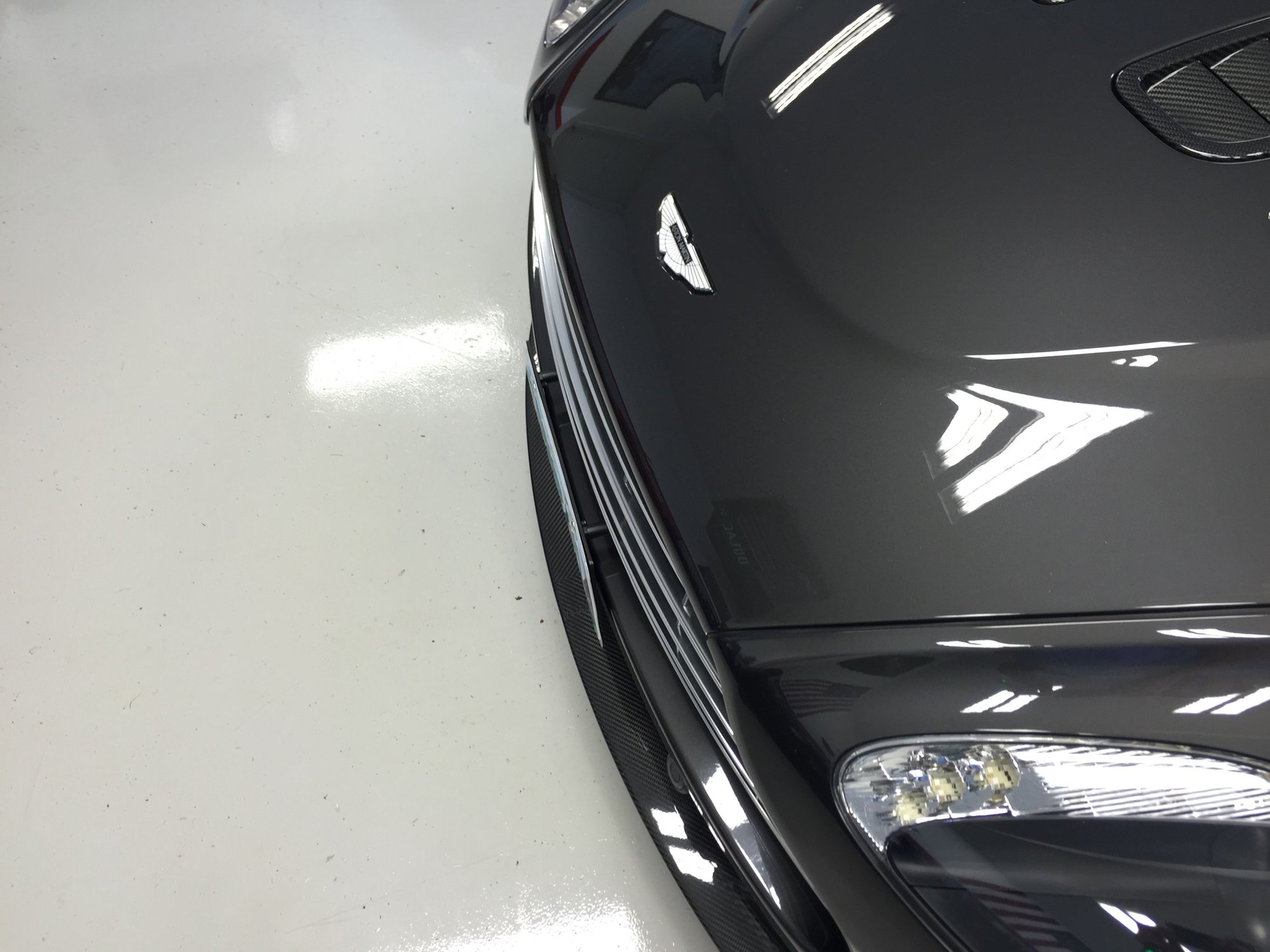

Here's a low angle shot of the plate mounted up:
And finally, a wide angle shot of the plate mounted up:
