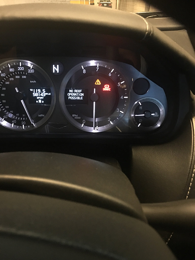

08 Vantage roadster. Came from my long trip started up car. Top wouldn't work. And when opening door window wouldn't roll down slightly. Did some research and windows needed to be reset (down hold 5 seconds up hold 5 seconds)
Anyways top started working but auto filing mirrors still not working. Maybe I didn't reset windows properly. Does car need to be on or off? Door open or door closed?
At first I thought it was too modified but maybe not?

Unfortunately, you'll need an AMDS to set the mirror fold function on a 08 and earlier model.

Typically this happens during a low voltage event. Has the battery been low or dead lately?

car sat for over 2.5 weeks. there was hesitation when starting. Battery was probally low. (Alomost been 5-6 years since last battery change).
So yea probally the battery. Wonder how much a dealer will charge me for this.
