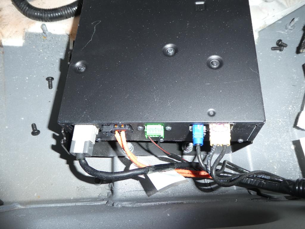

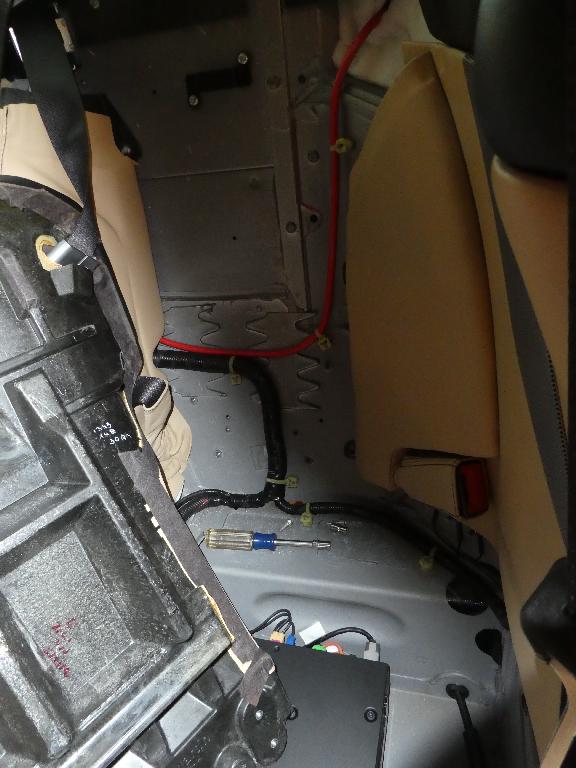

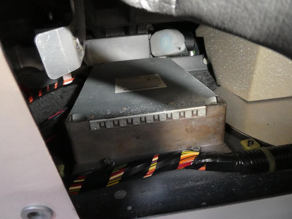

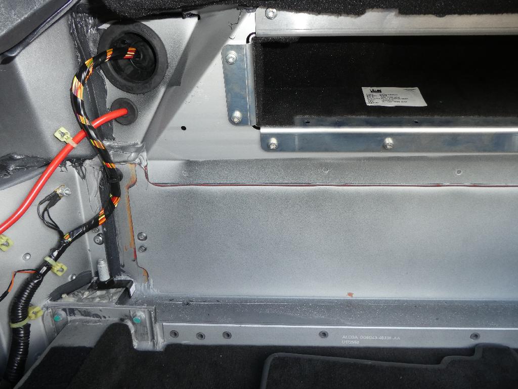

and I've confirmed that the DVD player under the rear seat is NOT the sat/nav brain. The brain is actually BEHIND the rear seat and IN FRONT of the boot (NOT in the boot) in a sort of limbo region. It's like in a Tardis because you didn't know there was actually more space there.
You have to remove the boot covers, and there is an aluminum well, which you also remove (fits my power conditioner and tyre fixer). I've tried to include some photos - hopefully that will be successful.
Photo 1 - Back of Sat Nav DVD player
Photo 2 - Where the Sat Nav DVD player sits - in the rear seat - the only thing that can fit there.
Photo 3 - The entrance to the Tardis (aluminum well in the boot)
Photo 4 - Inside the Tardis - So much space borrowed from other bigger cars.

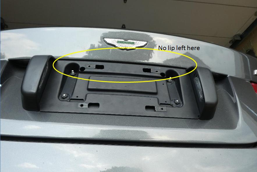

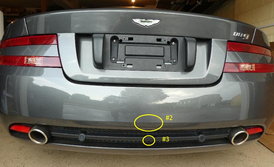

I uploaded two more photos regarding my reversing camera positioning dilemma.
a) Is there another plate adapter that will give me back the lip?
b) Are any of the two places I circled possible to install a low profile camera that will be able to be wired into the boot?
As for the audio amplifier, thanks - great point. I didn't know that the audio system in the DB9 is ALSO from VOLVO. I was told that the DVD player unit connectors where not the ones the interface unit used to connect to the LCD screen, so I'm a bit confused now/again/still. (And that also means I still don't know where the "Navigation Brain" is. So now back to the drawing board.

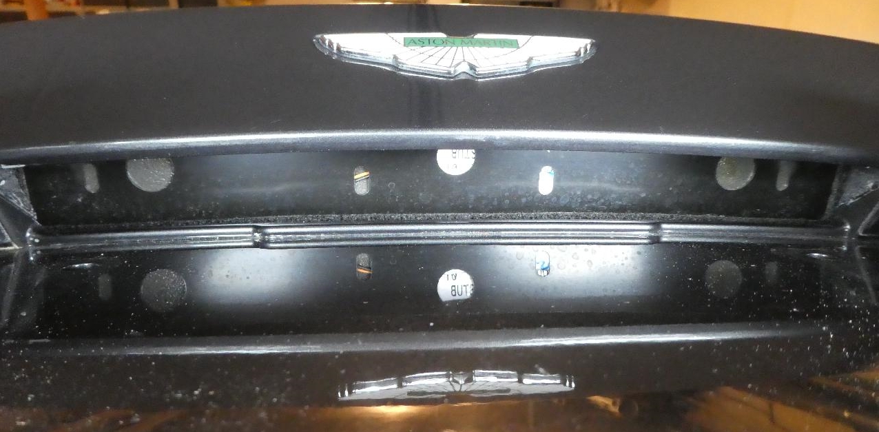

. Below are two photos. The first is the open section of the lip hidden by the plate adapter in my DB9 - note the plate there. The second photo is from the link above in the same section of that DBS. Well the holes don't really matter if you're only going to install the original part that belongs in that space, but if you also want to reinstall the original lights/boot switch, then you have to be sure it's the holes will match.
So the next two questions that arise. Should I fabricate a new plate holder to get a more vertical angle to the plate (Federal regs?)
? And a quick look did not turn up a loose connector for the boot switch that was obvious. Need to find it (could that have not been installed knowing that it was a US car?)
