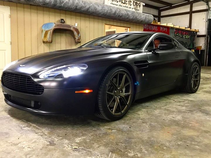

Thank you my friend. The dealer replaced the clutch prior to picking it up, feel good about that it's been at shops for 3/4 of the time I owned it. Will work with spec (sponsor on another car to replace once needed/ other items completed)
Paint 1 - fired after 2 weeks late and bad communication/never starting it.
Interior - 1 week to replace headline (sagged after 2 weeks of owning the car) Louis Vutton replacement (500 with authentic materials) cheaper than going with suede from AM or at the interior shop. (1600 from AM or 900 from shop)
Rim - 1 week for custom rims and color change (rained for 3 days when after they finished it)
Paint 2 - 7 days and should be free tomorrow
Reached out to my tuner for the 5.0 to see what he can do? He is researching it as well as a local shop who put in my sponsors parts and will be doing all the mechanic work on the AM due to trust and contract agreements on other business. Have you ever heard of a SCT handheld being used on a tune?
Any recommendations on brake upgrades for less dust?
Any items to be concerned with running straight pipes/no cats?
