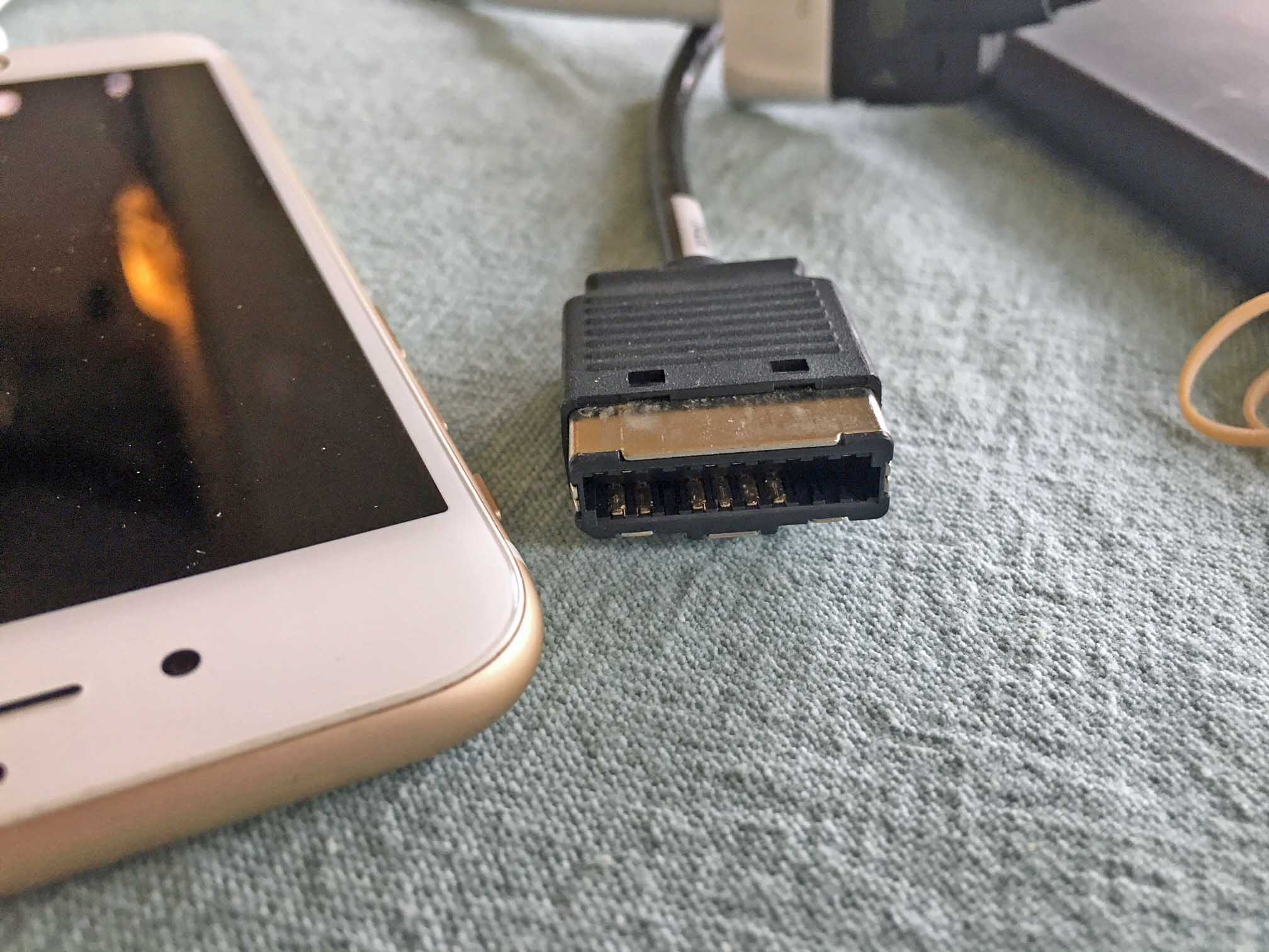

Looking into all options, right now just charging separately. Below is the pict of the existing connector

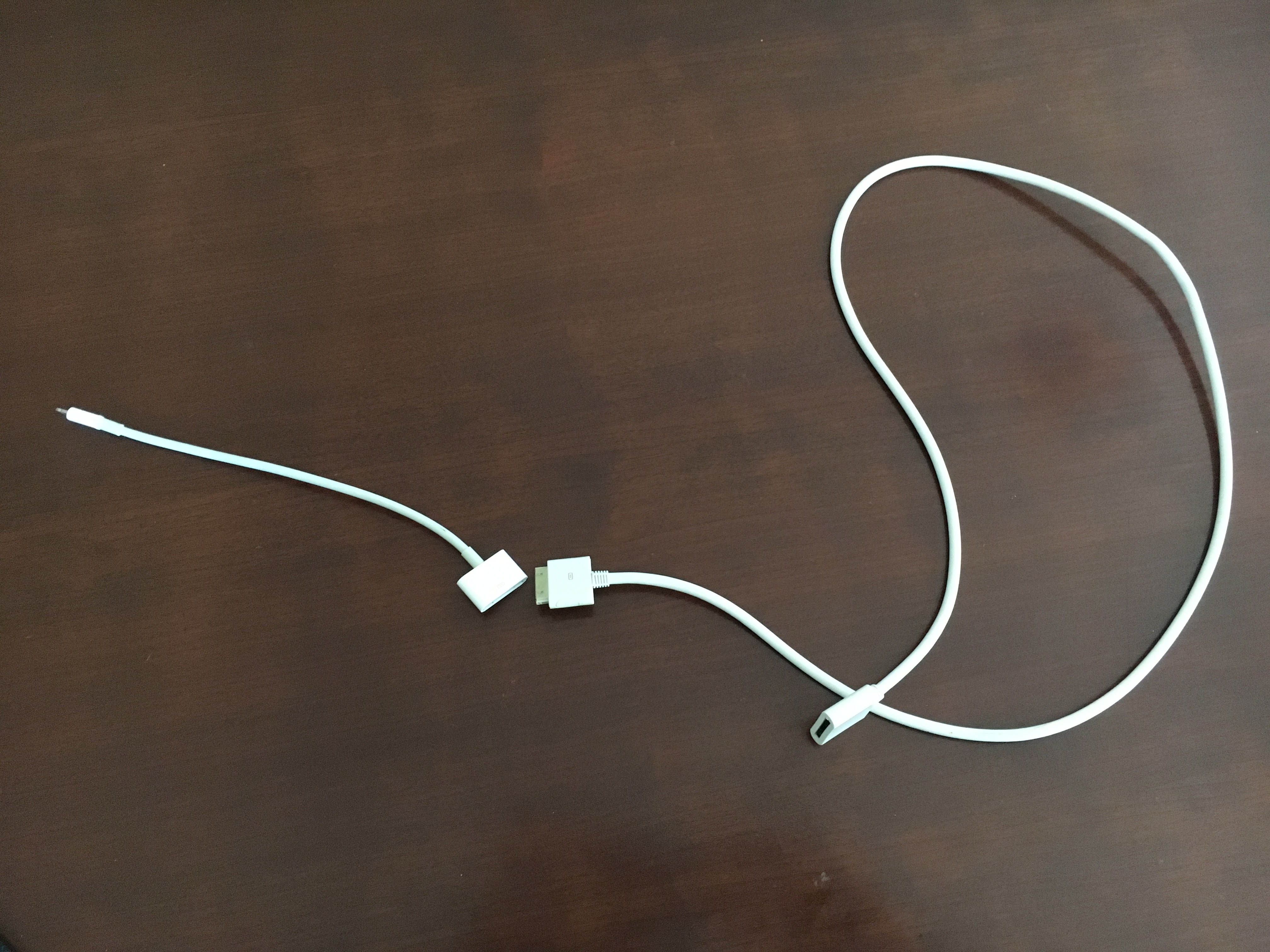

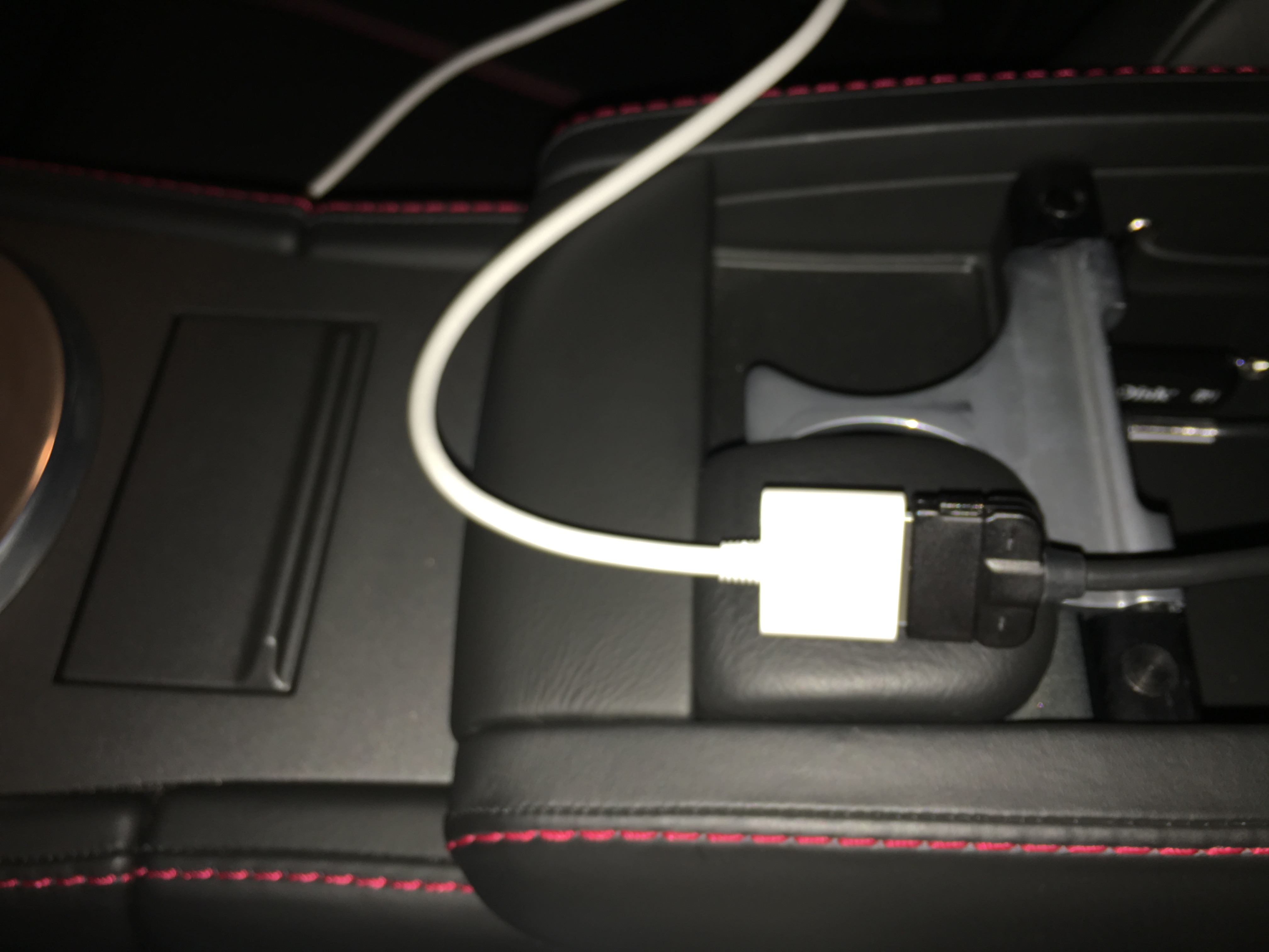

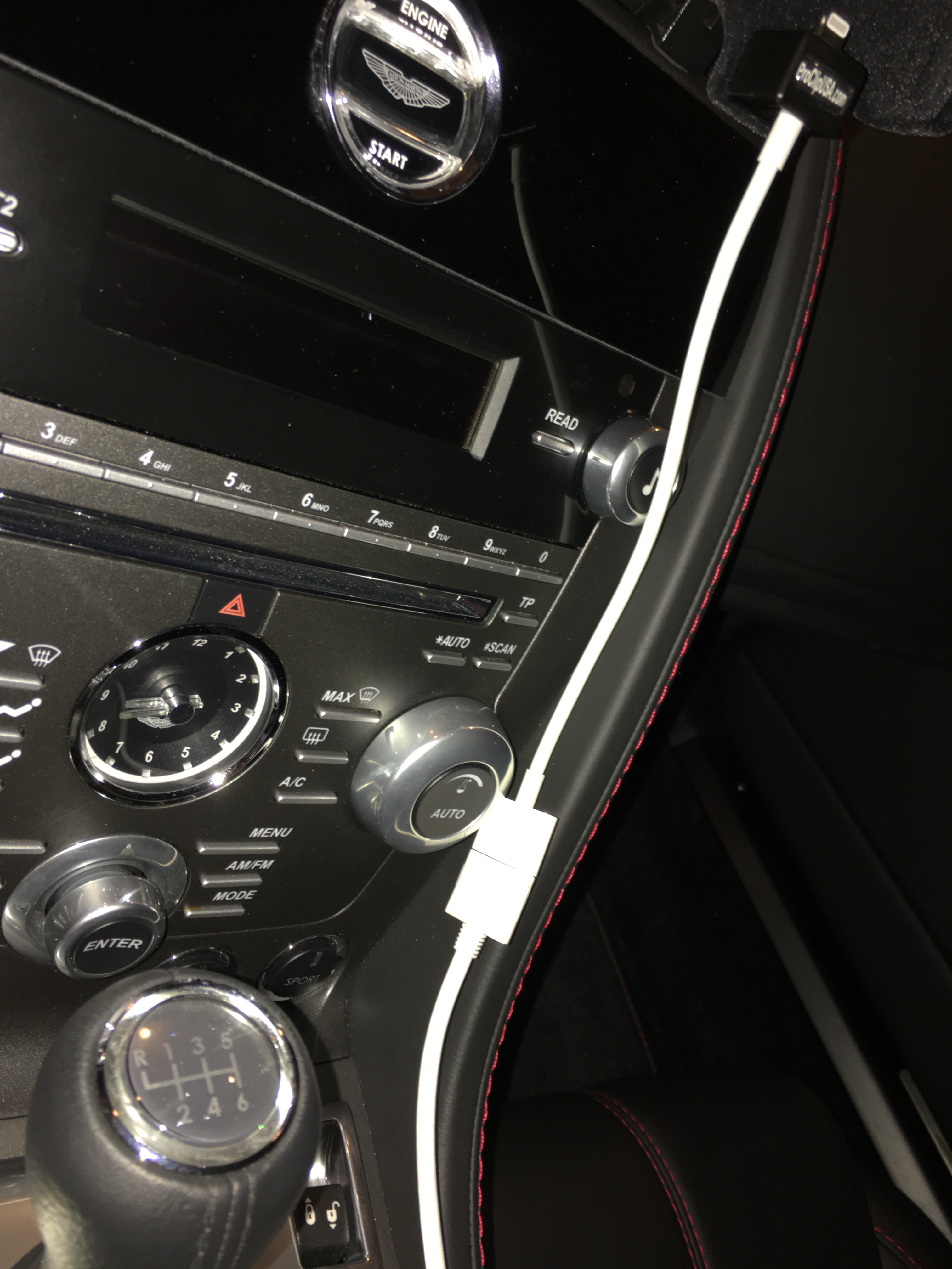

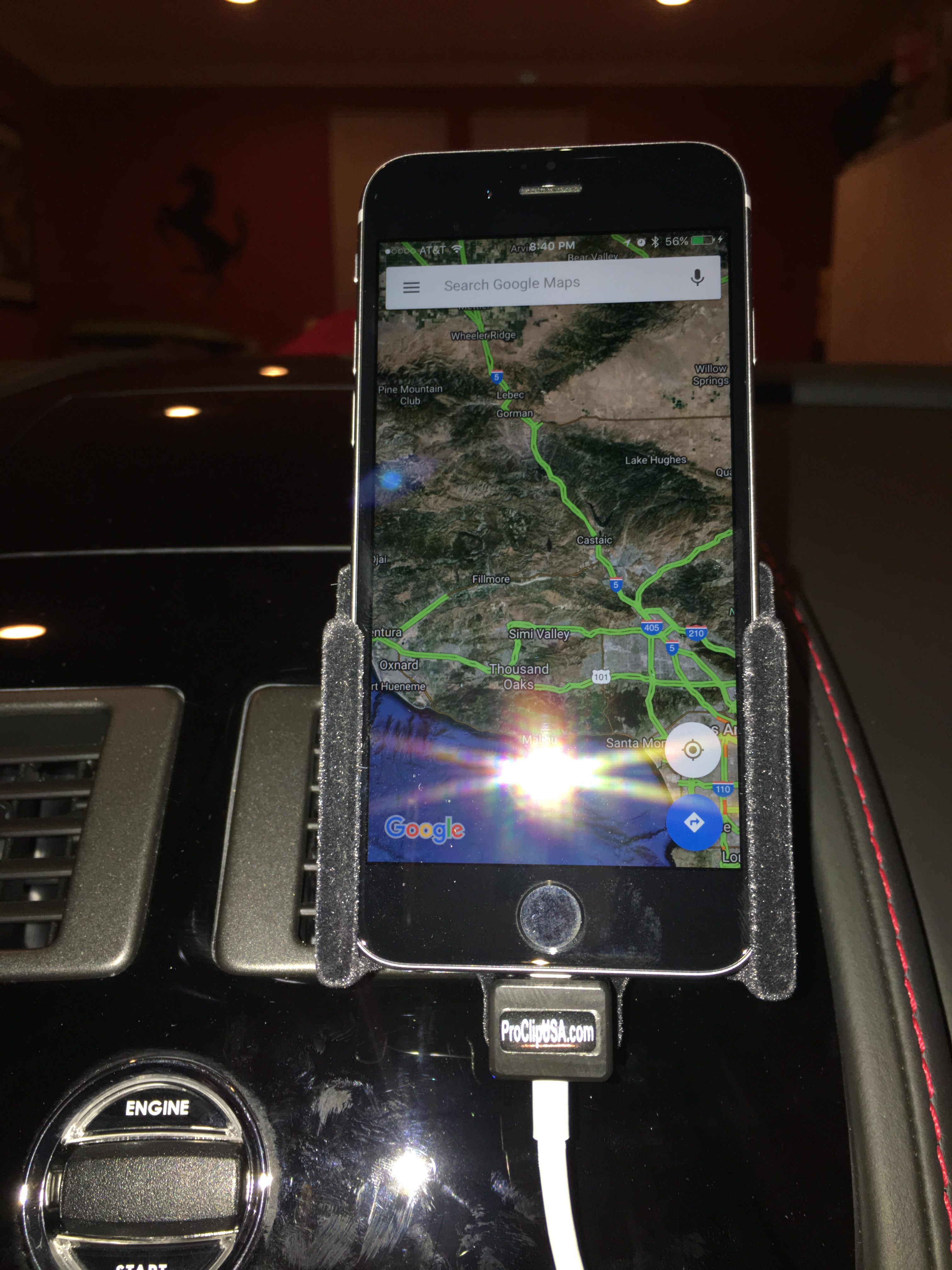

I went down this same path some times ago and tried just about all the possible different combinations of cables and connectors in trying to hook up my iphone6 to the AM factory ipod connector that came with the car. What I wanted to achieve was to have both music play (edit: oh, and have navigation instructions from Google Maps coming through car's speakers, too) from my iphone6 while retaining control of music play from the steering wheel AND to have power charging that iPhone at the same time.
At the end I went with BoVee.
It's seemingly flawless in operation and without any ugly cables or connectors dangling around. However, I do keep an extra lightening-to-USB cable in the car for emergency charging.
But if you insist on wanting to have music play and charging at the same time via a physical cable, it's doable. However, the ONLY way to achieve that is by using Apple's OEM lightening-to-30pin cable. Since that cable only comes in 20cm length, there is no way to hide that bulky and ugly 30pin connector but to leave it exposed. Cosmetically, this is not a very pleasing way for any installation. It just looks out of place in an Aston, IMHO.
Sidenote: Most cheap cables out there that you can get on eBay, Amazon or whatever would only provide power for charging but no data transfer hence no music play.

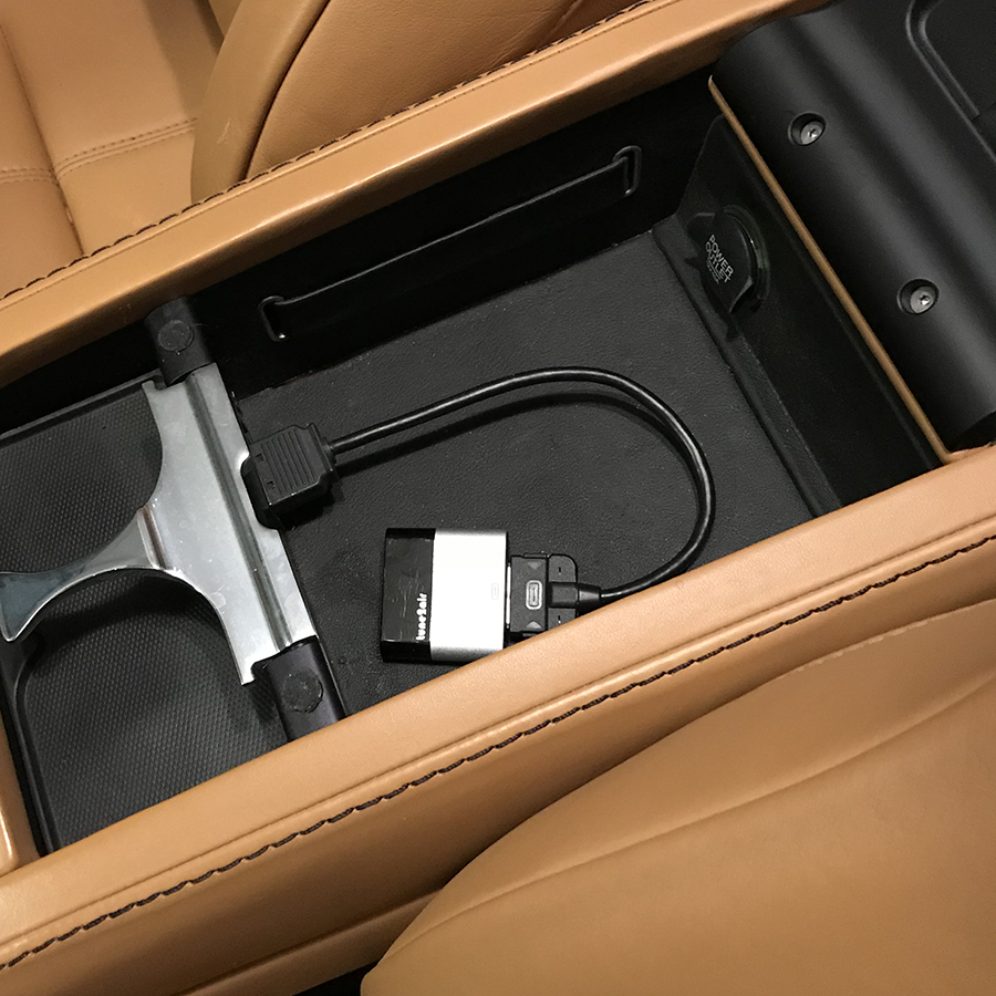

Bovee/Tune2Air Bluetooth Adapter
I use this to listen to iTunes or Spotify on my V8 Vantage Roadster via a Bluetooth connection to my iPhone. You can use the car's head unit to browse playlists, albums, artists, etc. when using iTunes but not while using Spotify (if you want to change playlists in Spotify you have to do it using your iPhone). The steering wheel as well as head unit next/previous track buttons work. The battery life on my iPhone 7 Plus is pretty good and the charge lasts the entire day so I just leave the Tune2Air adapter on all the time.
Bovee/Tune2Air Bluetooth Adapter Bovee/Tune2Air Bluetooth Adapter

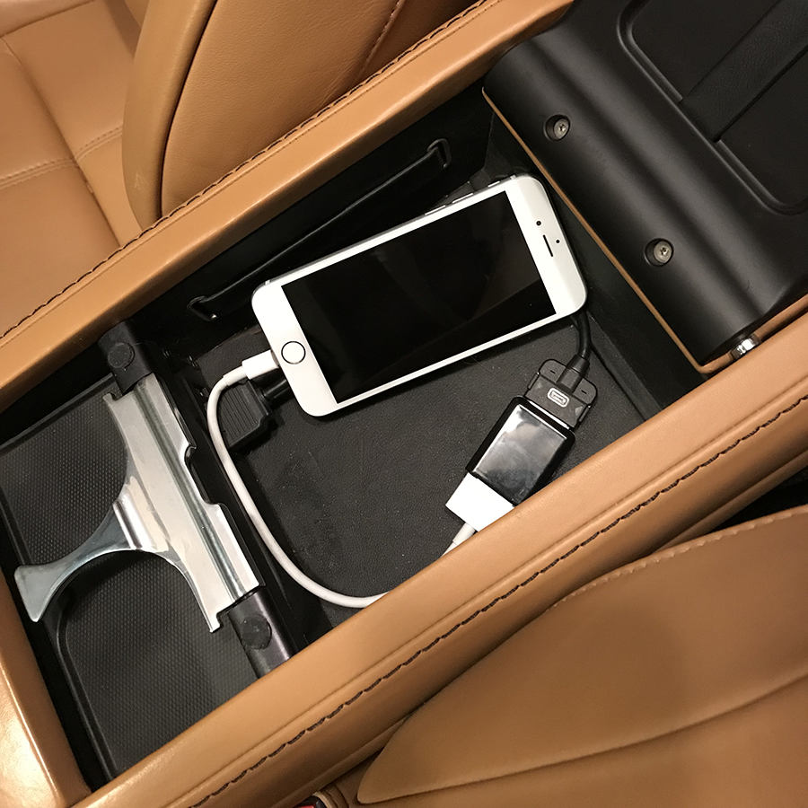

Scosche passPORT Charging Adapter for iPhone and iPad
I use the Scosche passPORT adapter and an Apple 30-pin to Lightning adapter to connect my iPhone to my V8 Vantage Roadster (I connected my old iPhone 6 in the picture below to show that your iPhone 6 can fit without preventing the console lid from closing). With this setup, I can listen to iTunes and Spotify and browse playlists (iTunes only) and skip tracks (both iTunes and Spotify) using the car's steering wheel or head unit controls.
Scosche passPORT Charging Adapter Scosche passPORT Charging Adapter
