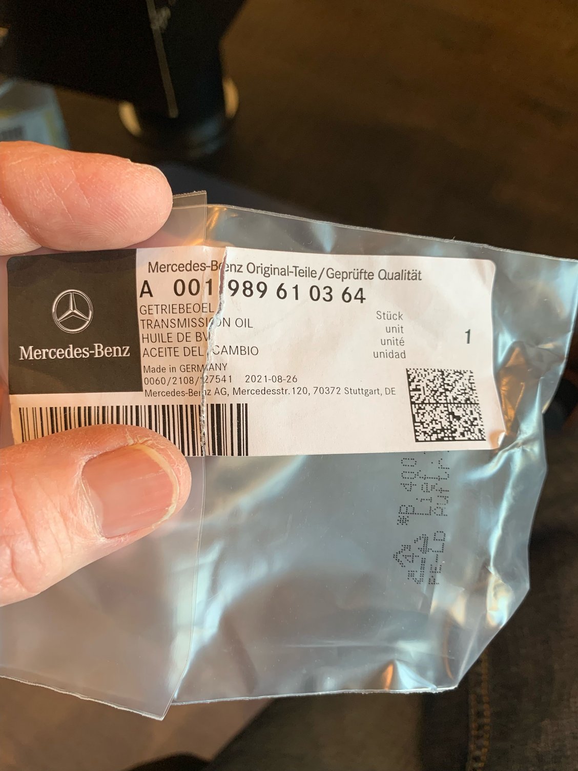

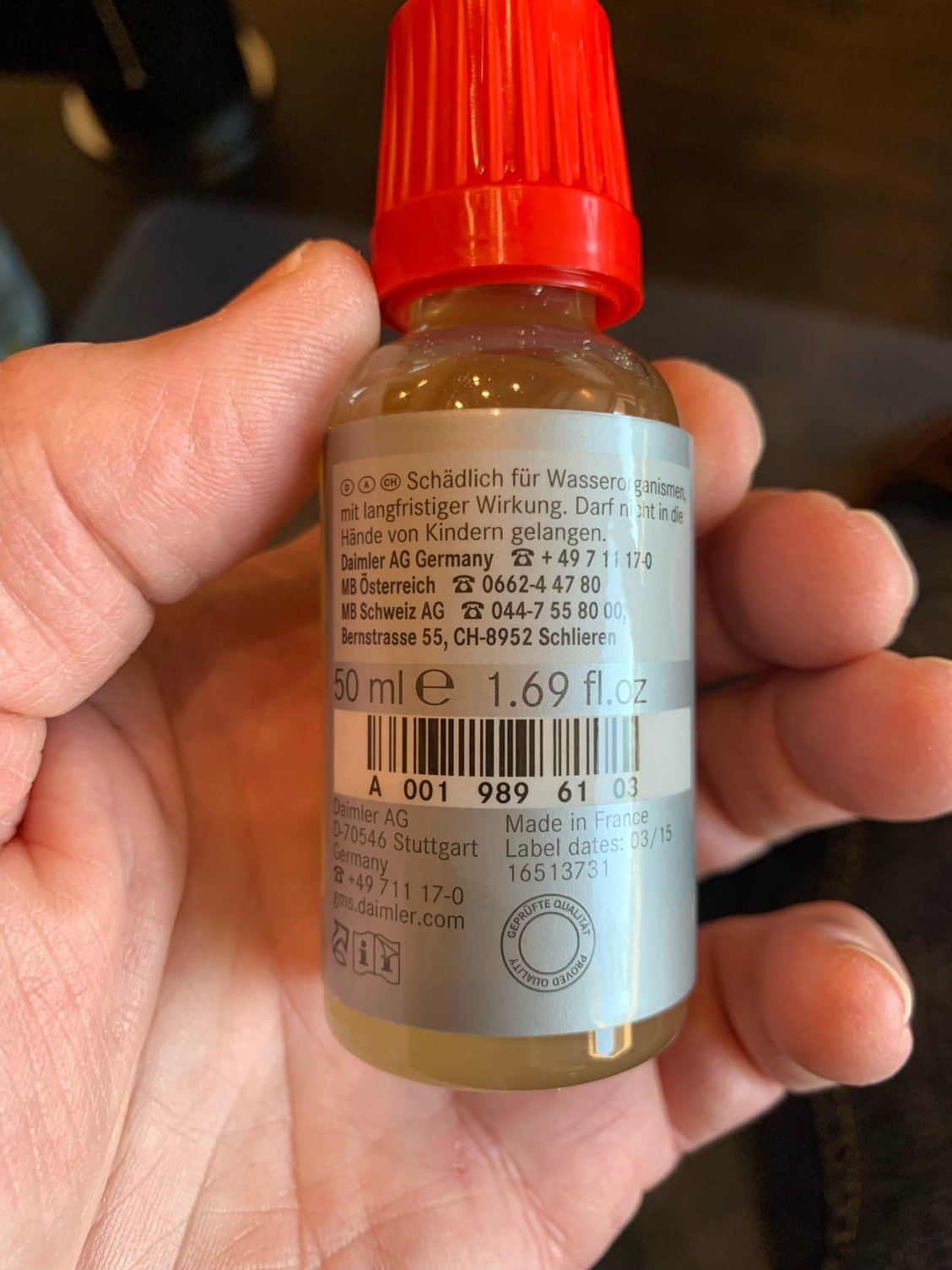

This (6178) will cross the the AM part #....
