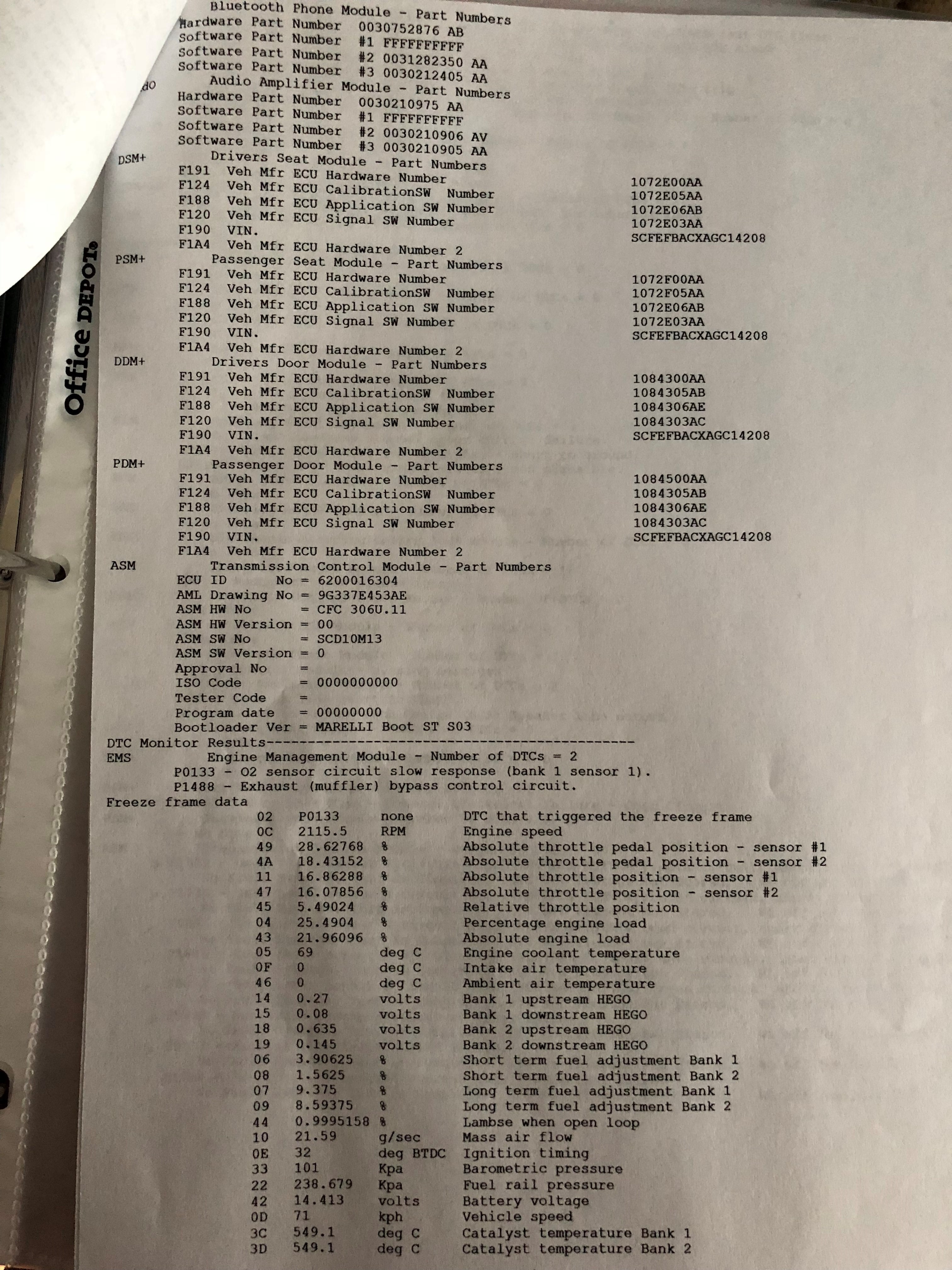

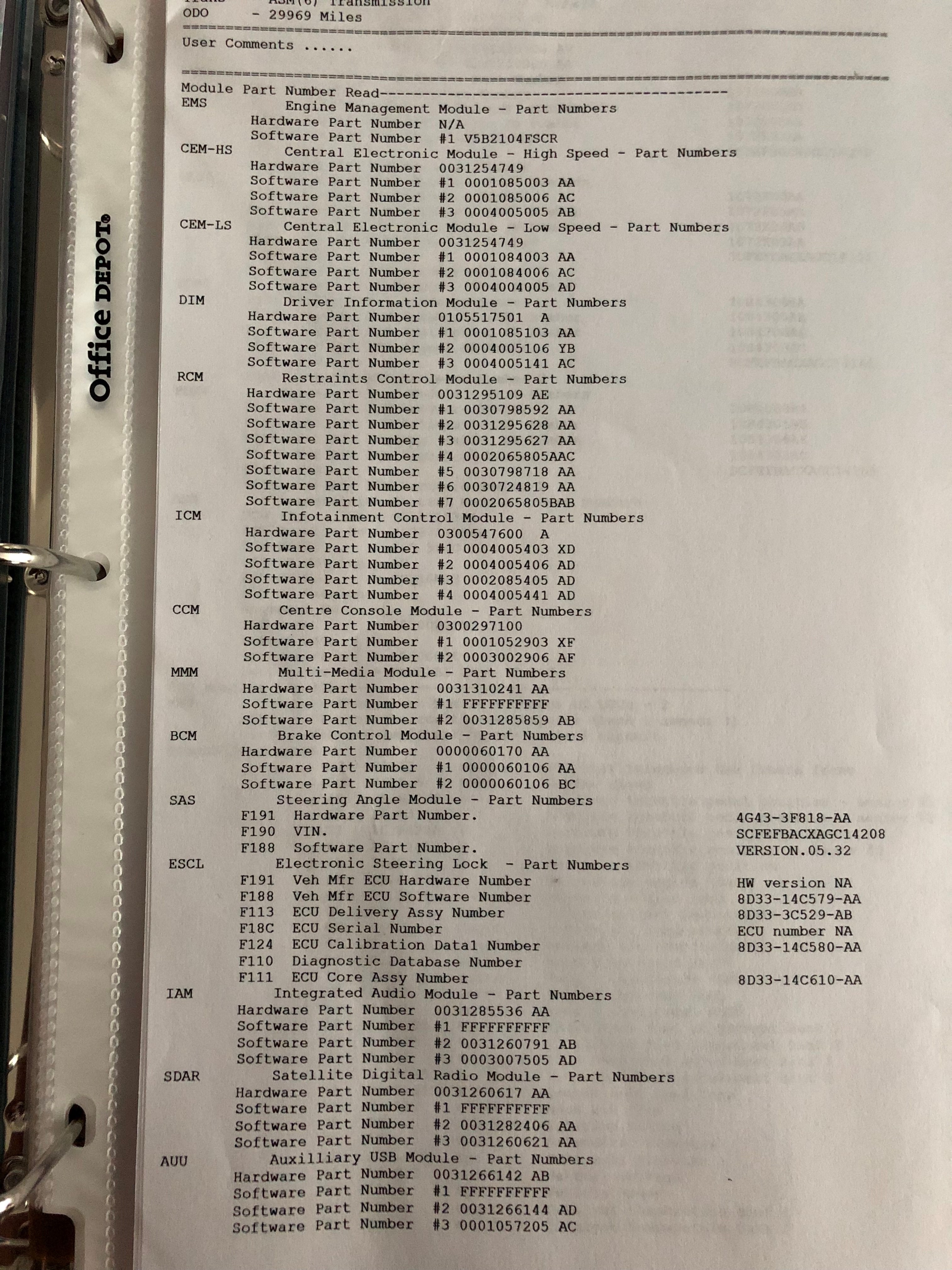

I'd like to preface this with the fact that I've never had any clutch issues, engine issues, even DTCs in my current 8mos of ownership of my 2011 V8V Sportshift
Dropped off my car at an indy exotic dealer last night to have a simple $160 alignment. I legit drove the car around for a good 60 miles doing random errands all day, with 0 issues before dropping it off. This morning, they moved the car around to make room for other cars to get onto the service bays with no issues whatsoever. They estimated they moved the car in and out a good 4 times with no issues, but when it came to actually get my car on the service bay - it would not move.
The car starts just fine, no lights on the dash, idles completely fine, but will not get into gear. When it's put in reverse, the car will not move - the car sounds like it wants to move but the throttle modulates without actually moving the car - it's like the wheels are frozen. It tries to reverse via engine noise, but nothing happens. Putting it in drive just free revs the engine, the clutch doesn't seem to actually be engaging. You can hear the clutch change from R to D just fine, but nothing moves! Again, I've had 0 issues with the car, no slippage whatsoever in my hard driving of the vehicle
Tomorrow, they are going to do a full clutch diagnostic free of charge, flush the trans fluid free of charge, and see if it may be some other sort of sensors. Again, nothing is indicating that there's anything wrong with the car, it just won't move. Yes, I double checked the handbrake myself (:P), but the service dept is also scratching their heads. They said a similar issue happened on a Ferrari they had in a couple of months ago, and it ended up being something about the trans fluid pressure not getting high enough to engage the clutch - they're thinking it may be the same situaition
So far, they've done the clutch relearn procedure, disconnected and hard reset the vehicle with the battery but no success. We'll see what tomorrow's diagnostic brings out
I did have a clutch readout 4 months ago done by our Aston martin dealership here, and they indicated nothing was wrong with the clutch. Attached are the results of the printout they provided me then

Just wondering if someone else has had similar issues on their ASM cars?
