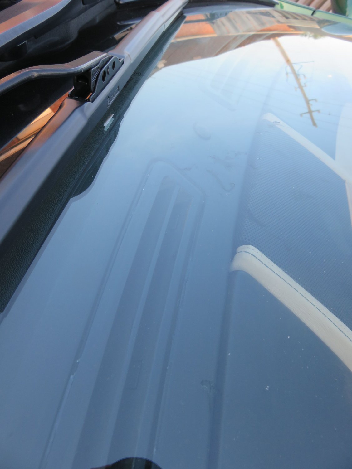

Gary's wife here... I just saw that the below "repair" was made to the defroster vents. This is absolutely ridiculous.
Old Jul 24, 2018 | 07:15 PM
Alien32's Avatar
Joined: Apr 2018
Posts: 32
From: Houston
Alien32 has much to be proud ofAlien32 has much to be proud ofAlien32 has much to be proud ofAlien32 has much to be proud ofAlien32 has much to be proud ofAlien32 has much to be proud ofAlien32 has much to be proud ofAlien32 has much to be proud ofAlien32 has much to be proud of
Oops... Guess I was still logged on. Unhappy wife to say the least.
Originally Posted by brightoncorgi
YAM PPI's should find more than you bargained for IMO. This is how they drum up service if needed on the car.
I should have taken the suggestions and avoided Star Motor Cars all together for anything other than the recall work. What a mess.
They performed the recall, the PPI, and reattched the defrost vents that were bowing due to heat damage. I did get a copy of the checklist only after asking for a copy. Daniel, the service advisor, was fine to deal with; zero issues with him. Going over the checked boxes, I asked if they transmission cooler lines had previously been replaced as per a service bulletin. He was unsure, but said they were not leaking at the current time. There was nothing noted about the on/off throttle pull, so I asked if he had a moment for a quick test drive. He obliged, and off we went with him in the drivers seat. The tires made the skipping noise pulling out of the parking lot. I asked, "Is that normal?" "Yeah". Ok, I'll buy that. Fairly quickly down the road, he could feel the pull to the right on throttle, left off throttle. Upon pulling back to the dealer, I asked him to see if the headlights moved when I turned them on, then turned the car on. While difficult to see in the bright daylight, he noted they did not adjust. We go inside, and Mike Dowty the service manager is summoned.
I started off with asking Mike if the headlights, being HID, were supposed to go through their motions (up, down, level) when turned on. He said they only do this once, then it take a while (hours) before they do it again. That's unlike any other car I've owned, but he maintained the headlights were working as designed. I moved onto the pull, and he noted that his tech did not report any issues with it driving, stating it drove in a straight line (hands off the wheel) and braked in a straight line (hands off the wheel). I asked Daniel to confirm that it pulled with him driving when transitioning to on throttle and transitioning to off throttle, and he confirmed. Mike noted my tires are aging, and the pull could be cause by that. When I pressed Mike to test drive the car, he stated he was too busy. He did offer to do an alignment for $500+ but "that wouldn't make me happy". What I could not get through to him was the fact that according to their inspection of the car, everything was normal, when clearly it is not. I just wanted them to put in writing, such as something is wrong with the steering, requires further investigation/additional charge. But even with the service advisor saying something is not right, Mike would not admit something was wrong, nor have the time to see for himself. I could understand if I were complaining about them not finding a small scratch, but the headlights not working? Isn't that, you know, a SAFETY issue? I knew I wasn't getting anywhere with Mike, so paid my tab and left.
To add insult to injury, after leaving, I noticed a bunch of smudge marks/glue/black goo on the base of the windshield. Yup, they didn't even bother to clean up after gluing the vents down. I'm not saying I could have done a better job being it's such a tight confine, but the marks left on the windshield is plain laziness. Trying to take pictures though it's tough to capture, but very obvious in person. And another kicker, looking at the checklist again now, lines 101 thru 121 are not checked. Those JUST SO happen to be under Road Test/Performance and Post Road Test.
Bottom line. If this is the sort of quality to expect from Star Motor Cars, I'd run far and fast before buying any of their 'certified' cars.

I've not driven the car at night since my first night of ownership. So tonight, after spending 45 minutes cleaning bits of silicon on the windshield, we took it out for a brief run to find a dark place with a wall (or a dark flat street). Did a quick and dirty check against the garage first. Driveway has about a 1° slope.
22in on the left, 21in on the right.
25ft away, 11in left, maybe 3in on the right.
Found a dark street with less than .5° slope. I'm standing at 40ft where the cutoff is.
60ft
60ft. My wife wearing blue pants and a flowery top. According to Mike Dowty at Star Motor Cars, these headlights are working as designed. Where's that gif of Iceman in Top Gun?
