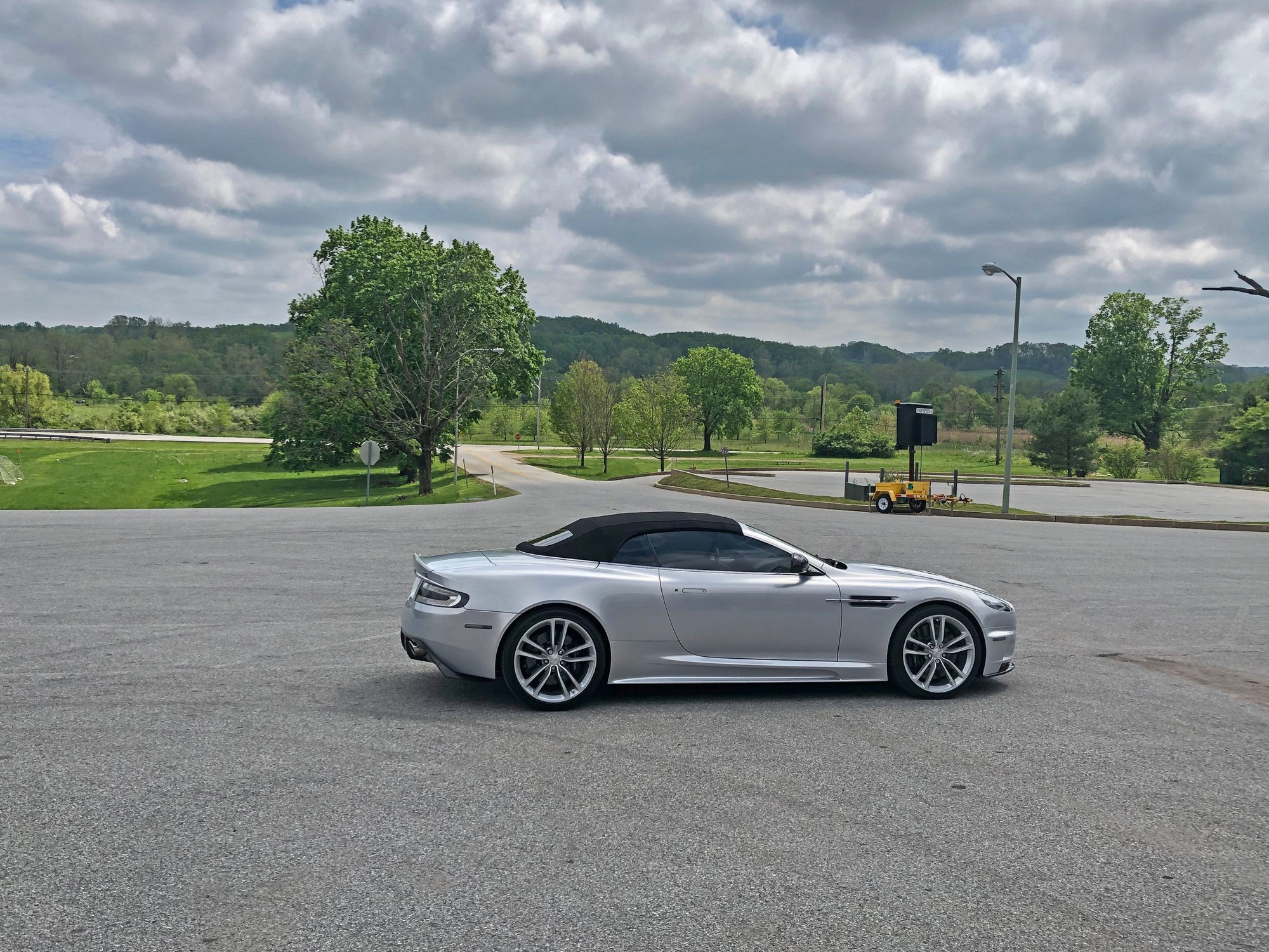

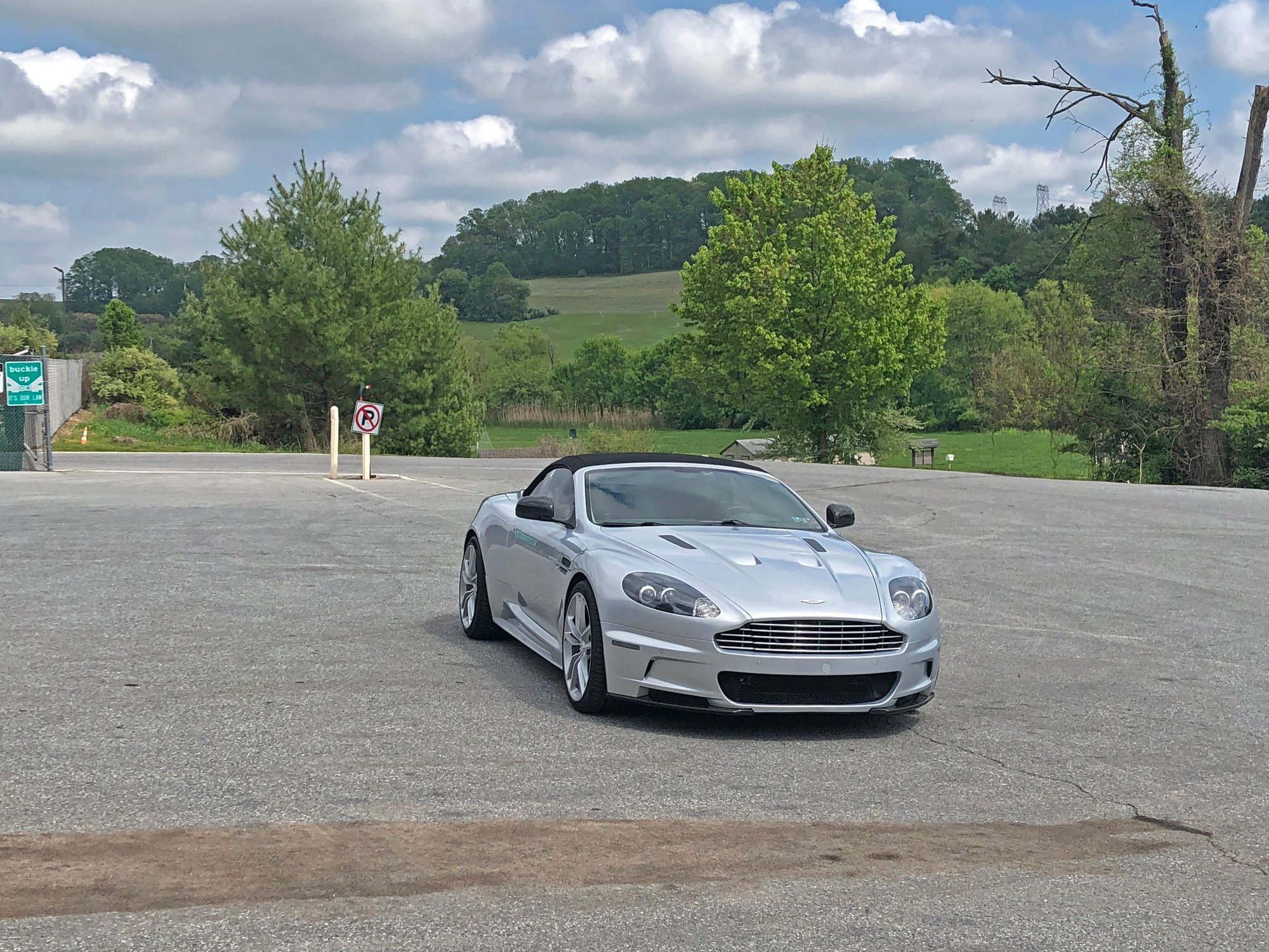

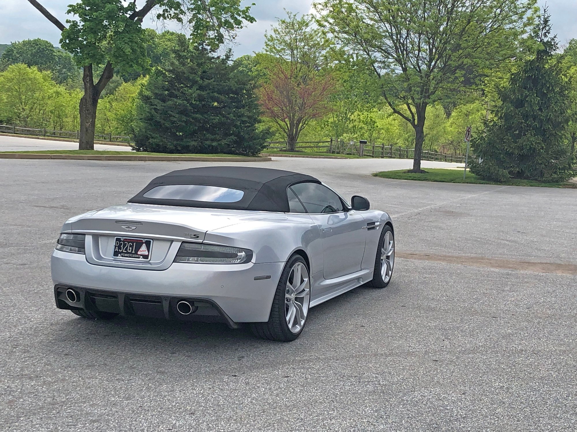

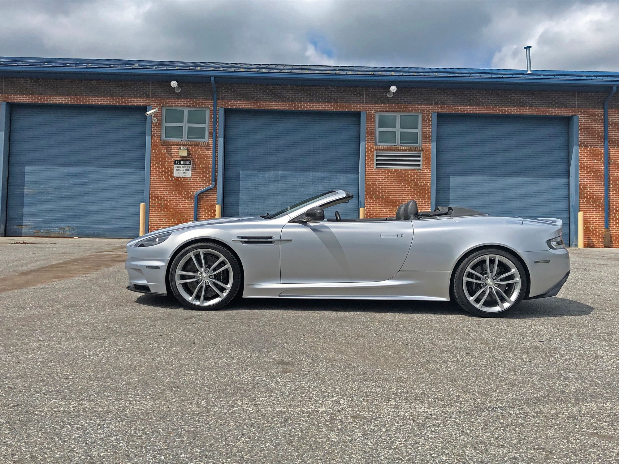

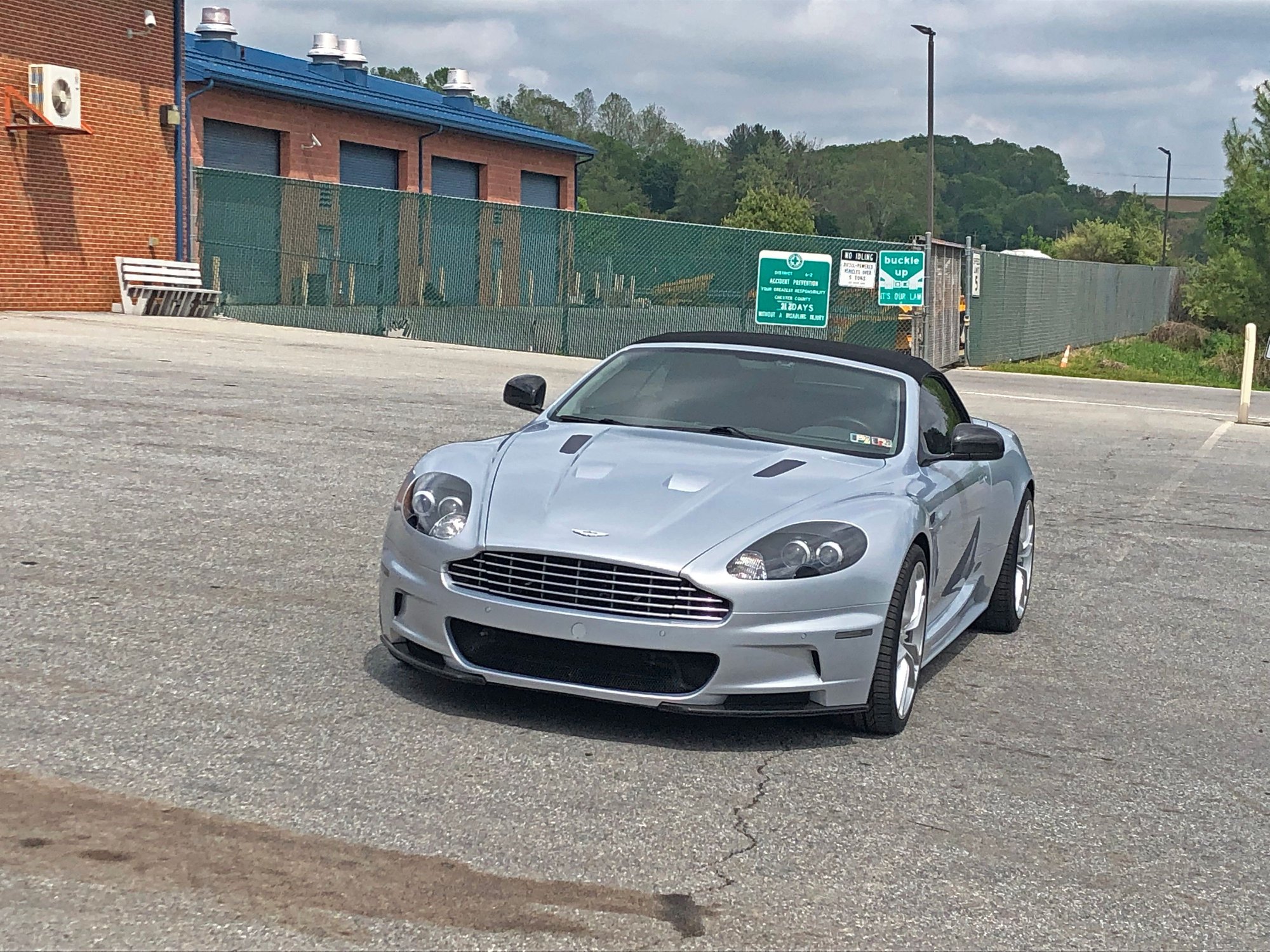

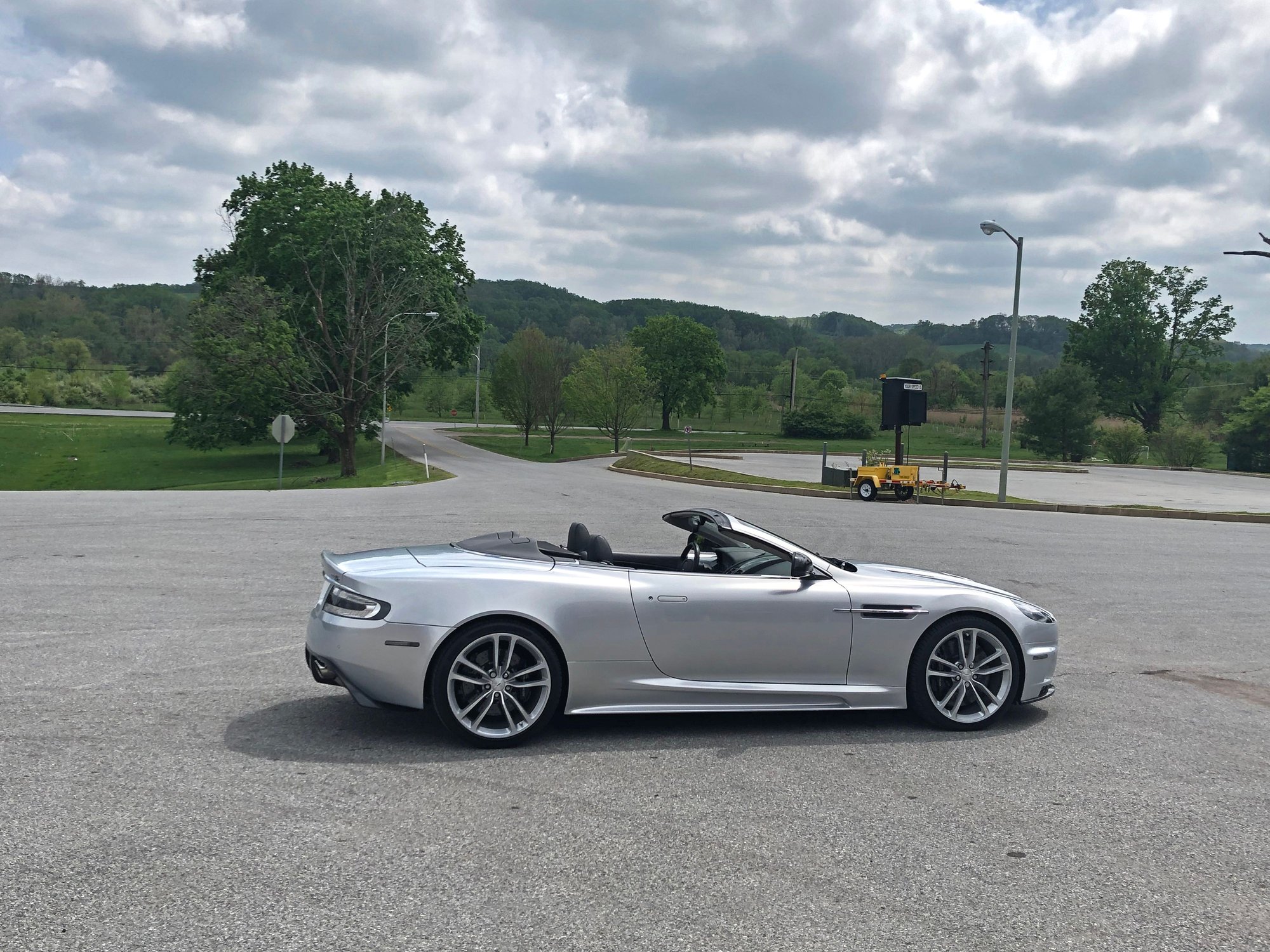

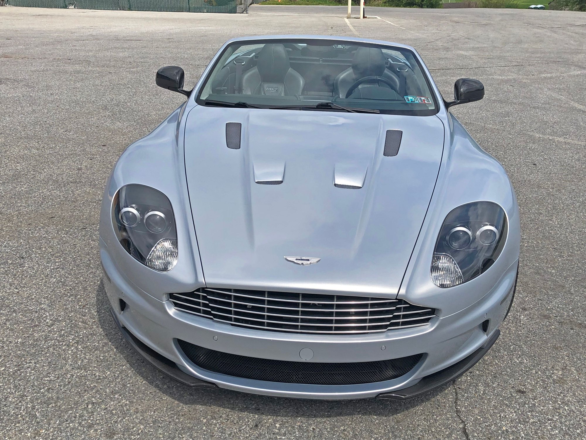

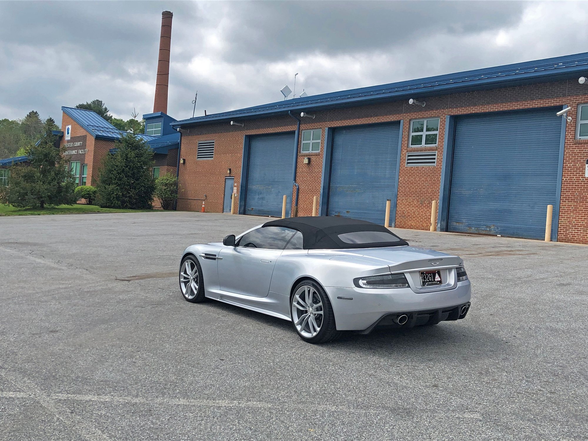

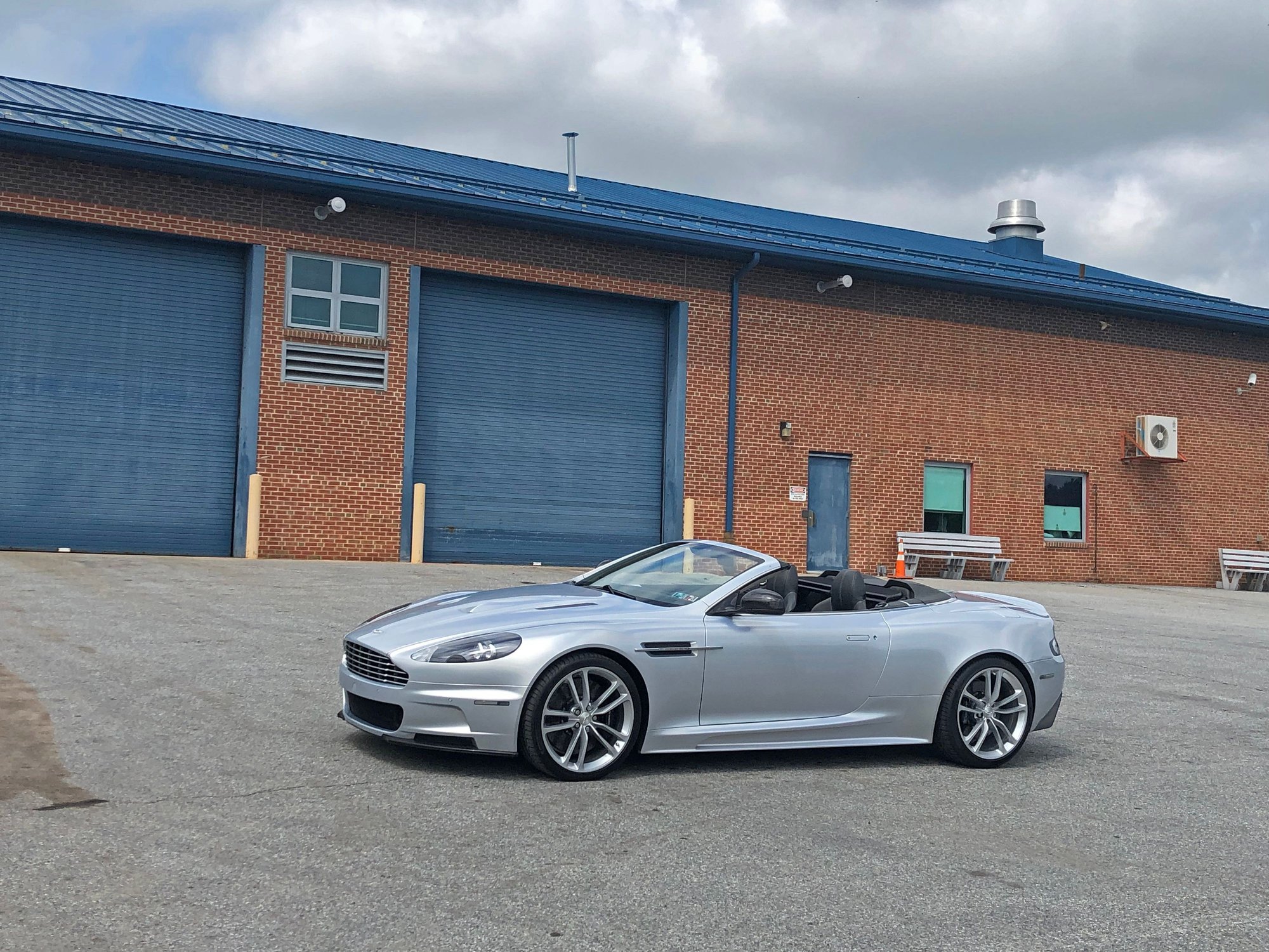

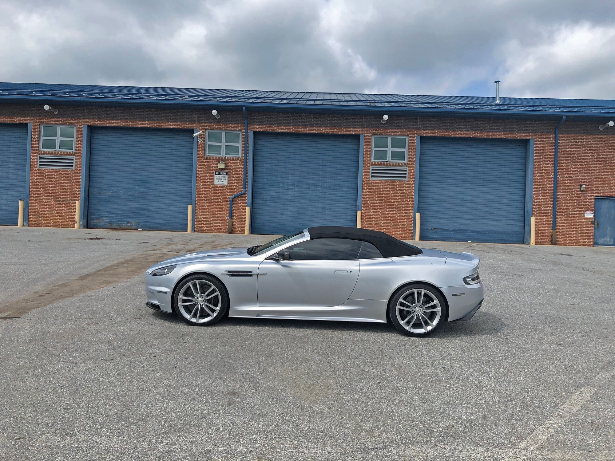

Velocity AP Lowering Springs, Scrape Armor, & Adaptec 20mm F&R spacers:
The 20mm spacers really made the car look much more aggressive. I do have 11mm H&R spacers I’m considering putting on the front as I think the front wheels are out maybe just a hair too much.
As for the springs, the ride quality feels like stock, so all good there. I was thinking there would be a little more of a drop compared to stock as you can see from the below pictures. If I had it over again I may have skipped the springs since I didn’t feel the difference is noticeable enough and there’s still some wheel gap, maybe Stuart can chime in if the car looks like it should. Since the front subframe came down for the headers and the springs were installed an alignment was done to bring it back to factory spec. The Scrape Armor gives some added protection (purchased in anticipation of the car being significantly lower) and you can’t tell its installed unless you’re looking under the car.

That looks fantastic. I love the spacers although I agree the front ones stick out a little too much and wouldn't pass the MOT where I live.
How easy was it to change your headlight bulbs? I understand the units are not easy to remove but once you did, are they easy to dismantle to access the bulbs and any problems after you put it back together?

While I didn’t do the install it’s my understanding that both the high beam bulbs and the turn signal bulbs can be accessed once you remove the wheel well liners and air boxes. Should be fairly straight forward...
