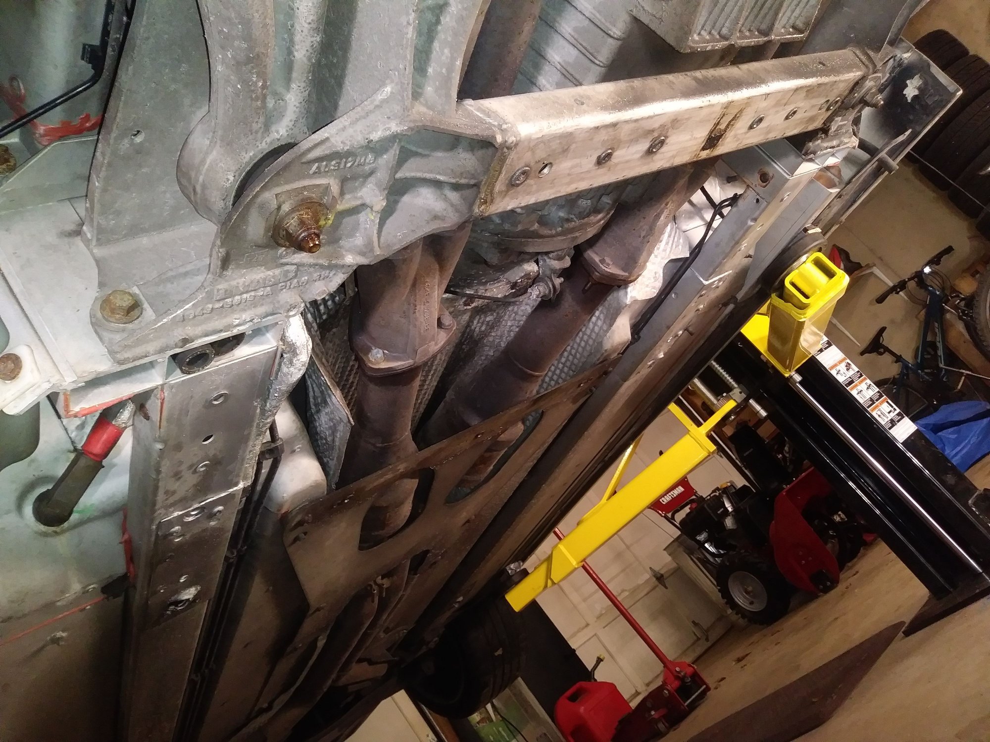

I went down and took another look. While it would be possible to hold the engine, and unbolt the lower K Frame. that almost looks like more work than dropping the whole engine... Most of what is removed when raising the body is attached to the K Frame, and would need to be unbolted.
Some photos from below my DB9 looking up...
front of motor - note steering gear and sway bar
RHS looking back to where the K frame mounts to subframe.
