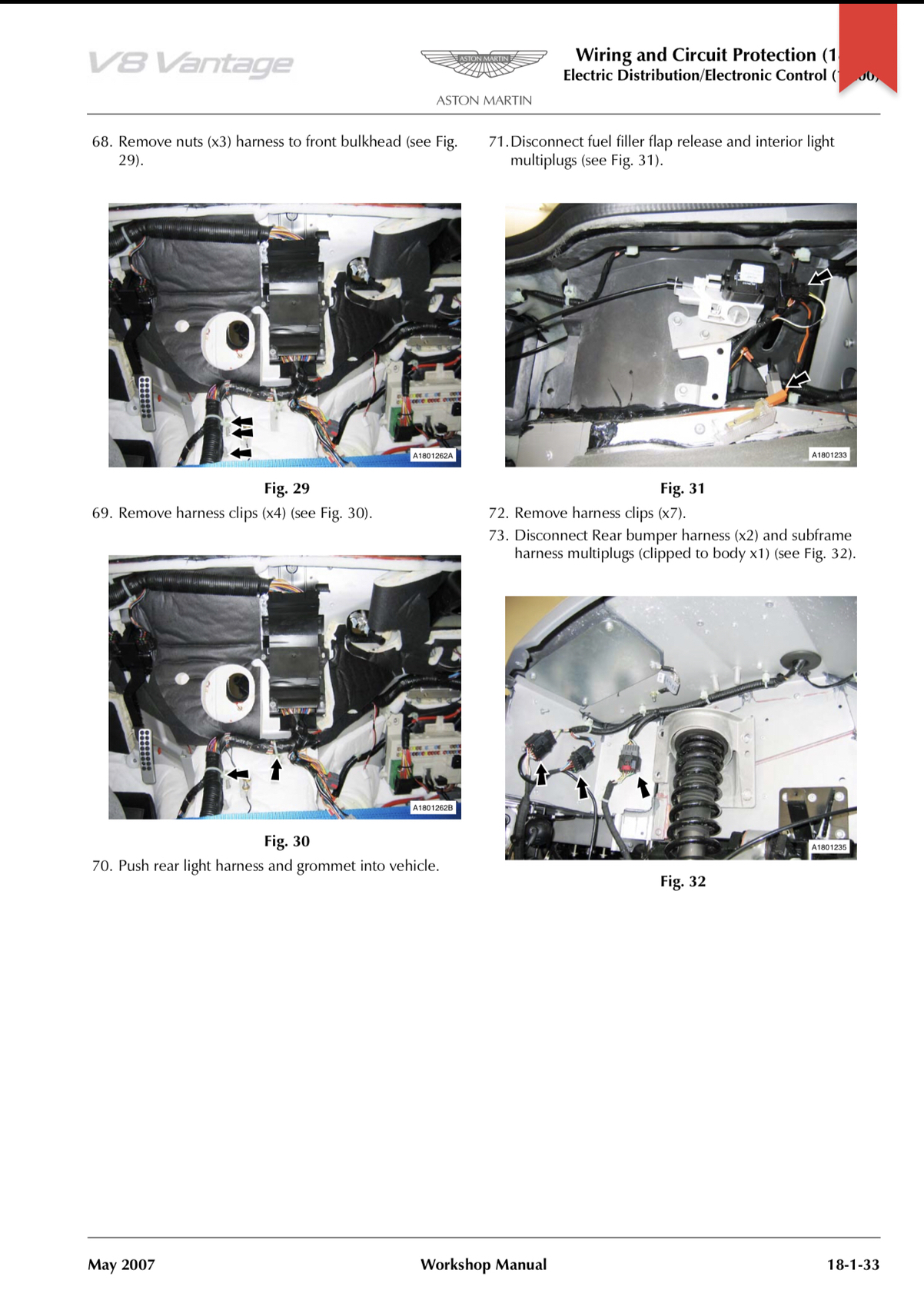

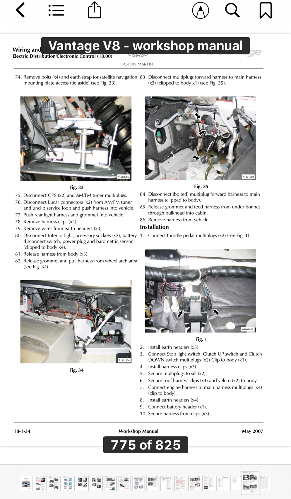

It appears it is based on this picture from workshop manual. For visual see fig 33. Are you following the orange fiber optic cables?
PM me with your email and I can send the workshop manual to you if you don't already have it.

Those pictures are of a coupe
I am going to speak to my Aston dealer tomorrow or maybe just tear down the battery area
Either way will post pictures to help other members when i get ontop of this

Also on my car the Navigation Drive is positioned under the roof storage panel so the only time it is visible is during roof openning or closing sequence
I found a workshop manuel online seems to be official item
But what it doesnt do is distinguish between different models pretty rubbish really
