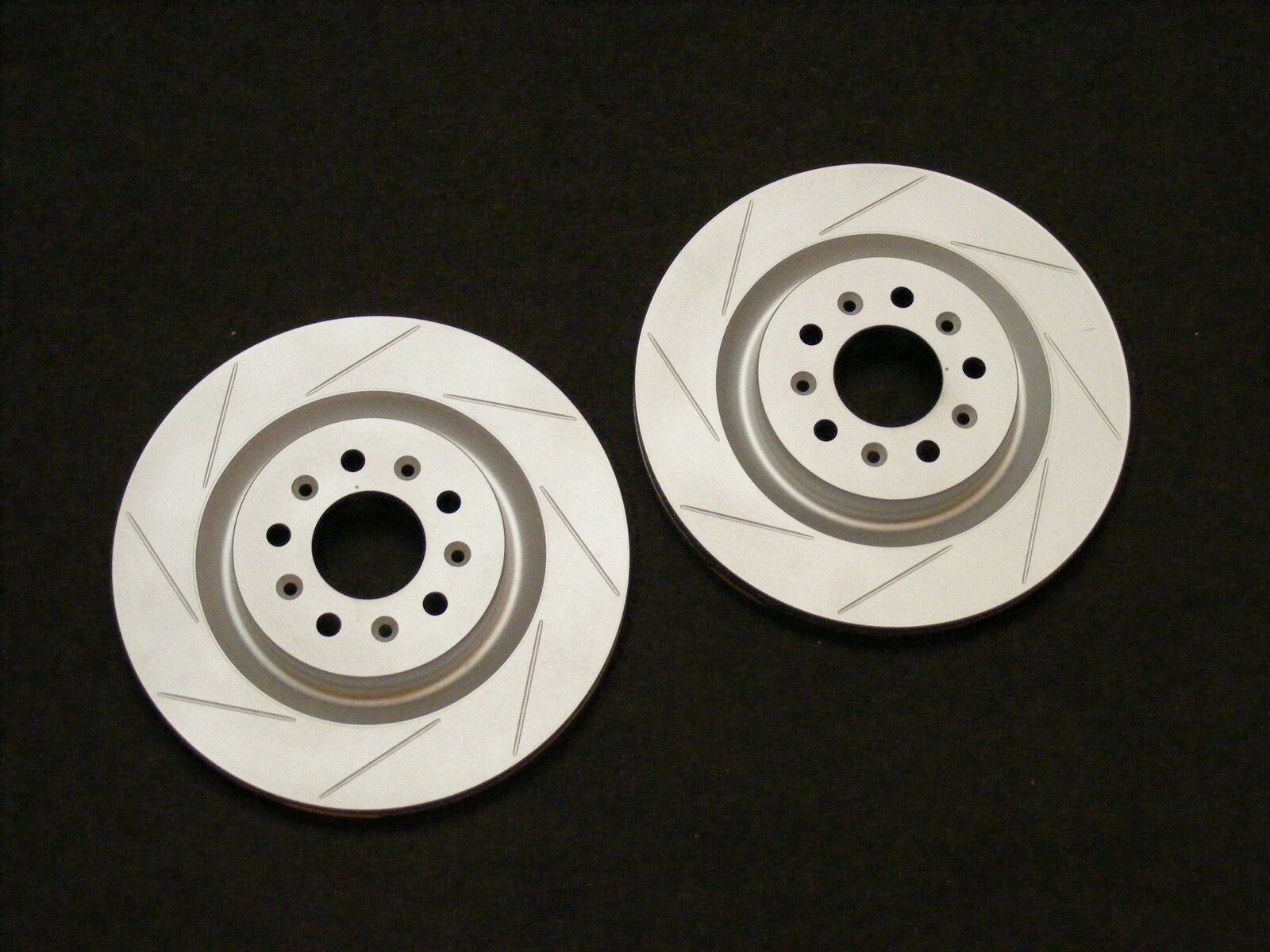

The 4 pots had 355mm discs that are 1 piece. Solid metal all the way out from the centre to the rotor face. (sorry these are pics of rear but look very similar.)
The 6 pots are 380mm discs that are 2 piece or Bimetal (1.5 piece.) Both of these have either fasteners or holes on the surface between the centres and rotor face.

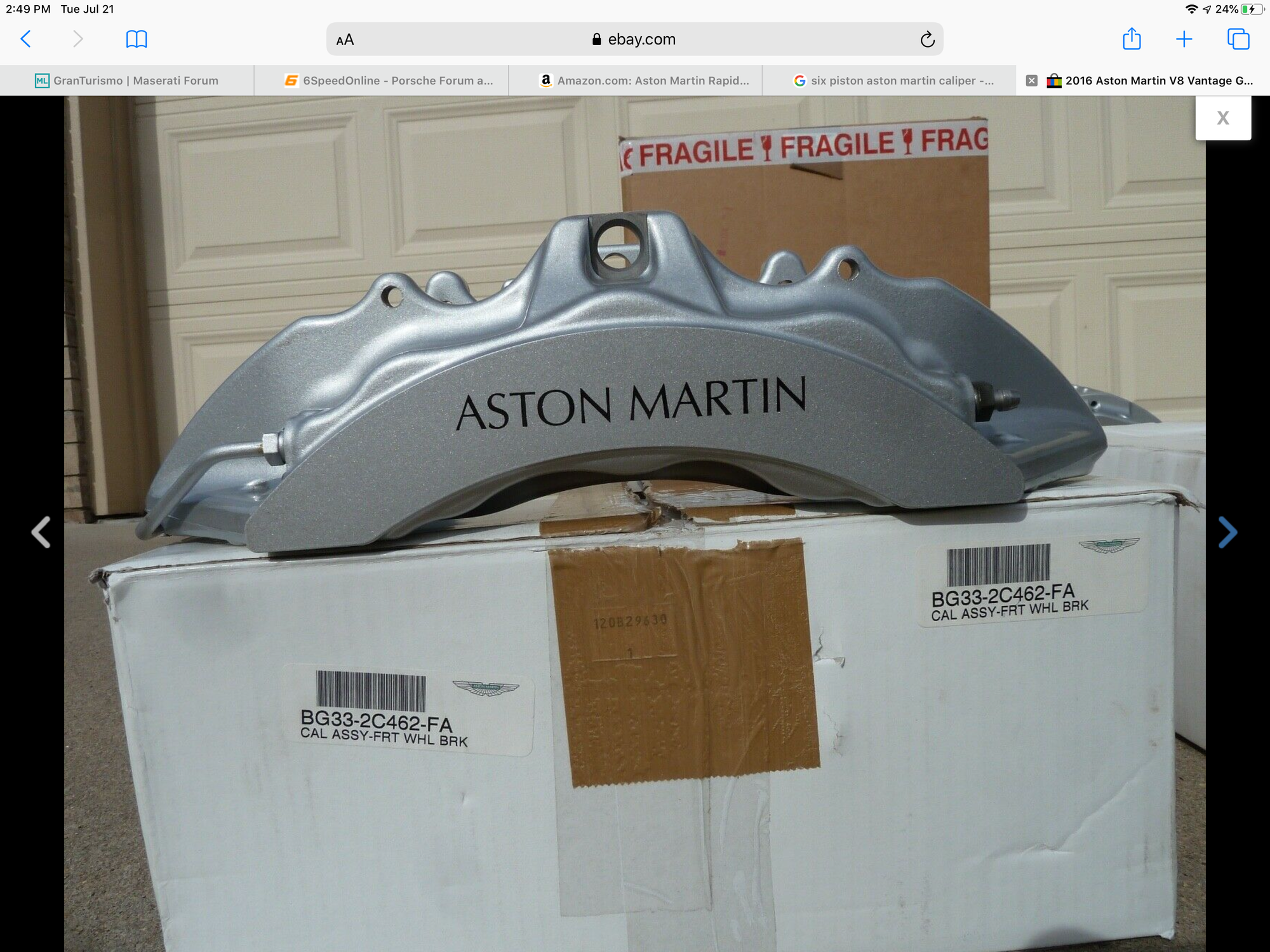

2012 V8V has six pistons on the front... you see 3 round grooves on the calipers. 3x3...You gotta make sure you get the RIGHT pad.. Rapide’s has the same front calipers as a V8V.
This is what a six piston pad looks like for the vantage: NOTICE THE “HOOKS” ... match this pic to your caliper.

Dealers..... He/she is describing 4 vs. 6 piston caliper/rotor size “feel”.... they all are Brembo brake calipers. 4 or 6 pistons depending on model of AM. Its the same six piston on Maserati’s. EBC makes the most pads... couldn’t find the right EBC yellow pad for the six piston.
The problem when searching for six piston pads is most sites really dont show the actual pad so most will get confused and trust the site but get delivered 4 piston pads because the website “assumed” you had 4 pistons on the front... if you look on ebay, you can see folks selling calipers and pads and you will be able to see “real” pics of the items to compare to your car.
I bought those Rapide pads and they are a direct fit on AM V8V six piston calipers...

Completely different sized calipers. You either have these (4 pots)
or the ones above are the 6 pots.
