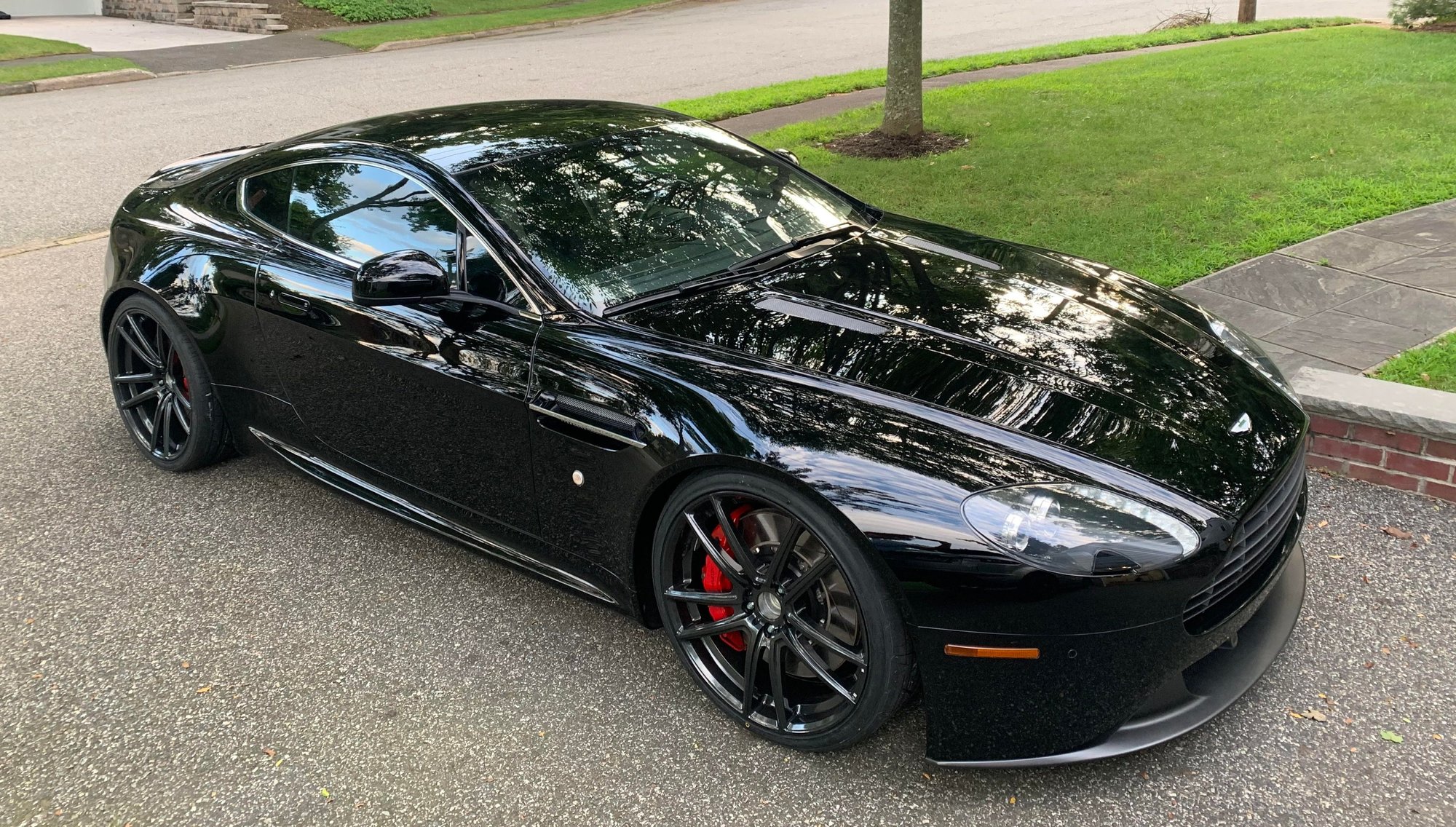

Right off the bat, I came across a great deal on some brand new ADV1 wheels, and figured I'd get right to some modding and lower on H&R springs. The ADV1's are on Nitto Invo 255/30/20, and 305/25/20 rear. The rear ride height is still slightly too tall, but before messing with the adjustable perches which I believe we have, I'll let the springs settle.
A quick snap for now. I still have not installed the center caps, as I'm currently polishing those myself to a high shine to match the rest of the chrome on the car. They came in a powdercoated red, but those are not suitable for my taste.

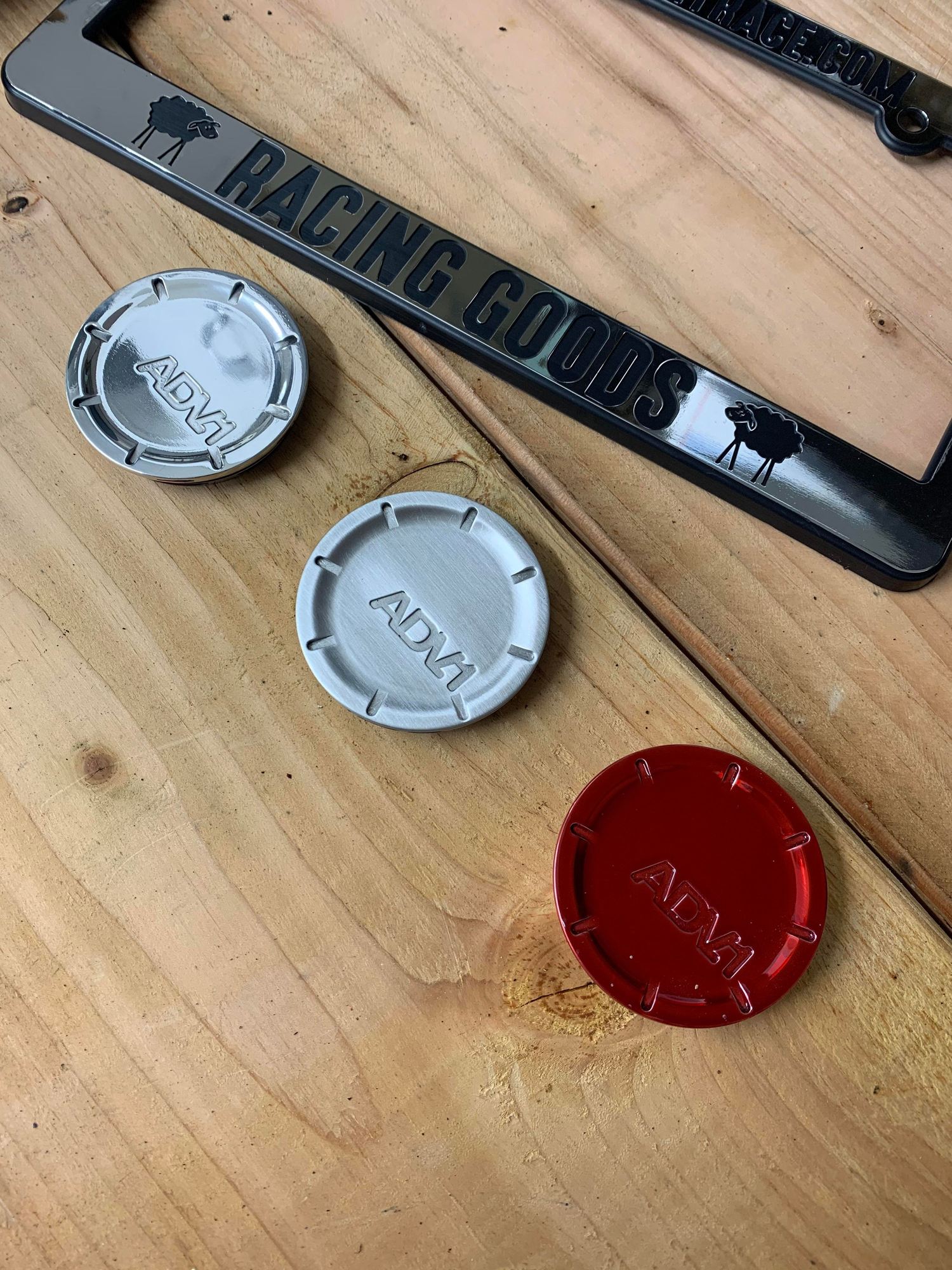

Wheel center caps I'm working on. Came in red, debated brushed, but ultimately, going to strip the red powder coat, and polish all to a high shine.

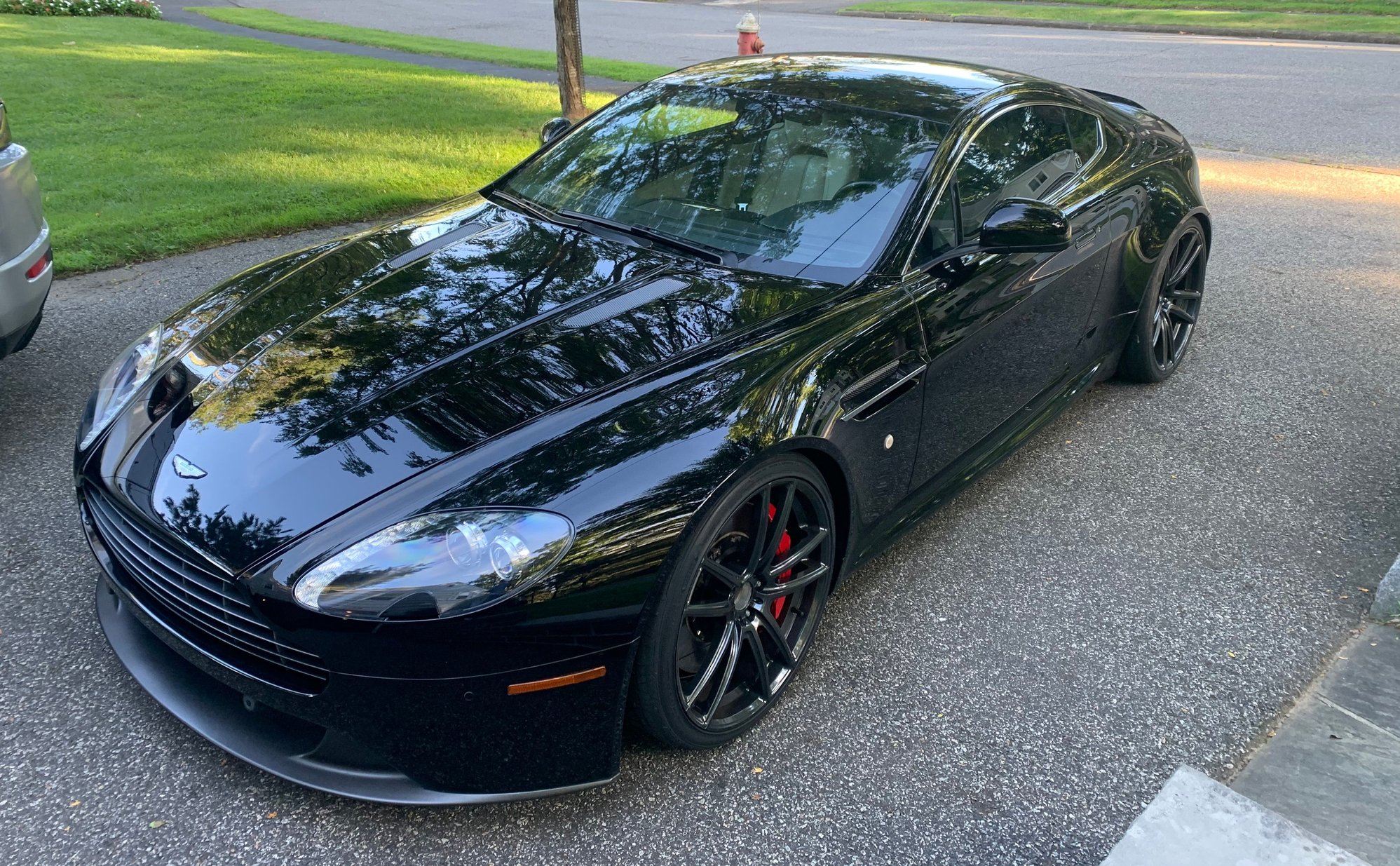

So, as indicated on other threads, our cars have adjustable rear spring perches. Adjusting them is actually incredibly easy by sliding the o-ring / clip into the lower groove. By doing so, got the rear ride height to what I find to be acceptable now. It was just too tall before. So happy with this now.

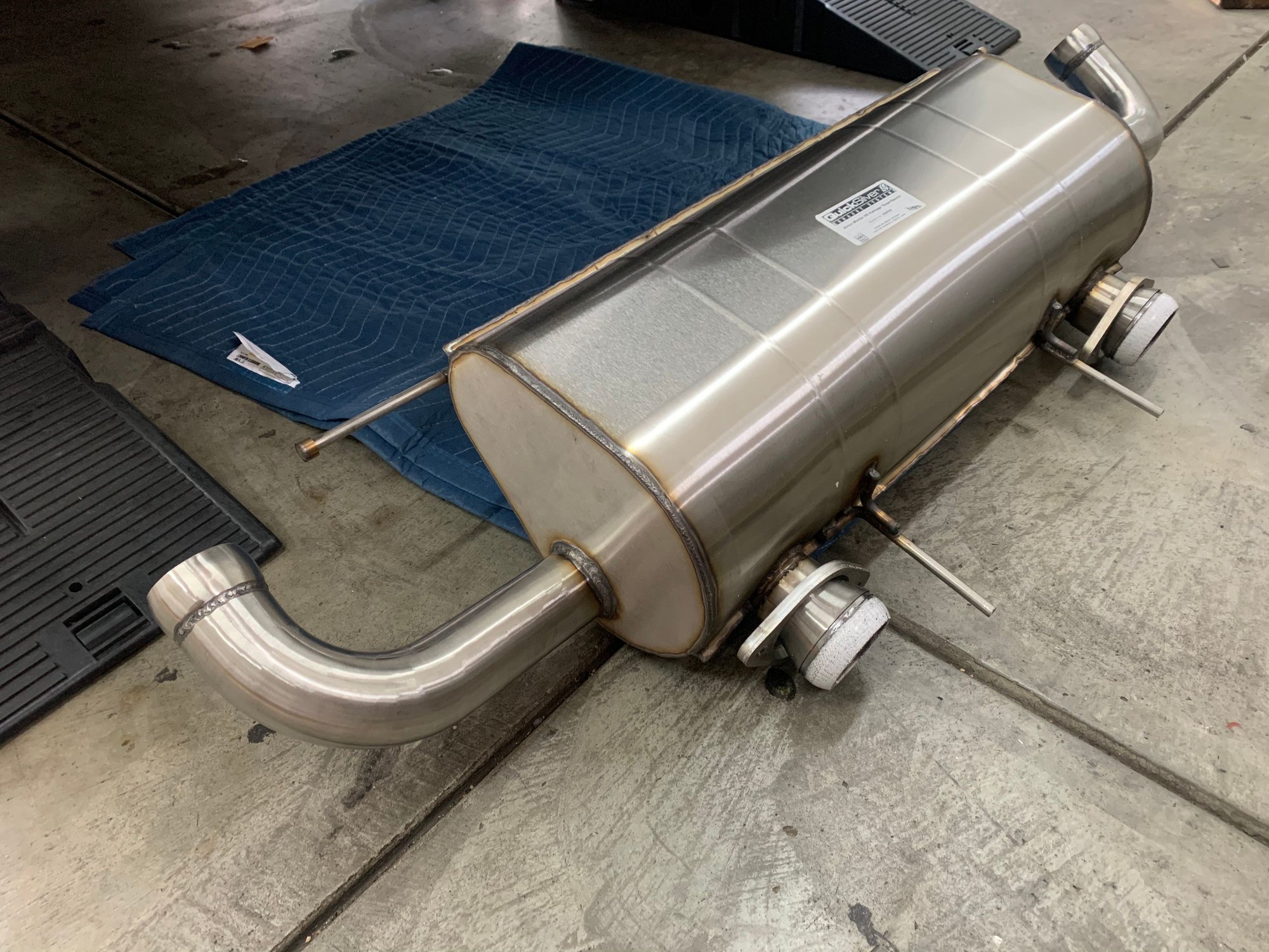

After a decent amount of exhaust research, I decided to finally pull the trigger on a rear muffler section so I picked up a Quicksilver SuperSport and installed it last night. I somewhat like that Quicksilver only focuses on British cars, and I can attest to the very high build quality of the unit. I believe the weight savings are roughly 20 lbs.

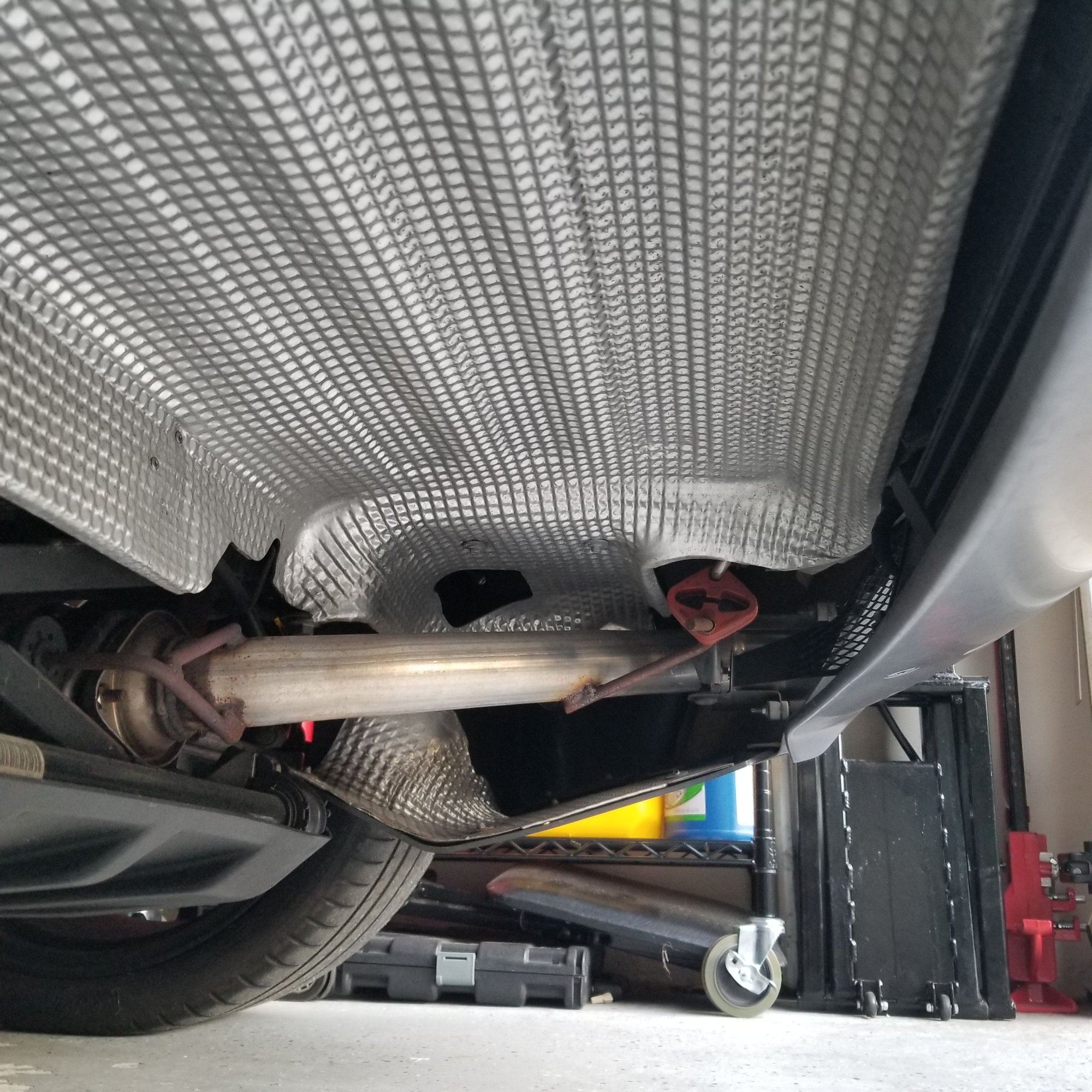

I also started the car and revved a bit with the muffler removed to hear what the GT4 pipes would sound like. In my opinion, it detracts from the Aston Martin "experience". I found that while the tone and volume were acceptable, there was a fair bit of drone and too much resonance within the cabin and that sort of experience just doesn't work for a car like this.
With the Quicksilver SuperSport installed, there is a complete lack of drone which I'm thrilled about. While the exhaust volume has increased considerably, it's still very fitting to Aston Martin's character in my opinion. Down the road, I might experiment with some resonator delete pipes as well.
