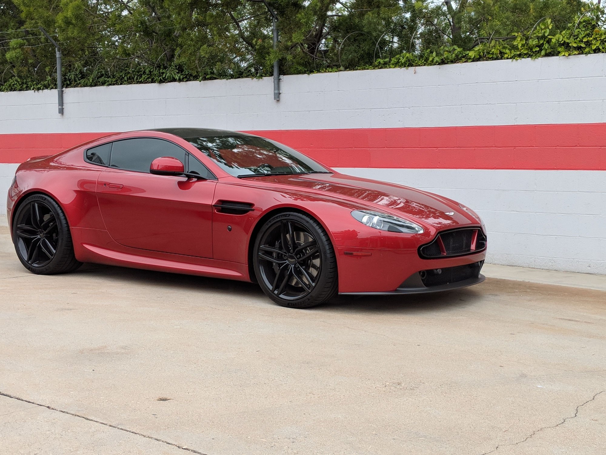

I bought a 2011 V8 Vantage S this past summer and it rides a little stiffer around town than I'd like it to be. Sorry, I've tried searching for suspension info and haven't really found clear answers anywhere.
Does the S have a stiffer suspension than than the base Vantage? Is the S suspension the same as the Sport pack?
Would changing to the base suspension given me what I'm looking for (smoother ride around town)? What components would need to be changed?
Would putting in something like Bamford Rose's adjustable suspension give me the best of both worlds? (or would that be what I have now, and stiffer?) I assume retrofitting the V12VS adaptive suspension isn't really an option.
Thanks for the help. Here's a picture of my car as partial payment...
