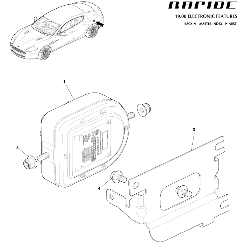

There are 2 updated model of the part # for the Rapide (same for other cars of the same type): with ( 9G43-37-11094 ) or without ( 9G43-37-11093 ) inclination sensor. Up to you which one you want to install. but they are generally described as FoMoCo 6G9N-19G229.
They are generally the same. The Previous part # was 4G43-37-10246
If you do a lookup for your VIN, you will see whether you need the "High Spec Alarm" (inclination sensor) or not.
I used the non-inclination sensor equipped version. I don't think Scuderia shows a inclination equipped version for the Rapide.

That's because Scuderia doesn't have the parts description to all the models after a certain year, nor does it always have the 'updated' part #. Mine has the inclination model , listed as "High Spec Alarm" when I looked up the VIN.
But I can assure you there are indeed 2 types of sensors for the Rapide depending on the year.
