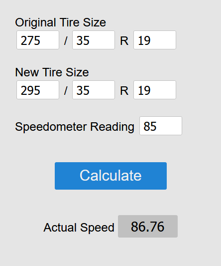

How far off is your speedometer calibration with the 255's and 295's on the car?

.6'' More Rear, Doubt Any, Maybe 1-3?
Stock Potenza's:
Front 140 A A 1,565 lbs 50 psi 11/32" 27 lbs 8-9.5" 8.5" 9.5" 8.2" 26.4"
JP 275/35R19
100Y XL
TPC Spec
Rear 140 A A 1,764 lbs 50 psi 10/32" 30 lbs 9-11" 9.5" 10.9" 10.5" 26.5"
JP View Specs for All Sizes act our sales specialists at 888-353-5082 or via email.
Michelin SS's:
255/35ZR19
(96Y) XL
MO Mercedes 300 AA A 1,565 lbs 50 psi 10/32" 24 lbs 8.5-10" 9" 10.2" 9.2" 26" 799 FR 295/35ZR19
(104Y) XL
MO Mercedes 300 AA A 1,984 lbs 50 psi 10/32" 28 lbs 10-11.5" 10.5" 11.9" 10.3" 27.1" 767 FR

Not Even 2mph at 85......
https://tiresize.com/speedometer-calibration/

In that case I think I will go with the 255/295 setup, since I like the look of a wider tire. But I'm going to use a 40 series sidewall on the front instead of a 35. They'll end up the exact same circumference as the rears that way.
I've been doing a lot of independent research on other sites and decided to go with the Michelin PS4S's over the Continentals. Thanks for all the replies and opinions, folks!

I thought about that, But think it's a Little too Tall for Front & You'll get a gap in Back rather than front, I measured Everywhere & think the Stance is Perfect with mine. But I still want Stock Suspension(for now)
Put up pics when Done.
Coming from a Pretty long Porsche background (sell Air-Cooled for a Living) I had Many Water cooled, I always set up a slightly Taller in Rear, just my Preference, Points the Car just slightly down.
