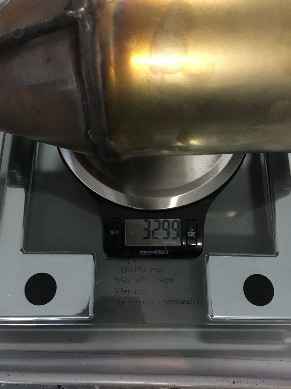

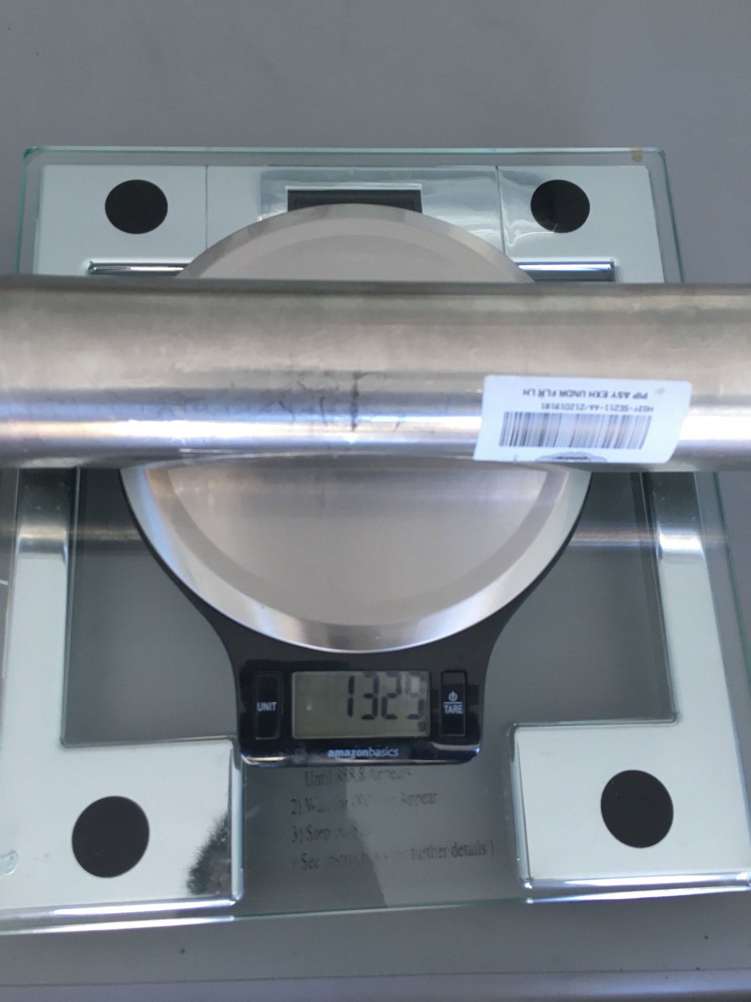

Here's my pre-post secondary cat swap for 200 (they might be 100) cell cats:

Originally Posted by Dalecannavan
​​​​​Amazing engine note, major difference
