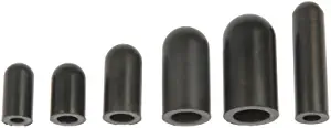

Did you drain the brake system or block the lines while the calipers were off?
Old Mar 8, 2021 | 12:43 PM
Julioz32's Avatar
Joined: Jun 2019
Posts: 37
From: Freehold
Rep Power: 8
Julioz32 is infamous around these parts
blocked with snug vacuum caps on brake lines flare. Do not allow fluid to go below min level in the fluid reservoir.
