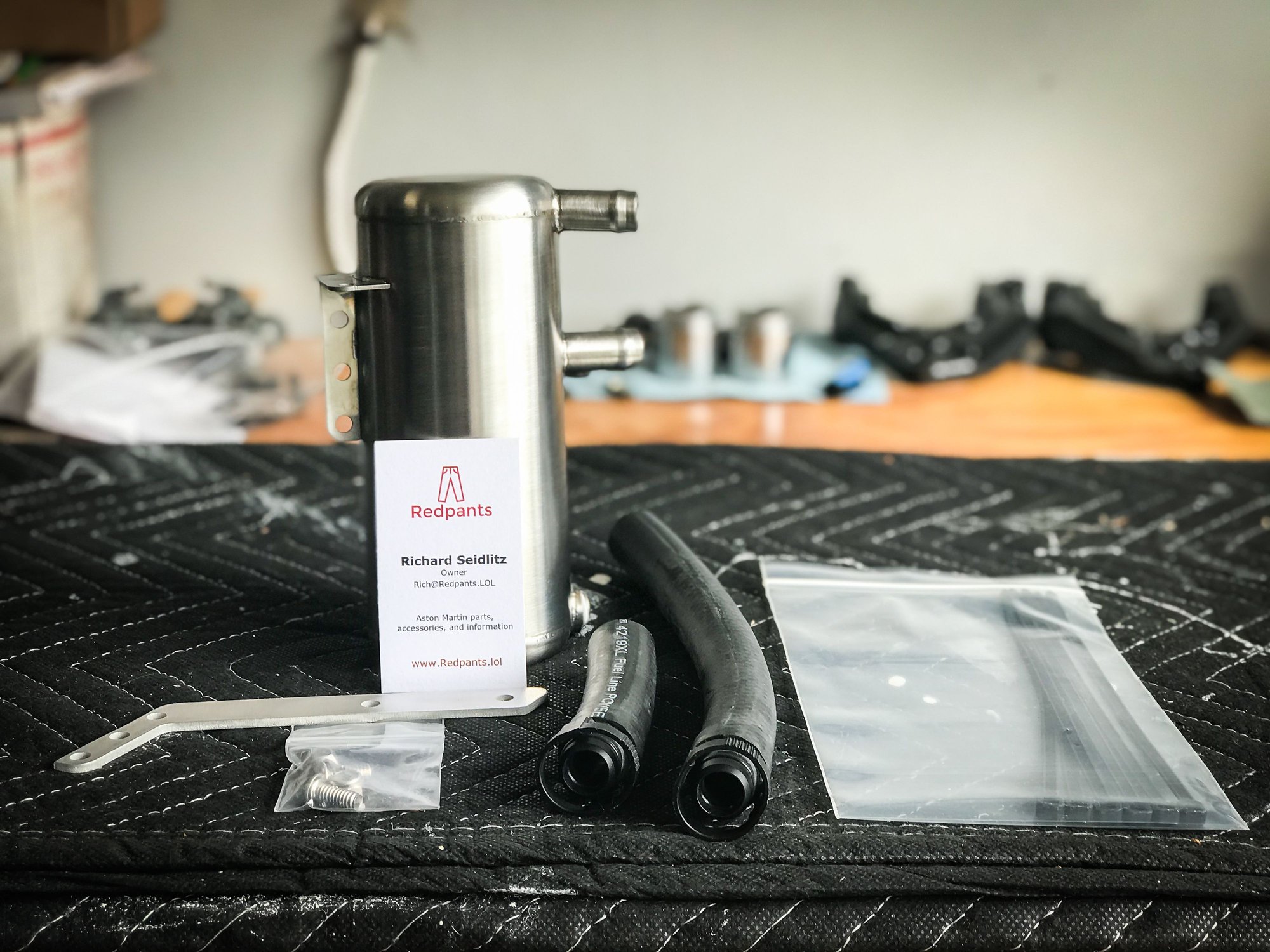

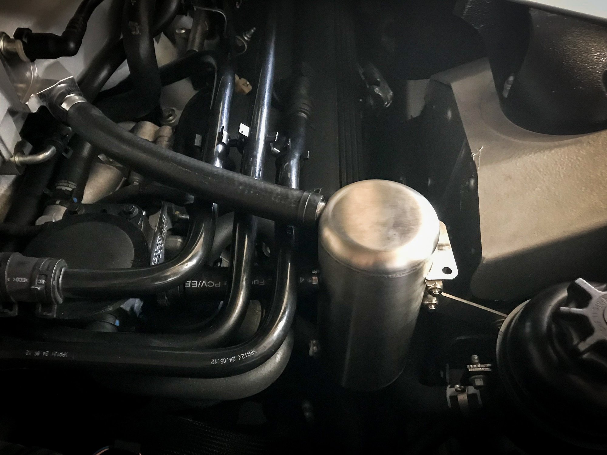

Hey guys,
Just got around to installing an Air Oil Separator (AOS) Oil Catch Can into my 2013 V8V. Rich from redpants.lol supply the kits.
Created a quick and dirty how-to and time-lapsed the install.
Very easy installation. Just replace the PCV and intake manifold line with the new supplied lines.
Remove the bolts behind the PS reservoir and use those holes and bolts for the new bracket. (all 8mm)
Line up the new lines and bracket to the catch can bracket and install the final bolt and nuts.
Zip tie the ends on the new lines once everything is lined up.
This will prevent any oil from entering the manifolds.

I installed one on our 2007 V8V a little over 2 years ago. I usually get somewhere a little under 1/2 cup over 4,500 miles. I drain it when I change the oil.
This last time I forgot to drain it during the oil change so this was about 6,000 miles of driving I think
Wow, that is a lot. Imagine that going into your manifolds. Good to know how often to change it. I was planning on changing with my oil change cycle too. I only drive about 3500 so that will work. Thanks for sharing!
