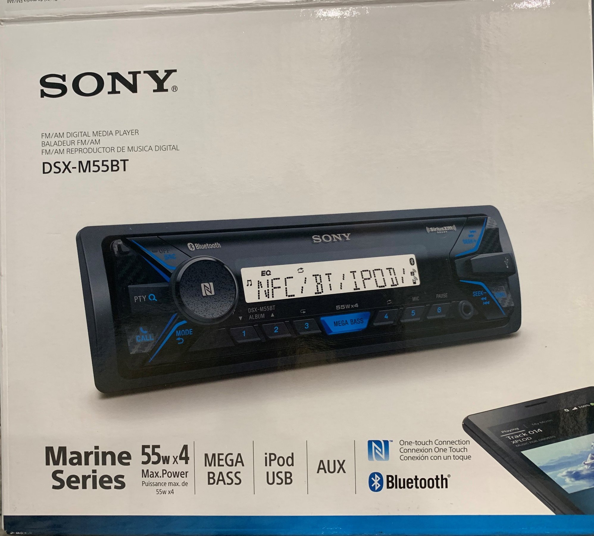

I had the same preference with my recently purchased 2002 DB7, which was equipped with the original Becker unit. My options came down to installing a BT adapter, which had a poor reputation for success, or replacing the unit with a digital media player. In the end, I opted to replace, as I wanted hands-free phone and the ability to stream nav, Sirius/XM and Spotify through the unit. After much consultation with the shop, I went with the Sony DSX-M55BT player. A key attraction was the built-in microphone, which meant a separate mic did not need to be rigged through the A-pillar or the dash. So far the player has worked great, synced with the power antenna and provides good streaming reliability and phone connection. I did not have them connect the CD changer--no plans to use it. While not maintaining the "look" of the '90s Becker, but I use the DB7 regularly, and absolutely want the convenience of BT and phone.
Fit in the slot with no trim or adjustment to the veneer.
Unit was not very expensive, and had all the features I wanted.

That looks like a very clean install, but I believe unfortunately using an aftermarket head unit is not acceptable in the V8V as it would require significant and costly modification to the center console and probably significantly devalue the car. If anybody has successfully installed an aftermarket unit in the V8V, I would love to know it!
Right now, I'm looking for a solution to tap into the stock sound system.
