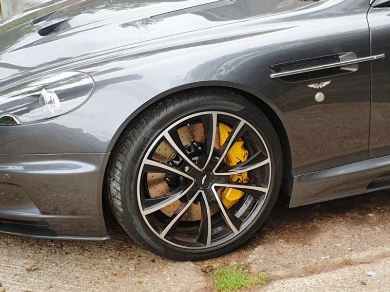

Hi All
Has anyone gone a plus size tyre choice on their AM?
Factory on my DBS is 245/35/20 & 295/30/20 but they look small on the stock rims, literally no rubber past the rim face, almost stretched. They feel hard on factory pressures, possibly the P Zero brand, and I expect a little more rubber to increase rolling diameter slightly will help ride comfort and fatter rears increase grip.
Im thinking of going up a size on front and rear, 255 or 265/35 front and 305/30 on the rear, anyone gone this route?
Thanks
Carl

I have 305/30 on the rear and 255/35 on the front without any problems. Cannot really comment on grip because I swapped from 19" wheels.
Sorry, cannot post pics for some reason, however small I make the files, they all freeze at 90%!!

You can definitely go wider, someone on here ran a 355 rear on their DBS with a 21x13” wheel.
The limiting factor is going to be your wheel width. At 11” you may be able to get up to a 315 on there but might have to lower the sidewall height one series in addition.

Thanks guys.
Those 255 & 305 tyres look like they fit properly not like the 245 & 295 factory spec which look skinny on the rims.
