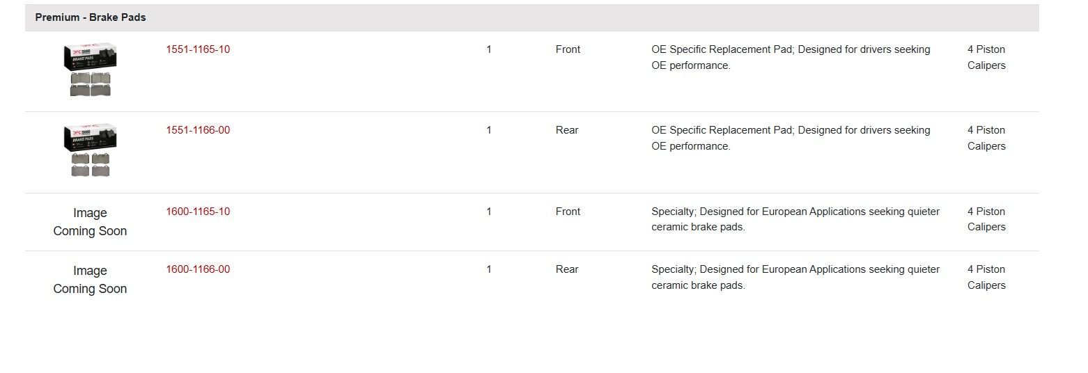

Originally Posted by AAROND81
I haven't found a cross reference, looks like fronts only.
1551-1165-10 Front Pads
Which Dynamic Friction did you get? Their website shows 3 options. I can't find the ceramics in stock anywhere.
There are only 3 distributors - Amazon, eBay & Rockauto.cim.

Mind sharing the part numbers you ordered for the DB11? This is likely a job I will be doing later this year.
Old Jan 28, 2026 | 04:44 AM
  #39
BWings's Avatar
5 Year Member
Joined: Mar 2018
Posts: 1,233
Rep Power: 86
BWings has a reputation beyond reputeBWings has a reputation beyond reputeBWings has a reputation beyond reputeBWings has a reputation beyond reputeBWings has a reputation beyond reputeBWings has a reputation beyond reputeBWings has a reputation beyond reputeBWings has a reputation beyond reputeBWings has a reputation beyond reputeBWings has a reputation beyond reputeBWings has a reputation beyond repute
Yes, no problem
The brake system AM put on the DB11 is the same Brembo systems used on several other cars, but to simplify it I will give you just one model. My recommendation is to use Rock Auto BC the brake pad options for a given car are many. But if you want to just focus on the ceramic low dust pads from Dynamic Friction then I will point to those P/Ns. In my case I actually used PowerStop pads but I believe PS and DF are the same company.
For the rears, DB11 used the same Brembo brake system used on:
Corvette ZR1 (2010 MY). Will be listed on RA as the 6.2L Supercharged
Dynamic Friction pads are p/ns 1115116500 or 1115116501 based on the pad type you want. I used Power Stop Z23-1165 on mine, but again, the DF (with 1165 embedded in the p/n) are same
For the fronts DB11 used the same Brembos as used on:
Corvette 2015-19 Z06
Dynamic Friction pads are p/ns 1115140500 or 1115140501. I used the PS Z26-1405 - again, key to the p/n is the 1405 embedded in the DF p/n
