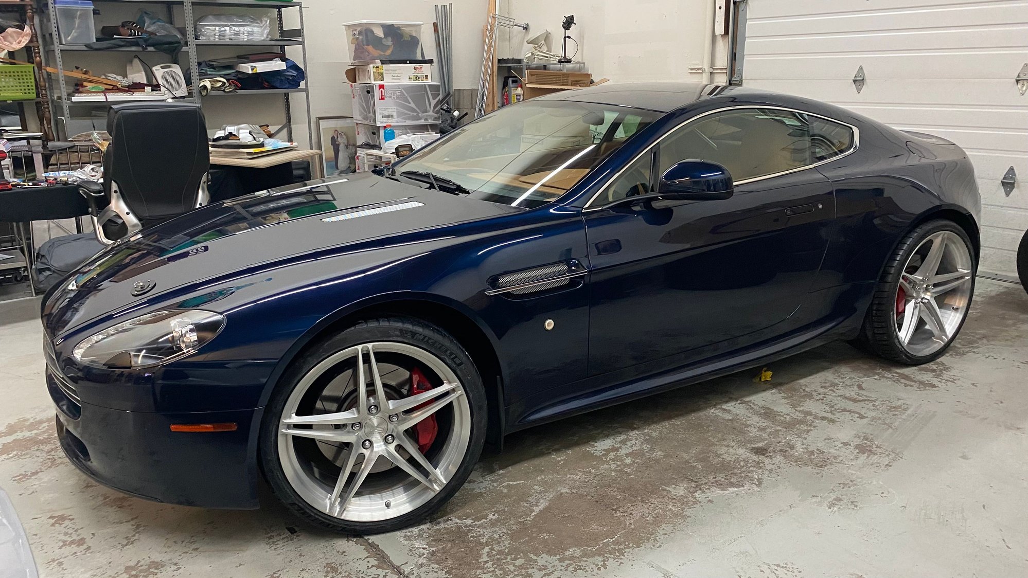

My C8 has 8,000 miles and I've had to clean the brake dust off the wheels maybe twice. Astons need to clean the brake dust off the wheels constantly. Now that I have these new wheels that will be a real pity to muck up (see below), has anyone found pads that are dustless or mostly so?

Unrelated, but I think the wheels suit your car/color really well !!

Yes - I bought the wheels used from this 6speedonline marketplace thinking they were 20" (which I had before), and discovered the rears' were 21" (off a DB9), and they really suit the car well. You never really know what these end up looking like till after installed. They look better in the flesh than in pictures.

Agree…lovely looking car..wheels are sweeeet..I’m following on the pad front..
