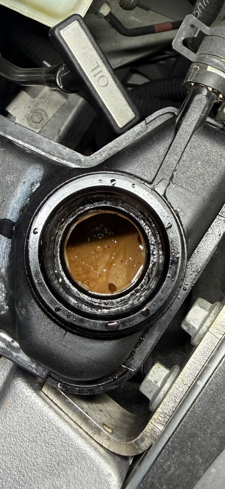

Took my 2018 Vanquish S in for annual maintenance and was surprised that there was oil leaking into the cooling system. The techs could not identify the source of the leak, but best guess is it's a failed oil cooler. The tech did identify the issue as a failed oil cooler. There are no signs of coolant in the oil so that's a relief. The tech suggests a complete overhaul of the cooling system. Has anyone dealt with such a problem? I was surprised to see a similar chocolate shake even after multiple flushes but no driving.
This is what it looked like before it was flushed numerous times
When it was identified pre-flush
After numerous flushes (water and solvent).
Told there were numerous flushes with water and a solvent. This is what it looks like now.

Wow…that’s quite sludgy…good call on the multiple flushes…

Engine oil pressure is higher than coolant pressure, so a cooler failure could make sense at first. Going to be an involved process to find the fault. Either remove the cooler and test it or bypass and keep flushing. Good thing is oil in the coolant can be flushed eventually.

Thanks for the response. Turned out to be the oil cooler.

Glad it has been sorted. Multiple flushes with Dawn and good water it should be good ??
