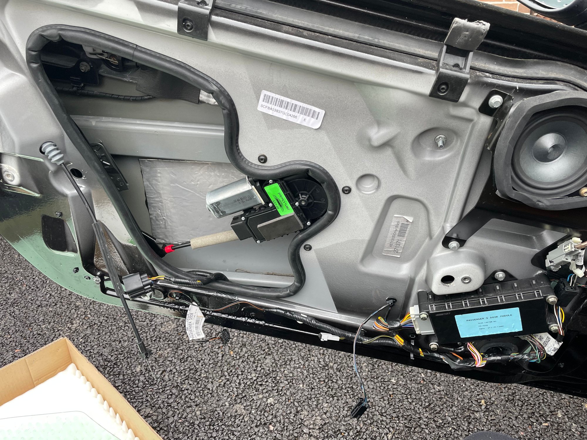

Hi all,
I couldn’t find any help with this online so thought I’d start a thread on my window issue.
I had a problem with the passenger window of my 2007 V8 Vantage where the window was stuttering up and down, and wouldn’t drop/raise properly when the door was opened/closed.
I tried the reset by holding the switch up and down, this didn’t work. I then tried pulling the fuses, that didn’t work either.

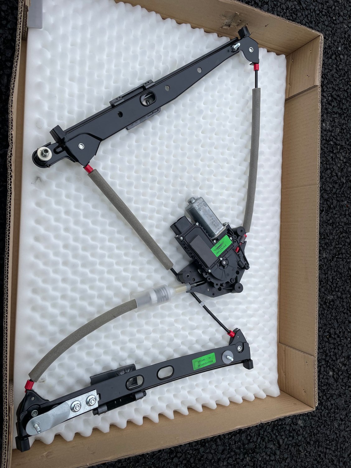

I took a punt and bought a new window regulator for £300.
Four bolts hold the regulator in place, and three torx screws hold the motor in. There are two T25 screws which hold the regulator clips to the glass - these were a bit fiddly through the small access holes, make sure you use a magnetic driver as you don’t want to be fishing screws out of the bottom of the door.
Thankfully this sorted all my window issues.
Hope this helps someone out there!
