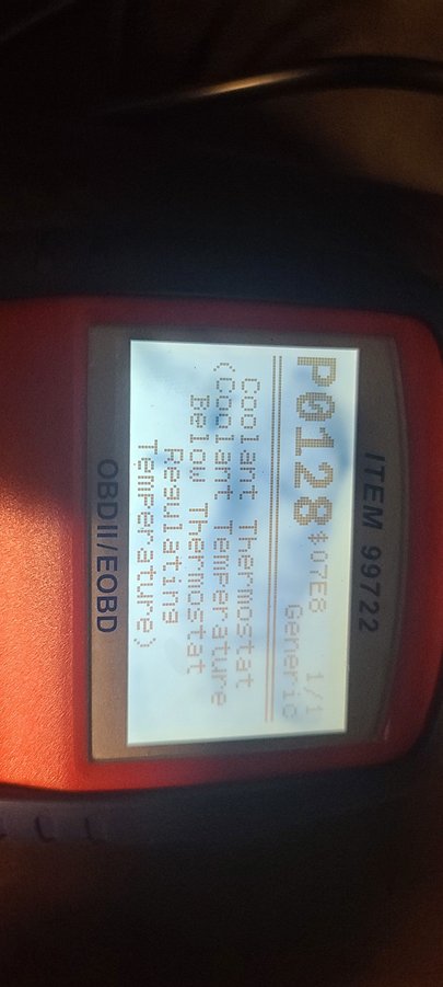

I got a code on my new to me car driving home from work.
OBD code P0128 coolant temperature below thermostat regulating temperature.
Thermostat gasket was roached. Nbd, I hadn't seen it in the cars history so I expected to do it for peace of mind.

Had to replace the one in our 2007 V8V when we purchased it 5 years ago with 28k miles. No codes but the temperature gauge wouldn't get above 1/4. The rubber gasket looked like yours.

06 29k mile v8v
I am not sure it's ever been replaced before. The paint marks on the bolts to the flanges were still aligned. I'm not sure if those are factory or not.

Replaced the one in my 2007 when it was in to have the shifter cables replaced. It had always been slow to come up to temperature, so the shop recommended a new one.

Took my car out from winter and same deal. Temp won’t rise past a quarter. Told the dealer to take a look and they said it’s the thermostat. Asked if it’s common (based on annually seeing it on this forum) and they said nope very rare they hardly see it.
Wonder why they don’t see it yet everyone here seems to.
