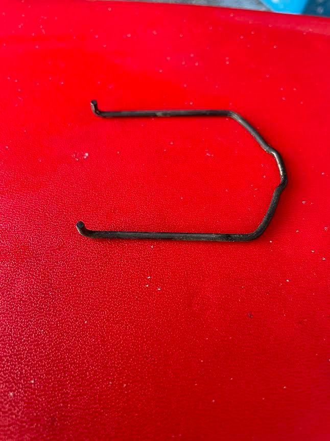

Old Mar 13, 2023 | 08:41 PM
2012Virage's Avatar
Joined: Mar 2023
Posts: 7
2012Virage is infamous around these parts
Originally Posted by V12Virage
Nope. Just a small screwdriver or pliers. There is a captive clip in the solid hose end connector that pulls out a little, freeing the connector. One of the easier AM fittings to deal with, at least in my experience...Of course, the undertray has to come off to get at the hose connection.
Lower hose attached to water pump, note wire clip.
Wire clip that secures lower radiator hose to the water pump, when installed it fits into milled slots in the water pump.

If anyone is wondering for a Vanquish, I just changed the coolant on my 2014 Vanquish this past weekend. The lower hose, as pictured above, is the way to drain the coolant. There doesn't appear to be a drain plug and the official procedure is to remove the hose. With the car on a lift and using a large funnel to my coolant drain container, I was able to slide the hose back just enough to do a controlled drain without making much of a mess. Refilled with about 3 gallons using an Airlift. Relatively easy process.
Being able to do the "controlled drain" is the key to avoiding an "AM shower", not that easy as the fluid wants to rush out all at once, but it's the only way to do it unfortunately.
