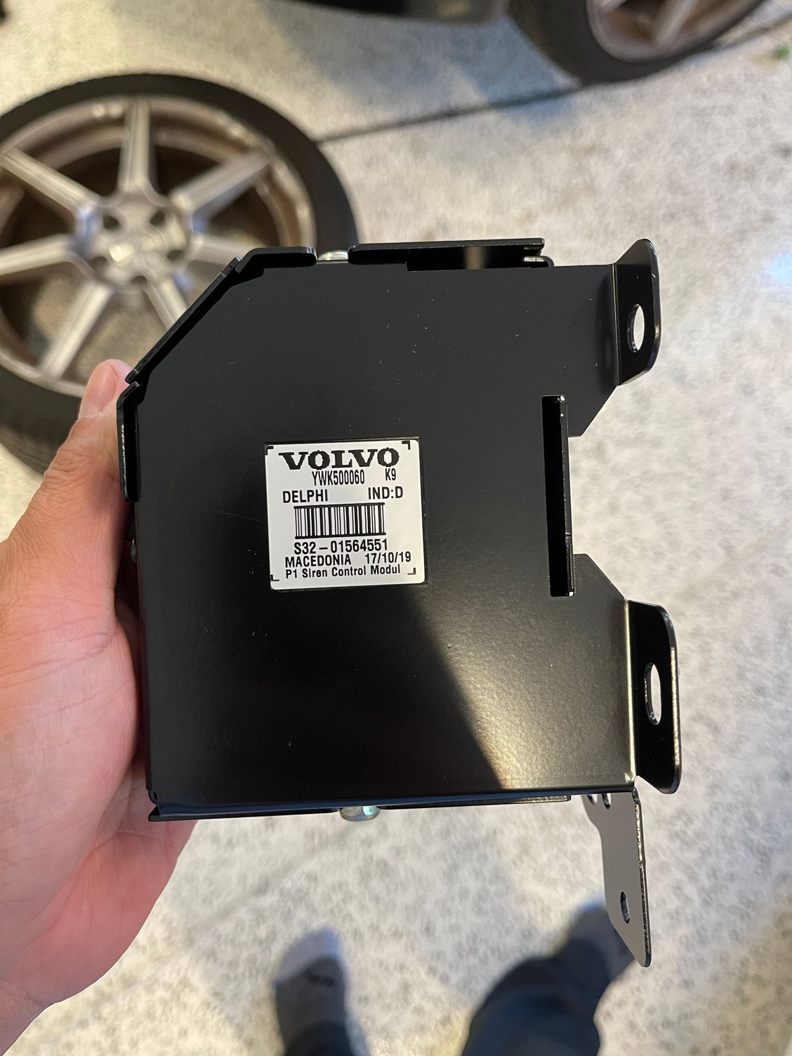

I put this in my 06 v8 vantage low spec alarm. The battery in the original had leaked and damaged the pcb board completely. I don’t remember where I bought it.

I bought the above Volvo unit from Aliexpress for about $80.00
