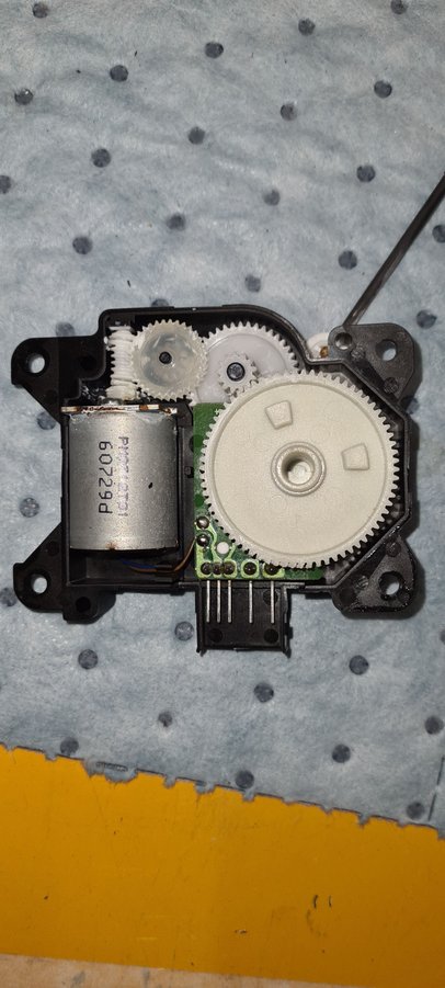

On LH drive cars there are two servo motors down above the throttle pedal towards the center console.
You can stick your head down and look up from the floor and you will se them. The two servos look like half-palm-size black boxes which have an arm with a steel rod linkage.
The top of these two motors is for the mixer valve, ie. it moves a flap to direct the air towards the heater core or just around it.
On my Vantage this servo would stick when it was selecting cool air, and if I gave it a bump with my finger it would move again. I removed this servo and opened it up, there is a small motor with gearing inside aswell as a potentiometer track on the circuit board. When the servo is moving a shoe moves along the track which has variable resistance. This resistance is passed to the HVAC control unit as a position of the servo.
After cleaning the track and giving it careful wipe with some scotchbright (also the shoe ofcourse) I was able to restore this servo to proper function.
If this happens again, try reaching up and give it a nudge. If it moves and the heating starts to work again, you know where the problem is.
Photos of servo:
Complete servo. To remove arm from shaft just push in the litte clip and pull it of. Plastic tabs around the perimiter keeps the lid on, just pry them open. and remove the lid.
Inside servo. The big plastic gear have the shoe and the pcb with the track hidden under it. Try bending the shoe down a bit too to make sure it contacts the track firmly.
