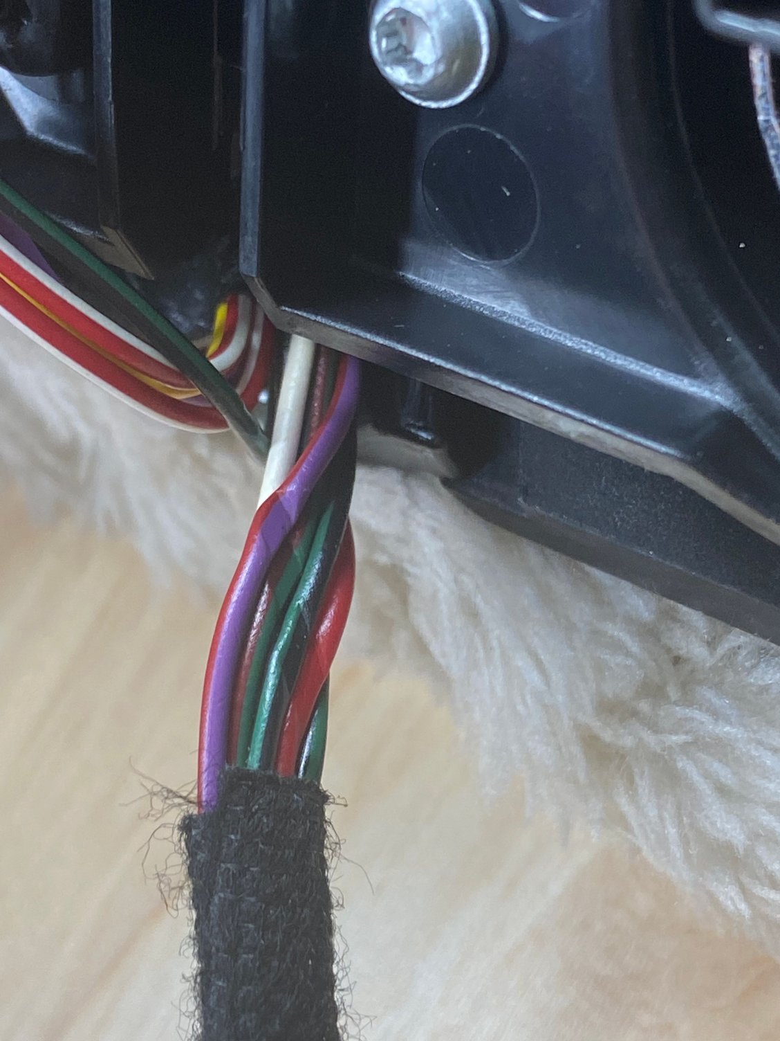

got dash middle console apart. Found crimped wires connecting Start/Stop. Is this the culprit??

If it was purchased very recently…isn’t I covered by the lemon law..clearly not as described..others will know better..mines a first gen..havn’t had the pleasure of driving the new ones…crimped cable may be a contributor…any codes being thrown?.

you could very well be right. might have to splice.
it may have been pinched at the factory unless someone's been monkeying around in the console after it was bought, and may have caused complications that frustrated the previous owner to such an extent that it was sold in short order. (speculation)

Frustrating for sure!
Hard to help from afar, but I was getting random & unrelated errors, all of which stopped when I pushed the wires into the connector. They had backed out slightly under the weight of the loom providing intermittent connectivity. I would follow those wires to where they mate and make sure the harness isn't pulling on the connector(s).

this morning after getting a flat tire (yes, this car is full of luck) I pulled back into the garage and the car shut itself off when I placed it into park. I found that when I wiggle or barely brush the Start/stop button, it would cycle through the on/off positions. Now I need to take it back apart and fix the connection or find a new button.

The part is on order from the UK. Swapping out the faulty Start/Stop switch and with fingers crossed, it works.

But having said all of that. I fixed the issue.
it was a faulty Start/Stop button. Easily swapped out; now everything is perfect.
so I got an Aston Martin Vantage with 1700 miles for only $110,000. Worth the small headache to find the problem and fix myself.
