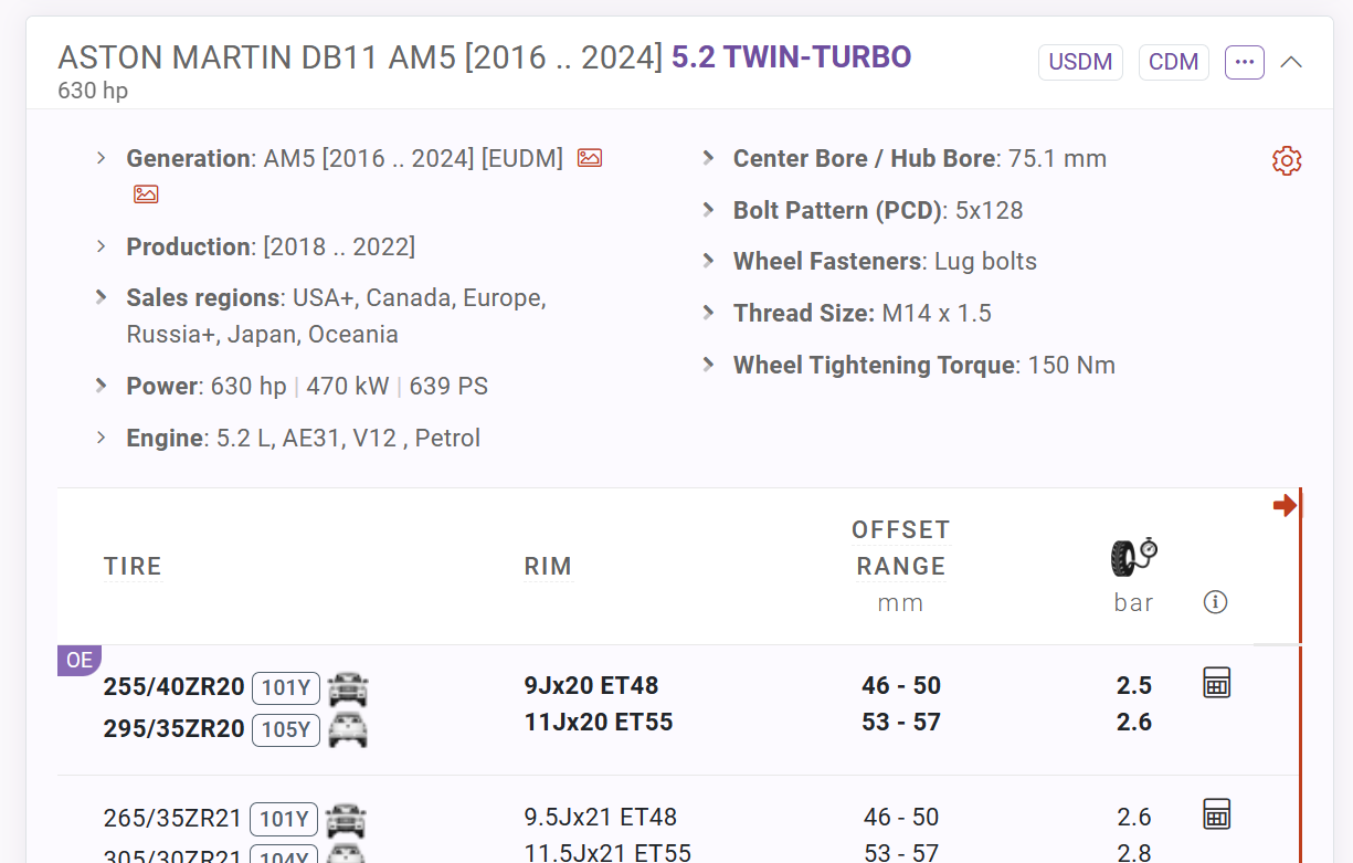

Originally Posted by EJ_Rapide
Thanks for the link!
DB11 wheels are out
The information above (post 5) regarding the DB11 wheel bolt pattern diameter is incorrect. The DB11 uses a 5x128 pattern and a 75mm center bore. This I've verified. I own a DB11 and was looking at wheel spacers. I used info from this site to start, then verified with my actual wheel.
I am only commenting about the wheel bolt pattern dia, and not the offsets.
I do not know if the bolt pattern changes when the V8 is used, but highly doubt that.
Which website is that?
If I may ask?
Thank you.
https://www.wheel-size.com/size/aston-martin/db11/2016/
I am posting this but might get taken down by admin.
Old Nov 16, 2023 | 11:34 AM
EJ_Rapide's Avatar
Joined: Apr 2023
Posts: 624
From: Santa Rosa, CA
Rep Power: 52
EJ_Rapide has a reputation beyond reputeEJ_Rapide has a reputation beyond reputeEJ_Rapide has a reputation beyond reputeEJ_Rapide has a reputation beyond reputeEJ_Rapide has a reputation beyond reputeEJ_Rapide has a reputation beyond reputeEJ_Rapide has a reputation beyond reputeEJ_Rapide has a reputation beyond reputeEJ_Rapide has a reputation beyond reputeEJ_Rapide has a reputation beyond reputeEJ_Rapide has a reputation beyond repute
Seems pretty close!
Seems pretty close!
Very close. The front wheels are a little narrower (8.5" to the 9" used on the DB11). Offsets a little different.
Don't know how it would work out on the Rapide, but on my DB11 I've increased tire sizes from stock
Fronts
Factory 255/40/20 and I went to 275/40/20
Rears
Factory 295/35/20 and I went 315/35/20
