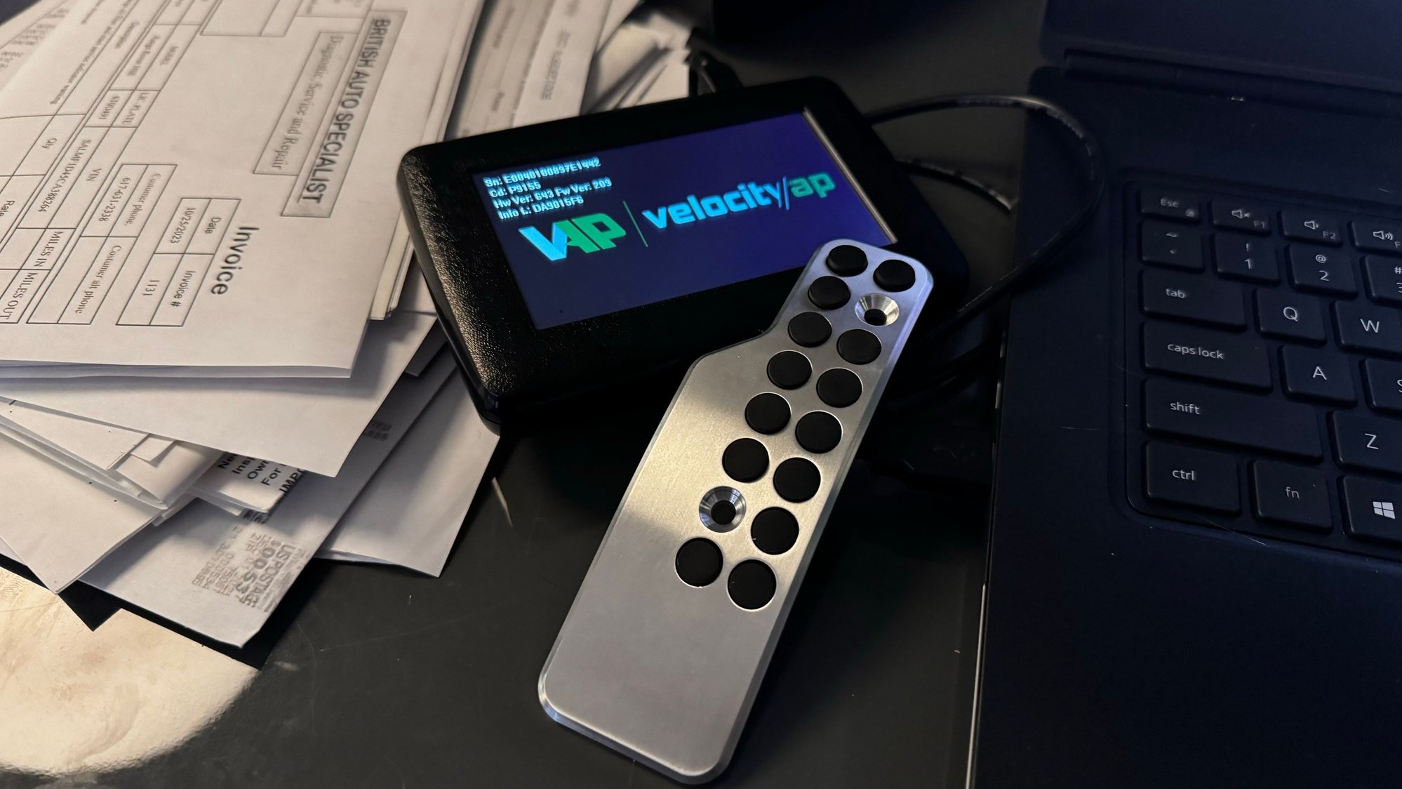

Nuts and bolts: The Vtech controller software was easy to install and use and it was very fast (took less than 10 minutes in both directions) to download the original ECU file and install the new tune. I submitted the original file to VAP on a Friday and had a tune from them by Sunday. That was super-fast turnaround and I would not have minded if VAP wanted to take a weekend off! It is also worth mentioning that part of the cost of the tune includes remaps for future upgrades/modifications. The new tune was so convenient to install that I did it in a parking lot. This was not in the instructions but I decided to "risk it". As far as I can tell there were no repercussions. Note: my misfire corrections were already erased because I had the battery disconnected earlier that week. I have not done the misfire learning procedure yet. Mostly because I live in L.A. and have to wake up super-early in order to find a highway that is empty enough that I can do those 70-20mph coast downs in safely. I will likely do the misfire corrections tomorrow morning or when I get back from holiday travel. I'm not trying to be lazy with the car. I read Aston1936's nightmare experience of finding out that his car hadn't done a misfire procedure under previous ownership. I'm not trying to be part of the problem.

Best Black Friday purchase
