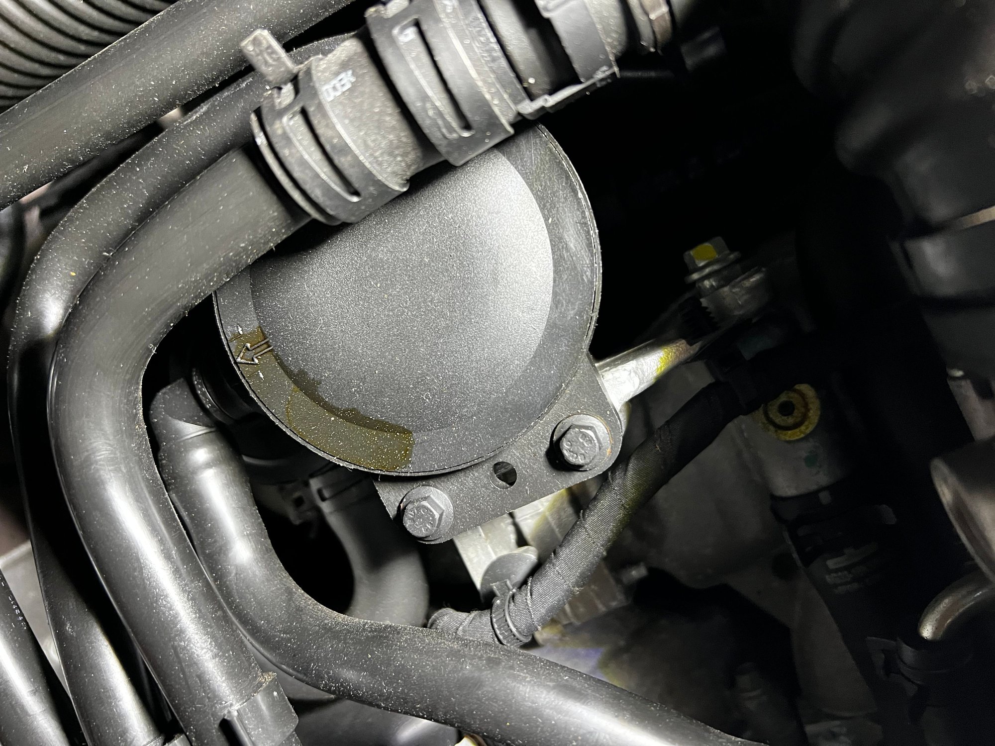

Ok - here is a pic of the Motorcraft --- Call me crazy BUT the two don't really look alike. What am I missing ?
This is my PCV valve (note small oil leak on LL quadrant)

That's an AOS which is around $60.

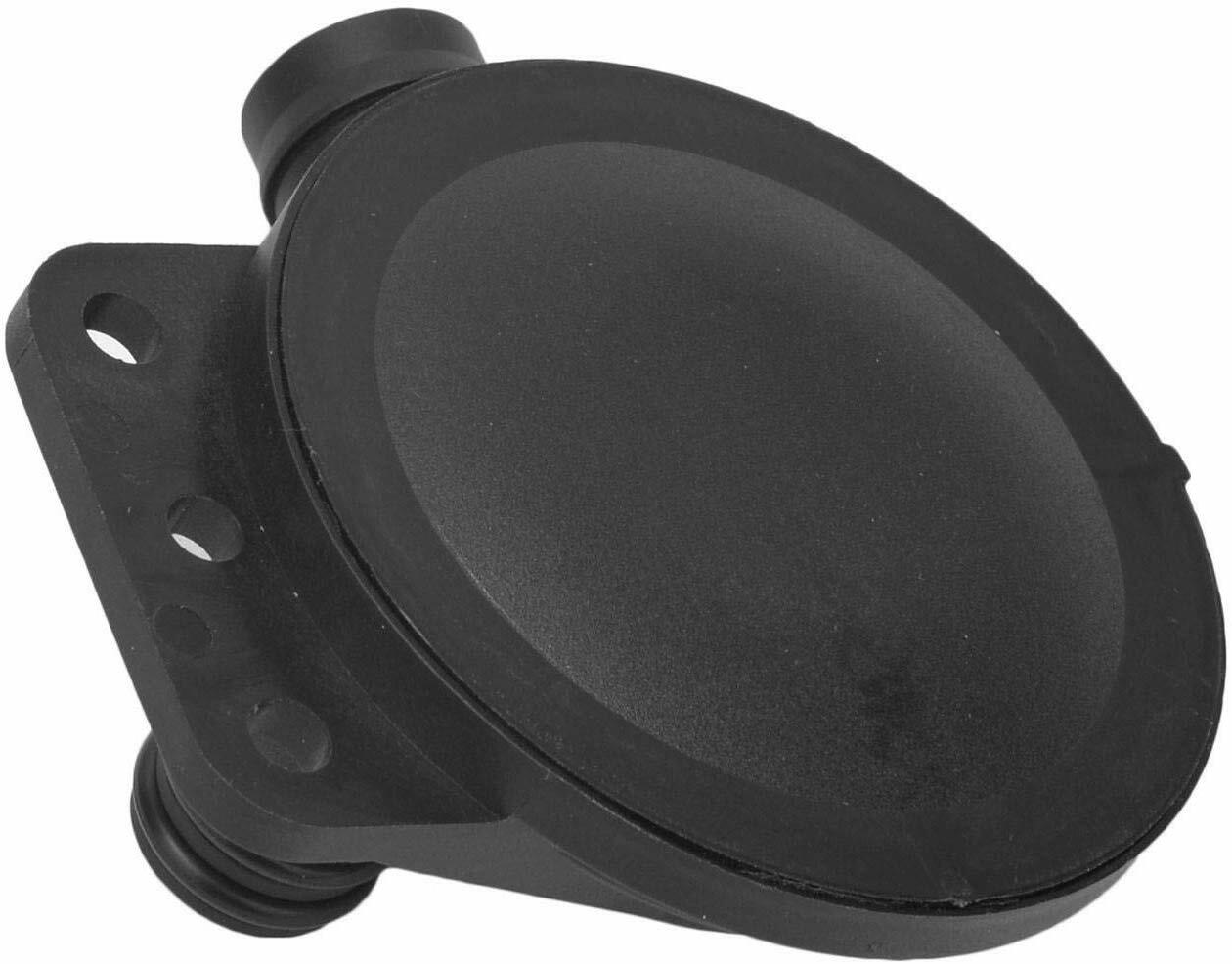

This one is on ebay for 99bucks -but is for the 4.3 V8.....here is my QUESTION - will it fit the 4.7L motor? It appears that it will but I am not a Tech by any description. Thanks All!

Never mind - it WILL fit (same part # ---duh)
;-). don't I feel silly--

The PCV valve you show is the one for the V8, it is used in range rovers. Atlantic British carry them for about $70; I believe the motocraft one is for the V12. I ordered one to replace mine as it was starting to buzz but the replacement made such a horrible noise I put the original back on and have ordered one along with the air oils separater from scuderia. Hopefully that one is better.

They are the same on 4.3 and 4.7 dealer list price is $61 even if they mark it up it should be less than $100.

Just searched part number and ML performance has it for $51.
