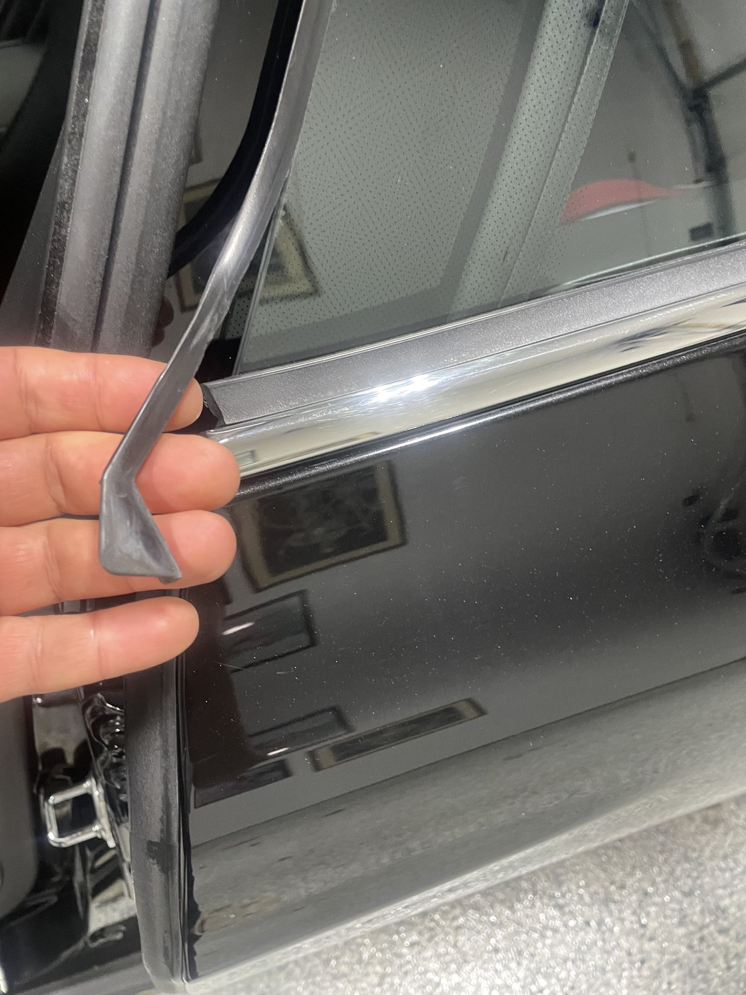

Question How to Repair?
The weather-stripping piece on passenger window is coming loose. How do I repair this? Can it be glued or do I need a new window?

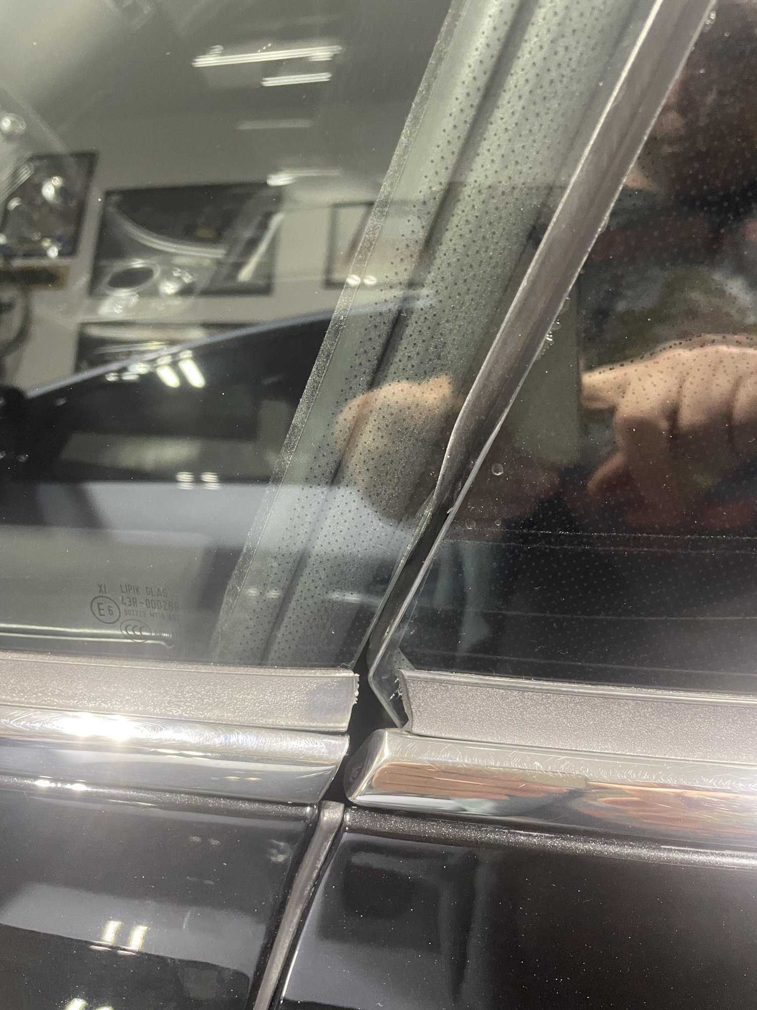

Hard to tell from your pic. Are you referring to that twisted section? Has it separated from the pillar?

Here's an additional picture

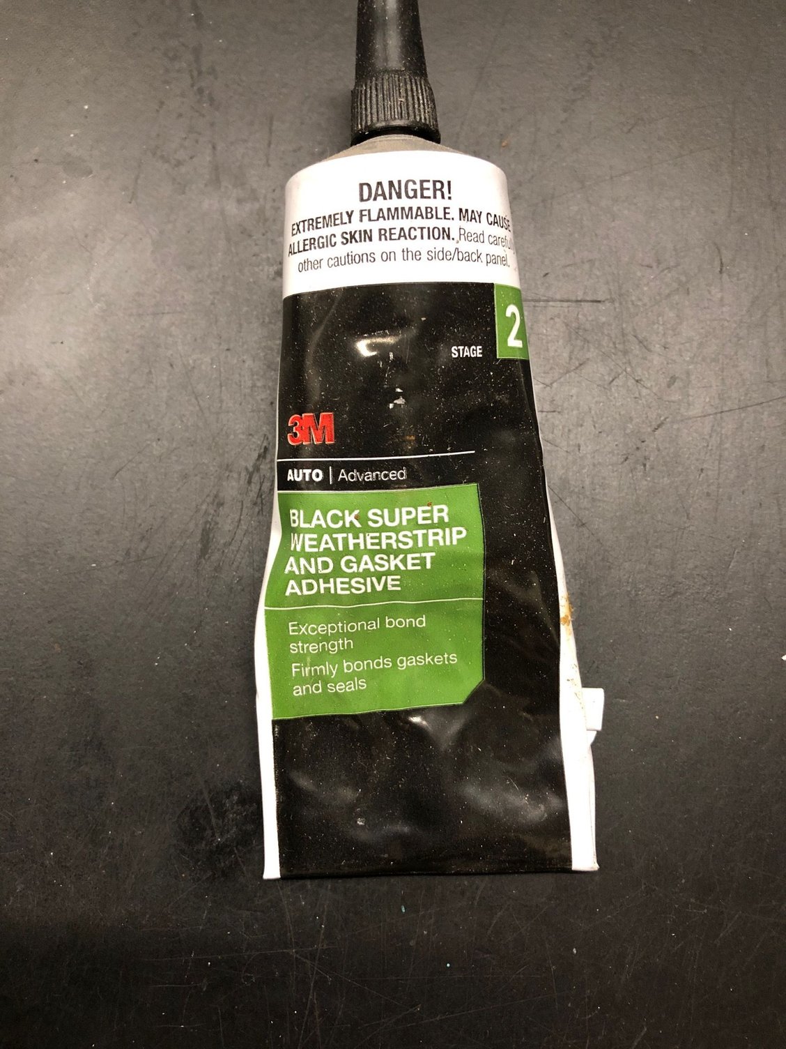

Glue it back on man….3m trim adhesive
Good advice!
I've done a few of these (not AMs). This is not the first tube I've purchased.

Originally Posted by BWings
Good advice!
Thanks, will take a look at the local parts stores for this!
Just some friendly advice - this material is VERY sticky and it can get out of control. It is difficult to clean up if it gets where you didn't want it.
If you place a bead on a strip and press it down, the bead will spread, of course. So, don't overdo it thinking it needs lots of adhesive. It's worth taking your time, plan it out before you start applying the material.
All the Best with it...
EDIT - Almost forgot. Clean both surfaces with rubbing alcohol first making sure the surfaces have no dirt or film; let the alcohol evaporate, usually a couple of minutes at least, before you apply the adhesive.
