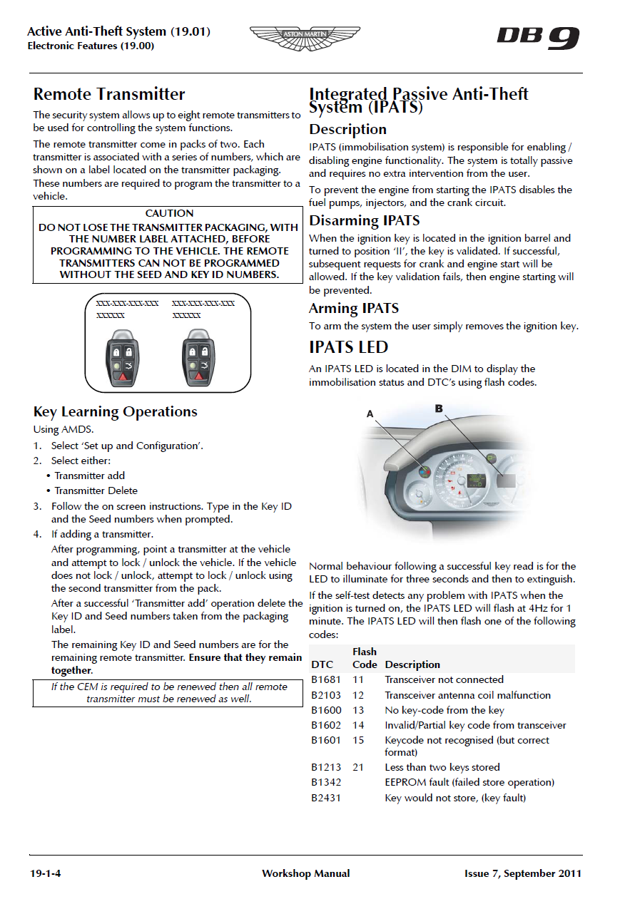

Yes I'm aware of that but how do I know if the ignition part of my key is accepted by the car's various modules?
Francis
Old Jan 18, 2025 | 09:41 AM
GA_DB9's Avatar
5 Year Member
Joined: Aug 2017
Posts: 276
From: Alpharetta, GA
Rep Power: 71
GA_DB9 Is a GOD !GA_DB9 Is a GOD !GA_DB9 Is a GOD !GA_DB9 Is a GOD !GA_DB9 Is a GOD !GA_DB9 Is a GOD !GA_DB9 Is a GOD !GA_DB9 Is a GOD !GA_DB9 Is a GOD !GA_DB9 Is a GOD !GA_DB9 Is a GOD !
There's a red LED in the instrument cluster that should show you whether the PATS system in the car is happy or not. To program the remote transmitter you'll need to have the original plastic box with the seed codes. Otherwise they're of no use and you will need to obtain new fobs. That's separate from starting the car which requires a separate chip in the key to be paired with the car's PATS system.

So the PATS goes on as soon as the key is removed from the receptacle in the dash. The led on the clusters left's side will start a slowblink.
I will know the key is recognized once the key is back in the receptacle and the blinking red led stops blinking. At the point the PATS is allowing ignition, is that correct?
Because if that's the case, I'm in. The car is not electronically blocking the ignition on the motor. Right?
