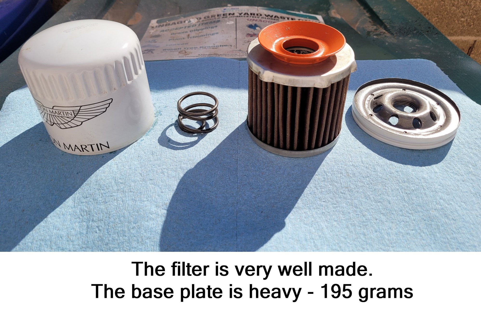

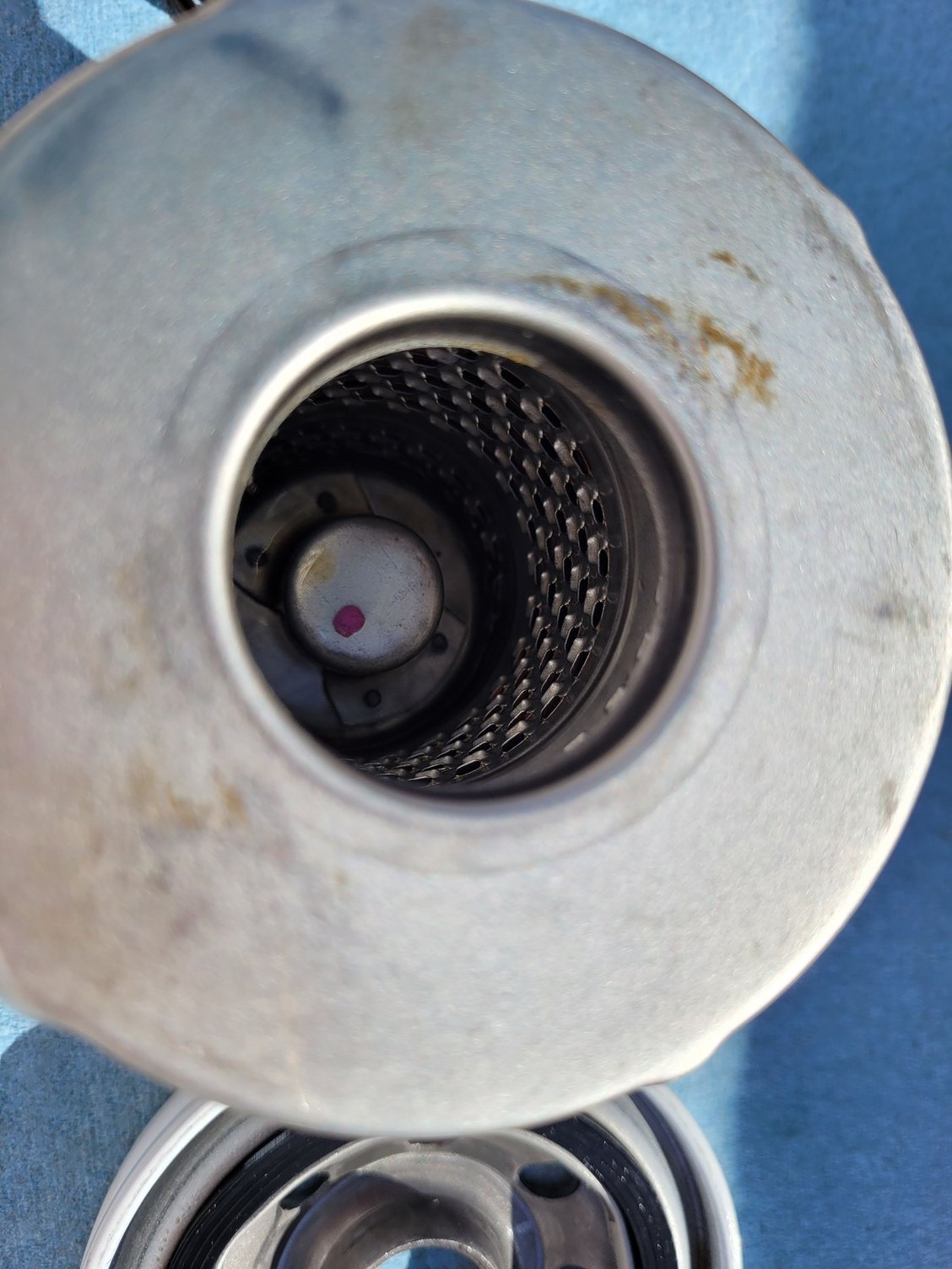

Also i bought an oil filter cutter and opened up this years used filter and it looked great as well.

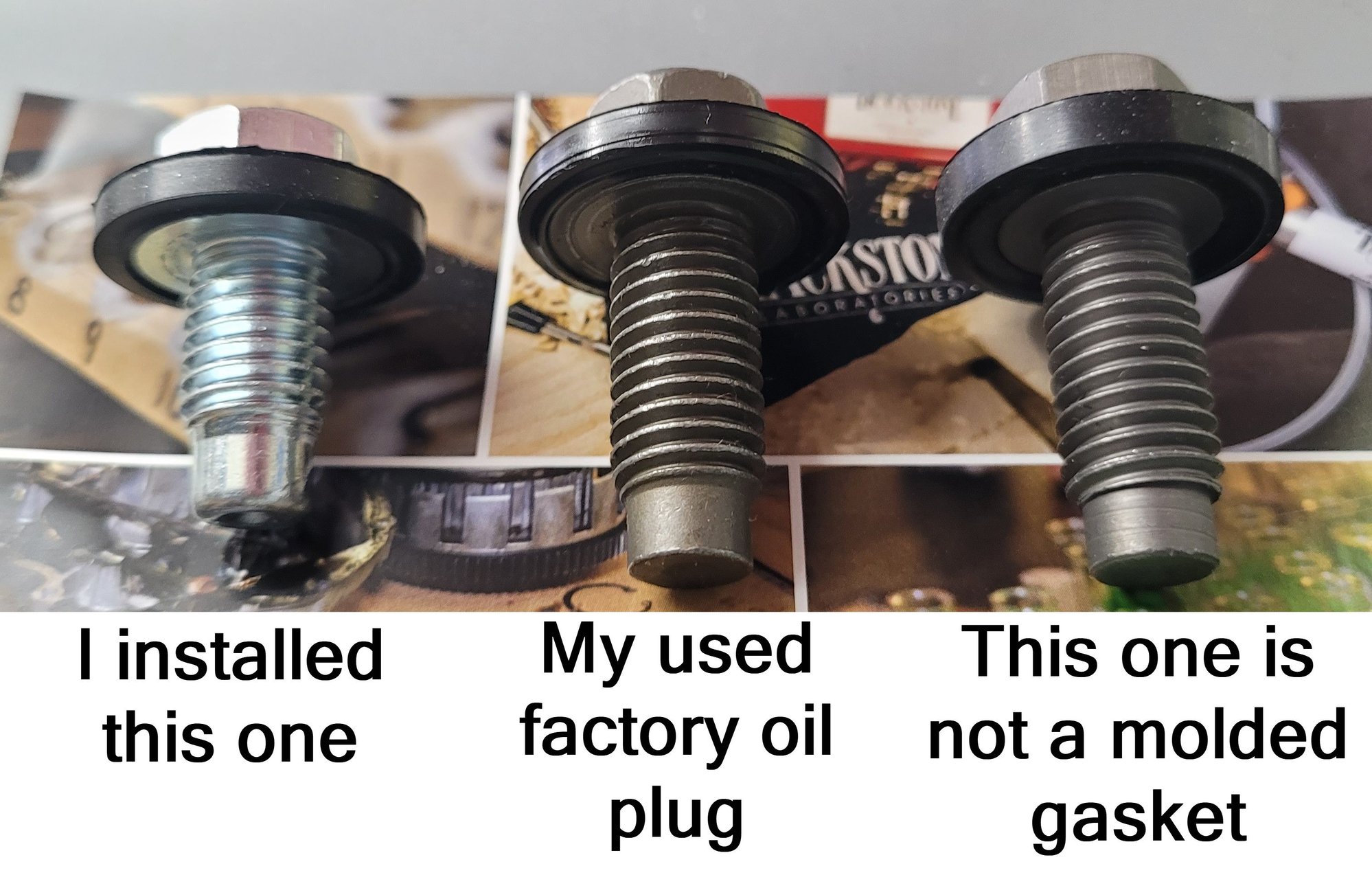

Plus i used an aftermarket oil drain plug that cost me $2.75
It has a molded rubber gasket just like the AM one, will see how it does.

Which drain plug did you get?

The silver one is a Dorman 090-059.1 (the .1 means 1 unit)
The best price is at O'Reilly's Auto Parts, it went up to $2.99 now.
The non-molded one (slip on gasket) is a Dorman 090-153.1 its around $5.50

Thanks!
