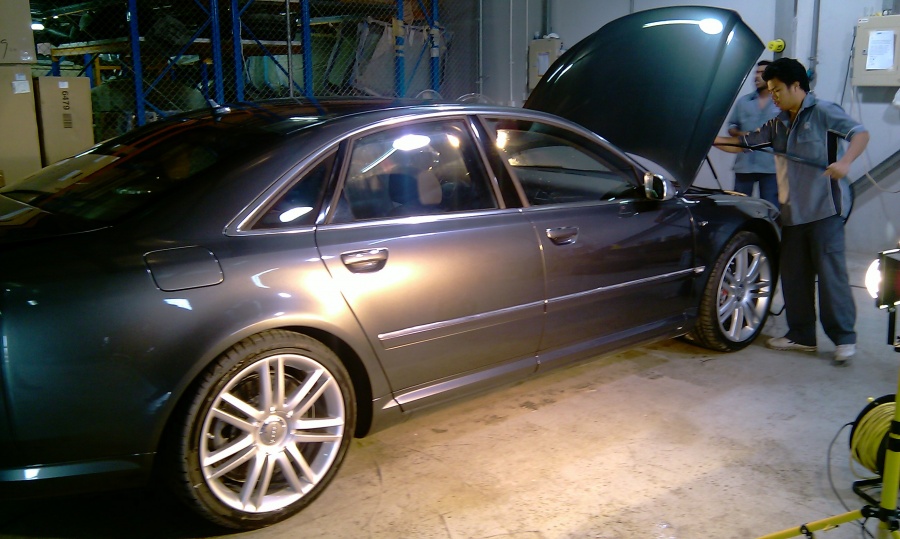

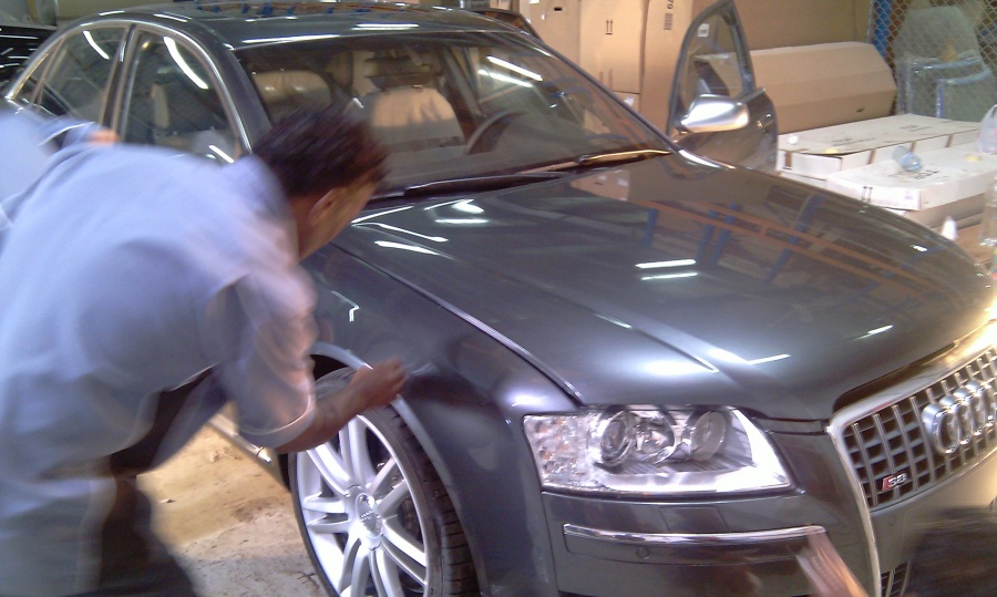

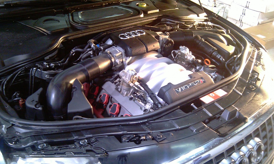

I went to the workshop this morning to look at the car. It was being polished waxed after two days of testing. I saw the reports and the car had no electrical or mechanical faults reported, but the battery had to be replaced.
I have asked for the tyres to be changed, but they look good with no flat points apparent because they used to drive the car around the parking lot just to rotate the wheels.
I took a couple of pictures of the car after the wash and before the polishing

There is something which doesn't look quite right -
It looks like it has ceramic brakes on the front - but conventional steels on the rear. The S8 ceramic brake option included ceramics on all four wheels!
