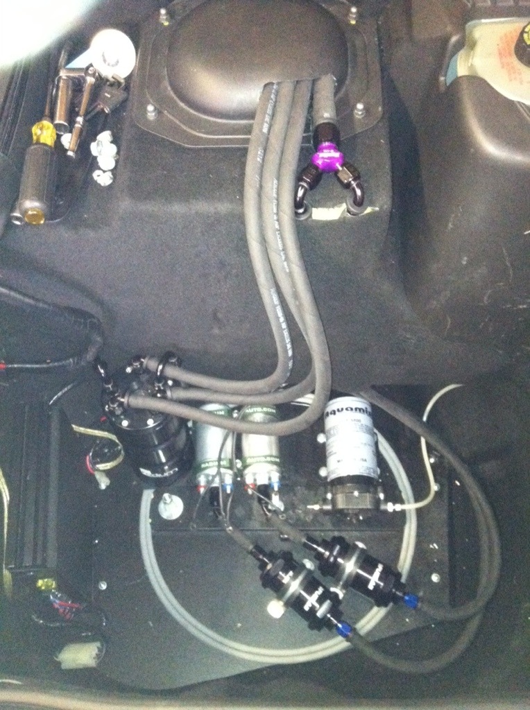

Before I go into teh details, I want to thank my friends Tim (Tim941NYC) and Binh (m3ntal) for all the help with the fuel system project as well as Mike @ T3 for helping source source FueLab stuff. Tim is a beast and can make anything happen when it comes to PCars. Without him this wouldn't have happened and Binh did all the research on surge tanks and found what I feel like the nicest surgetank setup on the market. I in turn designed the system and got together with the guys at Fuel Injector Clinic to supply us with some awesome high impedence 2150cc injectors with plug and play wiring adapters. Tony @ EPL is working his magic on the tuning end of things.

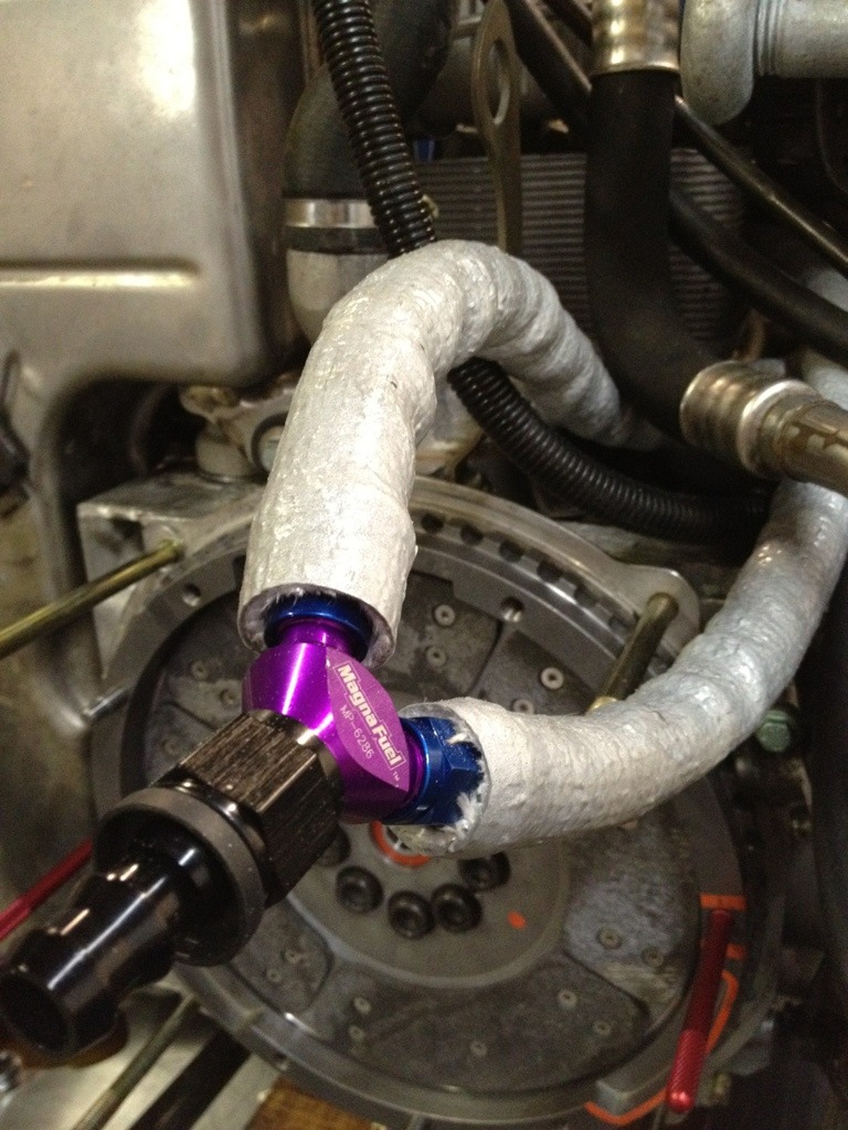

On to the good stuff. Here is a short rundown of how the system works. Stock intank pump remains intact and feeds the surge tank, from there the 2 Bosch 044s pickup and push through two FueLab fuel filter and join into a -8 AN line that runs to the back. Here is where we made a lot of changes and improvements. Stock 996tt fuel system feeds one rail through the other which will inevitably cause unequal distribution and pressure between injectors, especially the last one. We split out -8 AN line into two -6 AN and fed each rail separately, each rail has a return to a FueLab FPR. To do this we used two driver side rails and some custom welded fittings. From the FPR we ran a -6 AN line back to teh surge tank to keep it full and another vent/overflow line back to the stock location in the stock tank.
This can do pump, race gas or E85 safely. Hose is NHRA approved pushlock Aeroquip hose with fire jacket protection.

Install Pics..

Its a good setup we ran it on Chris's car for over a year, only problem we had was when one of the 044 went out. We never knew till we were making runs and the car kept going lean on Highboost. After that we installed a fuel pressure gauge, the gauge would show a higher pressure when both fuel pumps were working so we knew.
