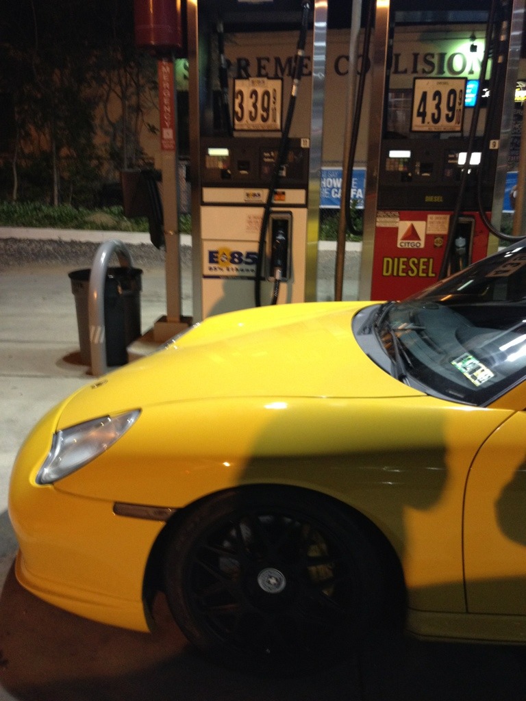

Truth be told I may go the same way as Mark and M3ntal and run E85. I am sold on your product after installing and seeing a smooth idle on a remote flash base tune. First try!
That and the fact you have 7 E85 stations within 10 miles and its 3.39/gal by you !!! I have 1
We'll see what it does soon enough I guess?
