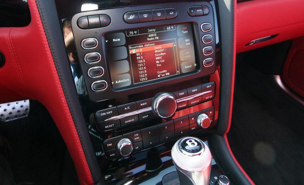

Just installed my bluetooh/ipod kit. Very cool to be able to stream music via 3G on my iphone.
For those who is looking to install, be sure to get the removal key when you order:
iPod & iphone integration for music
Here is what I have been using. I am able to control volume from steering wheel. I control music from my iPod or iPad over Bluetooth. No wires. Device connects to Bluetooth automatically when I get in the car. On occasion I have to connect to Bluetooth device, but 98% of the time it connects automatically. Sound quality is decent for what it is being used for.
Control Unit
DICE i-Audi-R-5v iPod Integration Kit for Audi, Bentley and Lamborghini
Amazon.com: DICE Electronics DUO-103-AVW Dice Audi/VW Silverline DUO- Factory SAT Connection: MP3 Players & Accessories
Bluetooth Adapter (I tested a few, and in my opinion this one works the best)
Amazon.com: CableJive Wireless Bluetooth Music Receiver Adapter for Bose SoundDock, and other iPod and iPhone Audio Docks including iHome, Bose SoundDock, JBL, Logitech, Sony and other 30-Pin Audio Docks for Wireless music. Connect dockBoss air adapter to your speaker dock and control your music from your phone up to 30 ft. away.: MP3 Players & Accessories
This configuration works well.
Only issue I ran into was when using my iPhone 5 for both Bluetooth Hands free which connects to the Stock Bluetooth adapter in the car, and simultaneously connecting to the BossAir adapter, (Yes they do work and connect simultaneously) that when I made or received phone calls, the call was not clear, and seemed broken. I resolved this by dedicating a iPod for music, and my iphone for calls. this configuration works perfectly. I keep the ipod on the ledge next to my battery charger, so when I am charging the car battery, the ipod is charging as well.
Hope this helps. Let me know if you have any questions.

Here is the one I'm using for 2004. You can use the selector to choose the correct model for your year.
I'm able to control volume and change track of 3G music streaming app using the steering wheel button. Bluetooth works fine for streaming. I prefer the wired connection though because it charges my phone as well.

The problem lies in the Bentley system itself that takes over 5 seconds to boot up once it has power and THEN you can choose track/discs on the CD payer mode.
Here is a workaround: Hook up a switch that controls the power delivery to the Dice. Anytime the Dice does not behave well with inputs, just switch the power off to the Dice unit when the car is running. Then turn the Dice power back on so then you can choose inputs for the first 5 seconds.
Awkward? Yes. Does it work? Yes.
