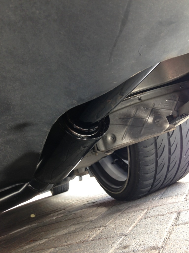

so tacked up a muffler by pass, went for a quick drive. did not like it. too much drone and too sloppy sounding.
added the stock resonator that we cut out, back in but in place the of the mufflers, they are small resonators.sounds good now. happy with it. slight drone at 1500 rpm. but sounds amazing at full throttle. screams like it should have from the factory

If you look at the pic you can see how the 3" xpipe Mates to the stock piping it slid right over it pretty tight,
I kept the stock size piping in the rear section

here is my secret muffler lol

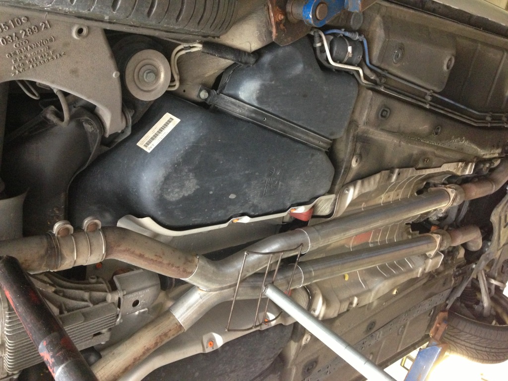

yup, this exhaust is not for everybody but it works for me. I am handy and dont mind multiple visits on a hoist to tune in the right sound that works for me.
If I did it again I will just fab up a stainless 3" front to back, but people also dont realize that the down tubes from the upstream cats are small and same with the flex pipe. If I had to re do it I would cut that off and start off new from there, 3" flex into a collector.
just like these guys did

dont do a full x pipe cross, do a merge like how I did and keep the x closer up front to the collectors
