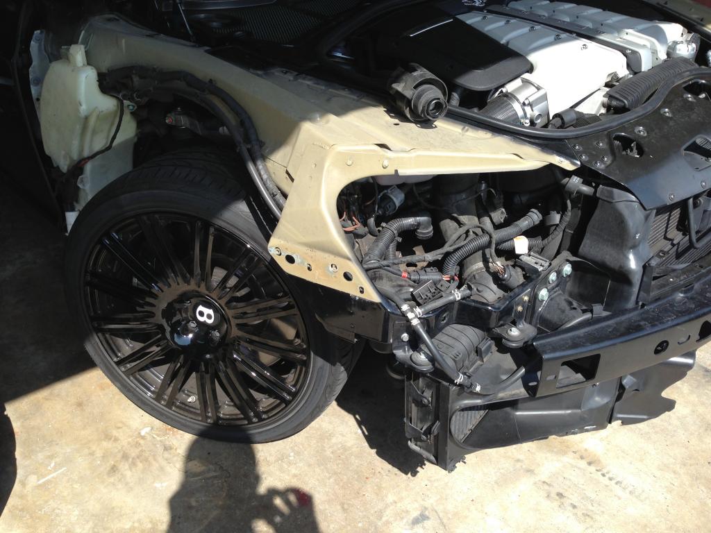

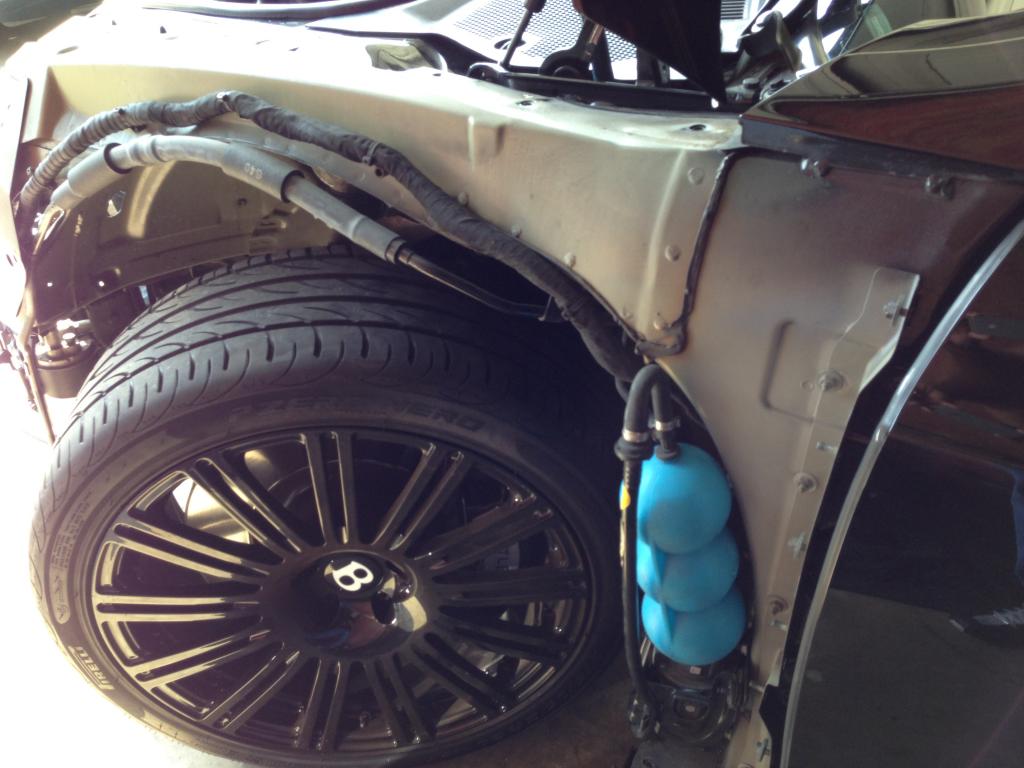

Originally Posted by silentspeed
I have the LHD 05 CGT, I have read what I can on the location of both washer pumps. How do I get to them to confirm why they have no pressure? Anyone have thoughts or pictures? The diagrams I have seen have part numbers and a general layout but not of any help.
Here are a few pics for reference....Hope this helps.
[IMG][/IMG]
[IMG][/IMG]
[IMG][/IMG]
[IMG][/IMG]
Excellent, thank you.
